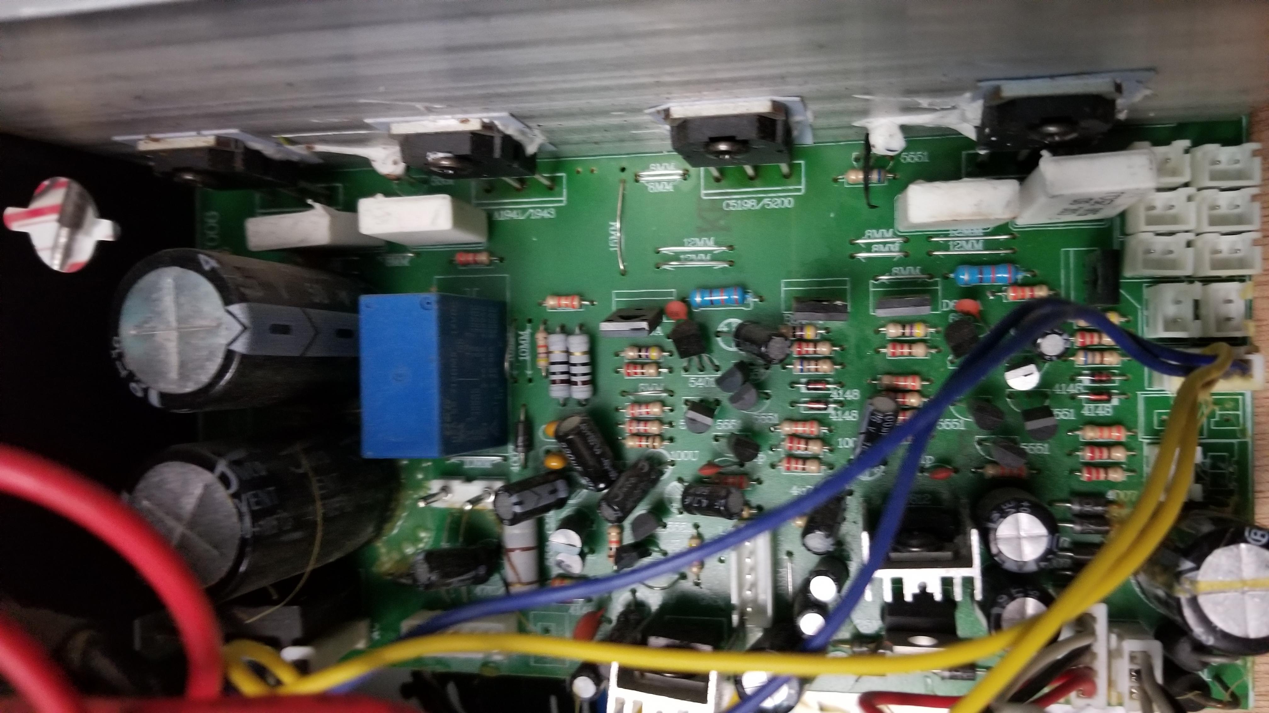

I found a karaoke DJ stand it was in pretty bad shape the board that control the volume and was able to change it to aux bluetooth and radio, also the low mid and highs broke. So I checked for the power supply and circuit and it looks in good condition. So what I wanted help was, am I able to connect and aux and speakers straight to it with out the control board?

Is there anything you can lose by trying to find a spot on the board where line IN could be and feed it with small voltage (0.1Vrms) 1 kHz sine wave (mp3) from a phone or some other sound source where you can set the volume? If all is ok, then at speaker output you would measure with a multimeter (set to Vac) an amplified signal (perhaps 20 times larger in amplitude). Make sure your amp has no dc voltage on the output before you decide to connect any speakers to it. You don't want to fry any.
Sorry I'm not good on all this but is there a video or what can I search for what you are referring for me to do. Or if you could try to explain a bit more. Thank you so much for trying to help.🙂

Hello I been looking at the board and I thing I found the speaker out put but I also found some letter in the board where connection goes by your experience or anybody body else reading this, would the audio in could be V G R L G +Bor theres another one -12v +12 V R GND
Sorry, you will have to find someone else to figure this out.
