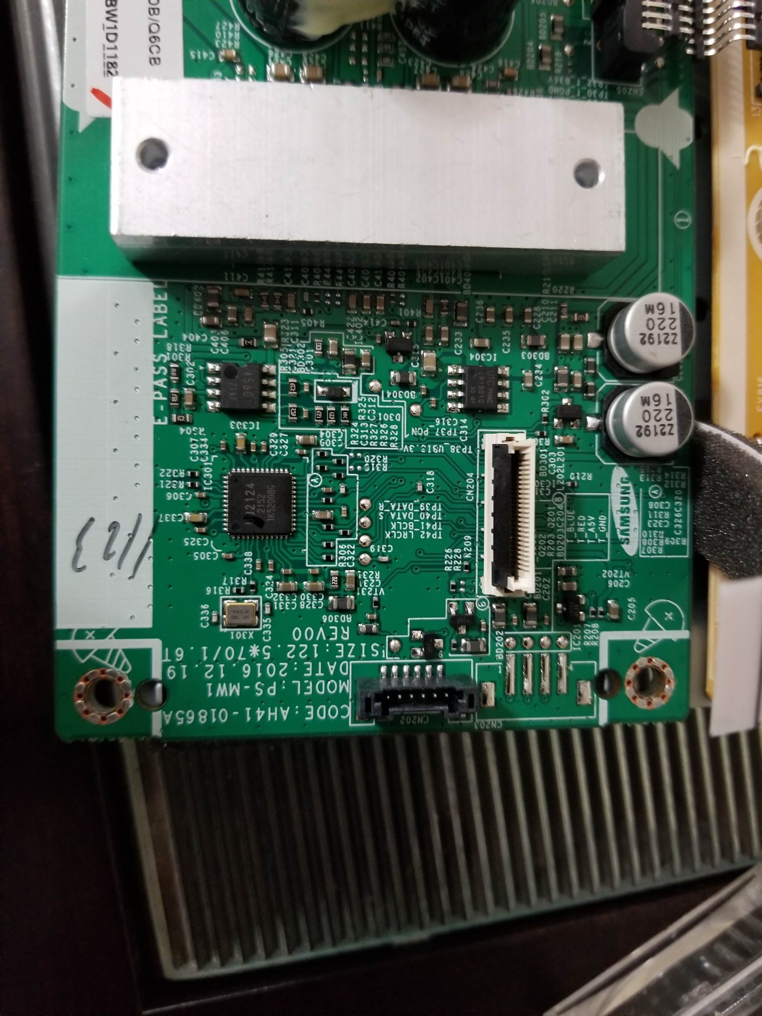

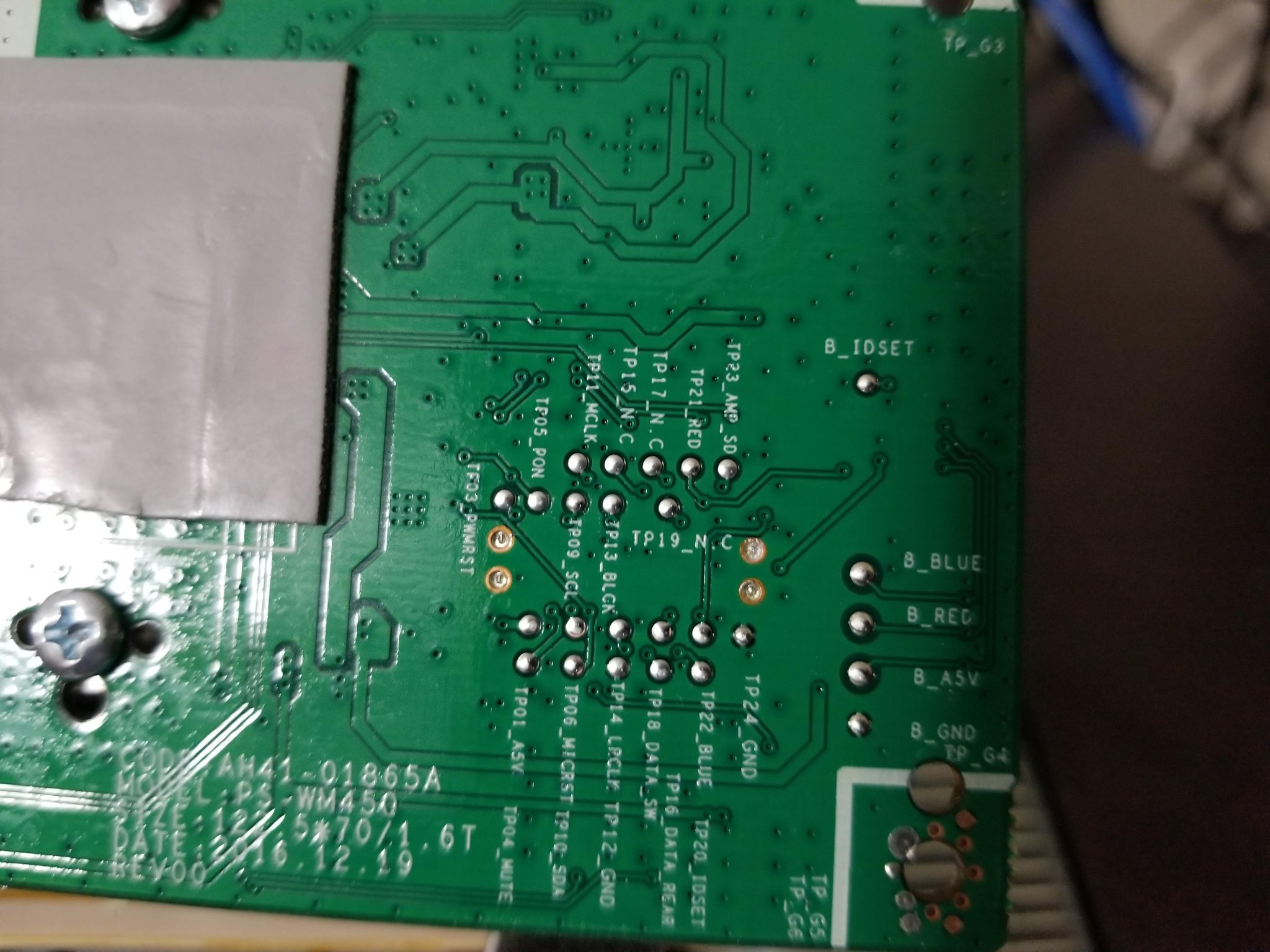

Hi everyone, I have a samsung wireless sub that I'm trying to re-purpose and add a 3.5mm jack to. The problem I'm running into is that the wireless chip seems to only have options for digital in for something like usb. The wireless chip on the sub is the WSM520V. I've included photos of the board the chip connects to and if anyone has any suggestions on where I could insert a analog line in connection I would really appreciate them.
Thanks!
Thanks!
If you want to add an 3.5mm analog input, maybe you should track where is the power amp input instead.
IMO that SW module uses the TI Pure-Path D-amp TAS5614LA (mentioned in list of chips on https://vi.aliexpress.com/i/4000853505520.html?gatewayAdapt=glo2vnm ) which has only digital input.
OK thanks everyone for the help! So it looks like there is no easy way to tap this. Will look into re-purposing some other way then.
