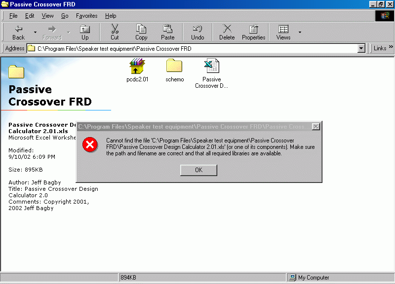

I realize this is a computer question, but it is about a program to aid in loudspeaker building, so here goes.
I keep on trying to download Passive Crossover FRD. I know that RAM is a little low, but it ususally gets me around the net.
I download the program and put it in it's own folder in a folder named Speaker Test Equipment, which is located in Program Files. It unzips. Every time I try to run the program I get the message illustrated below.
Should I use WinZip, (which I hate?). The program mentions that as an unzipper. Other wise, what am I doing wrong?
Oh yeah, I cleaned out Temporary Internet Files in the Windows folder, which sometimes helps. No help this time, though.
Computer mavens from around the globe: HELP!!

To be more exactly - it is an UPX packed self extracting RAR packed file 😉
Its size should be 915.968kb (The Excel file)
To me it looks more like your Excel version is too old - you need Excel 97 at least.

Yep, you'll need Excel 97 at least, preferably Excel 2k.

As it turns out, I do have Excel 97, but it is with Ofice 95, or something.

Yup that error means that your excell version is not up to par, either the current version is corrupted and needs to be reinstalled or the XO spreadsheet will not work with the version you got.

who needs Office97 anyway?
With your low PC horsepower this may not help you but it could help others who have simular issues.
Go download OpenOffice.org. Its free, powerful, and opens/edits/saves almost all documents (ie. Exel, Word, Lotus, ect, ect.) Oh yeah...did I mention its FREE.

This .xls doc is password protected. I guess so you can't change any of his formulas. OpenOffice.org will not(cannot) open password protected .xls docs. Micro$oft will not give out the info to use this feature. Hopfully this latest judgement will force them to releace the info so we can view these documents without buying Micro$oft Orifice.
BTW OpenOffice uses XML as its native file format, so to view any of the documents (wordprocessor/spredsheets/charts/ect.) all you need is a web browser that can do XML. Of course, to edit you will need OOo.
If someone would open the .xls in Exhell and export as an older .xls or other (non-micro$oft) format and post it, mayby kelticwizard, or anyone else for that matter, could open the document.

Thanks for the help, Planet 10. However, the program still won't operate for me. Invalid file type, or something.
