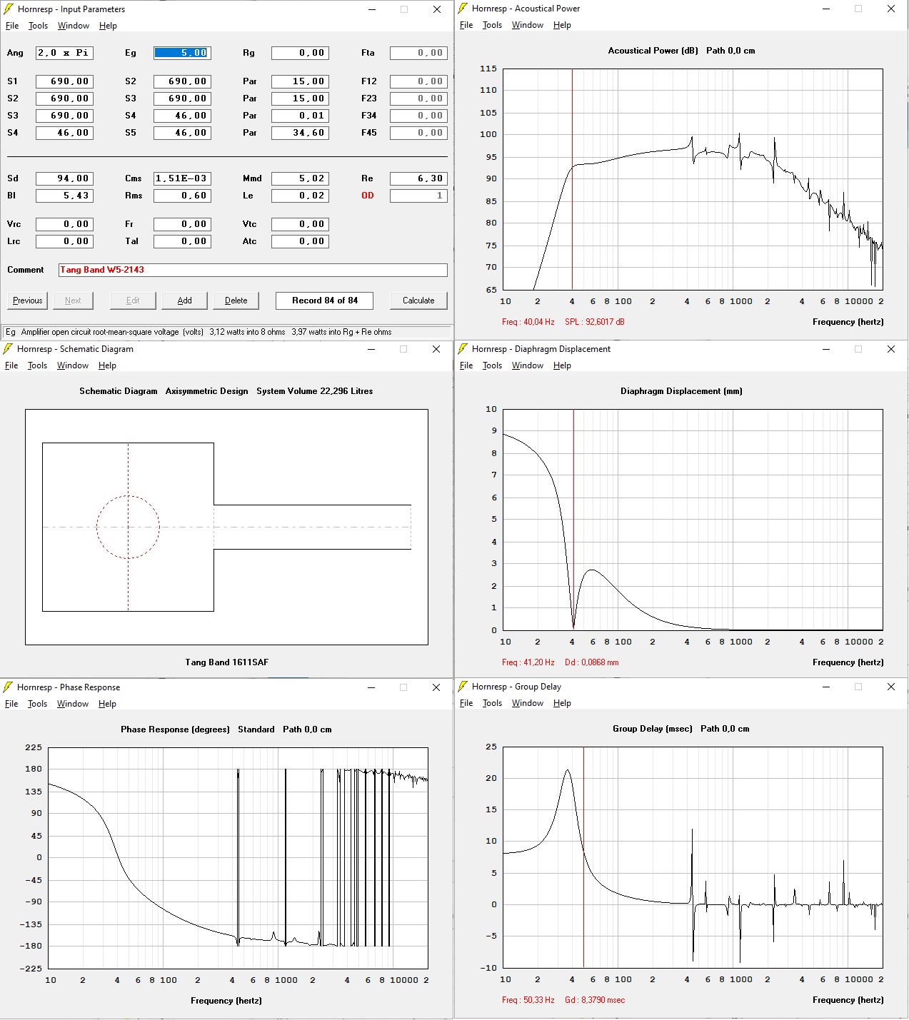

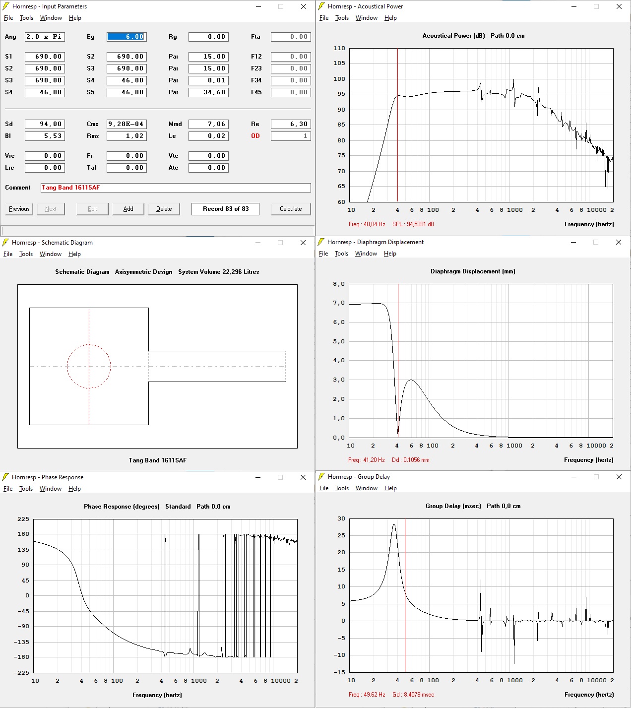

I had a good experience making a Voigt pipe for the Tang Band 1611SA, and the SAF is 57$ each. Doesn't have to be a voigt pipe, any other vented design can be adapted to give similar performance.
Tang Band W5-1611SAF 5" Full Range Speaker
But the Mark Audio 10.3 fits the budget though a bit more expensive, and should have more fitting specs IE relatively loud sans room gain.
The Tang Band W5-2143 should also be considered at 60$ each.
I really hate accounting for room gain, it should be avoided, so here are some sims that fill your requirements with all of these drivers.
