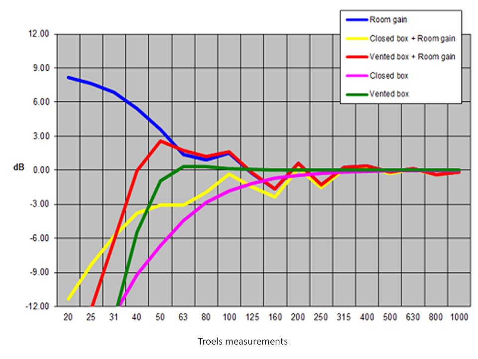

Remember, it has been proven satellite + sub separated woofers can be physically located if crossed over 80Hz(THX standard), and a 60Hz crossover is desirable for superior integration. A well executed 3-way box offers the best sound in the smallest physical volume with the lowest total cost.

-Ported:
0.6ft^3 = F3 =48Hz
0.7ft^3 = F3 =45Hz
0.8ft^3 = F3 =42Hz
1.0ft^3 = F3 =38Hz
43“ tall MLTL~35Hz
-Sealed 0.5cuft F3=70Hz
-use with your 12" ported woofer for 3-way.

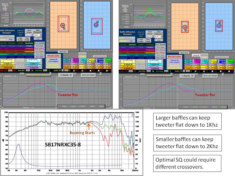

The design on Troels' site you reference uses the SB26, no? What does changing the tweeter do to the design? Based on my discussions with him, one cannot simply mix and match design components like that, even if XO points are similar between projects.
Both are excellent tweeters. Each is used in several SB Acoustics designs.
Designs with ~ 1.6kHz - 1.7kHz crossovers sometime favor the lower frequency extension and lower distortion of the SB29RDC-4.
Designs with ~ 1.8kHz-2kHz crossovers sometime favor the lower cost and tigher polar pattern from the smaller diameter SB26STC-4.
Cabinet design and baffle layout can also affect selection decisions.
MTM designs often favor the higher efficiency of the SB29RDC-4.
