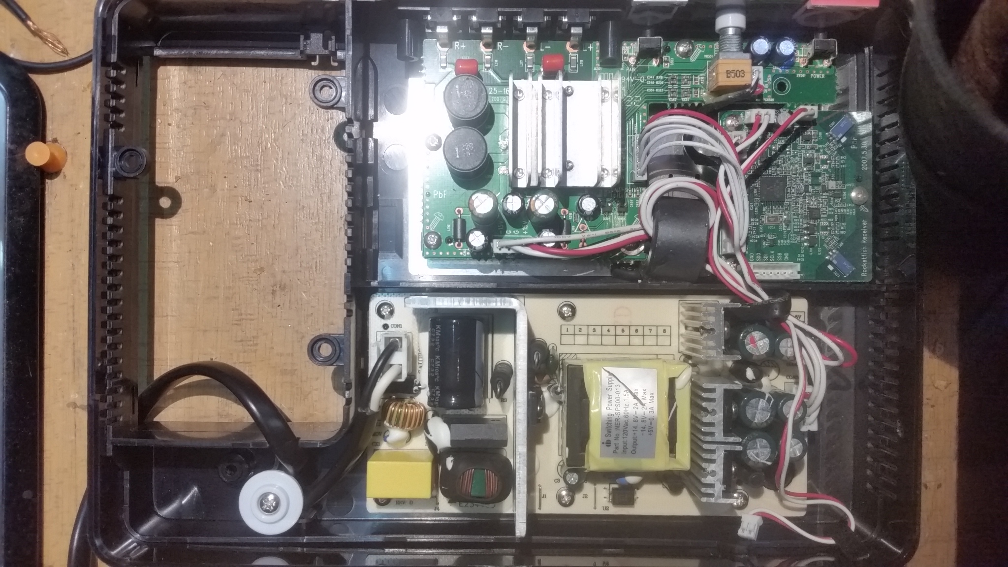

I like my music loud, and I like it to be everywhere, so I actually want to (wirelessly) supplement all of this by adding 2 more speakers on the other end of the shop. (I'm going to build these using Bose cubes paired to the (2) 5 1/4" subs and passive x-overs out of an Advent Mini II subwoofer, all of which I already have.) I don't want to take the easy route on the wireless though, (that doesn't teach me anything), and I'd prefer to hack something else that I recently acquired...
I picked up a Rocketfish RF-WHTIB wireless receiver/amplifier from Goodwill for only a few bucks (like $3 and change...). The internal stereo amp is (apparently) an honest 25w/ch, it has it's own volume control, and seems like a good candidate to power a couple more bookshelf speakers. I don't have the transmitter though, so it's basically unusable at the moment. I'd like to get a wireless signal into it, but don't know how.
Fortunately, the wireless module in the Rocketfish is a separate component and not integrated into the other circuit boards. (Seems this should make it significantly easier...) Here's a pic:
Down in the lower right-hand corner you'll see the wireless receiver. I'm assuming that I can remove this and somehow replace it with a different one, but what I don't know is:
1) what transmitter/receiver module type to buy
2) how I'd go about integrating them
3) With Rocketfish volume viewed as "gain", will the (new DROK) master volume ultimately control it's output?
Plus, I don't know how to integrate a new corresponding transmitter into the existing FrankenStereo on the other end of the shop.
And, just to make it a little more challenging, of course I'd also like to add another subwoofer at the far end of the shop as well. (Still hunting for those components though...)
But how? A second wireless receiver, I'm assuming? Also linked to the same transmitter? (Can they do that??)
Sooooooo...... umm.... HELP?!?!?! hahaha
When all of this ridiculousness is done and working, I'm going to accentuate the absurdity of it all by building some kind of cool enclosure, recessed into the wall, for all of the electronic componentry. lt'll include an older notebook acting as media server / internet access point. hehehe
Because I don't have enough other things to do...!!
Thank you for taking the time to read all of this and for any advice you can offer. It's appreciated!!
