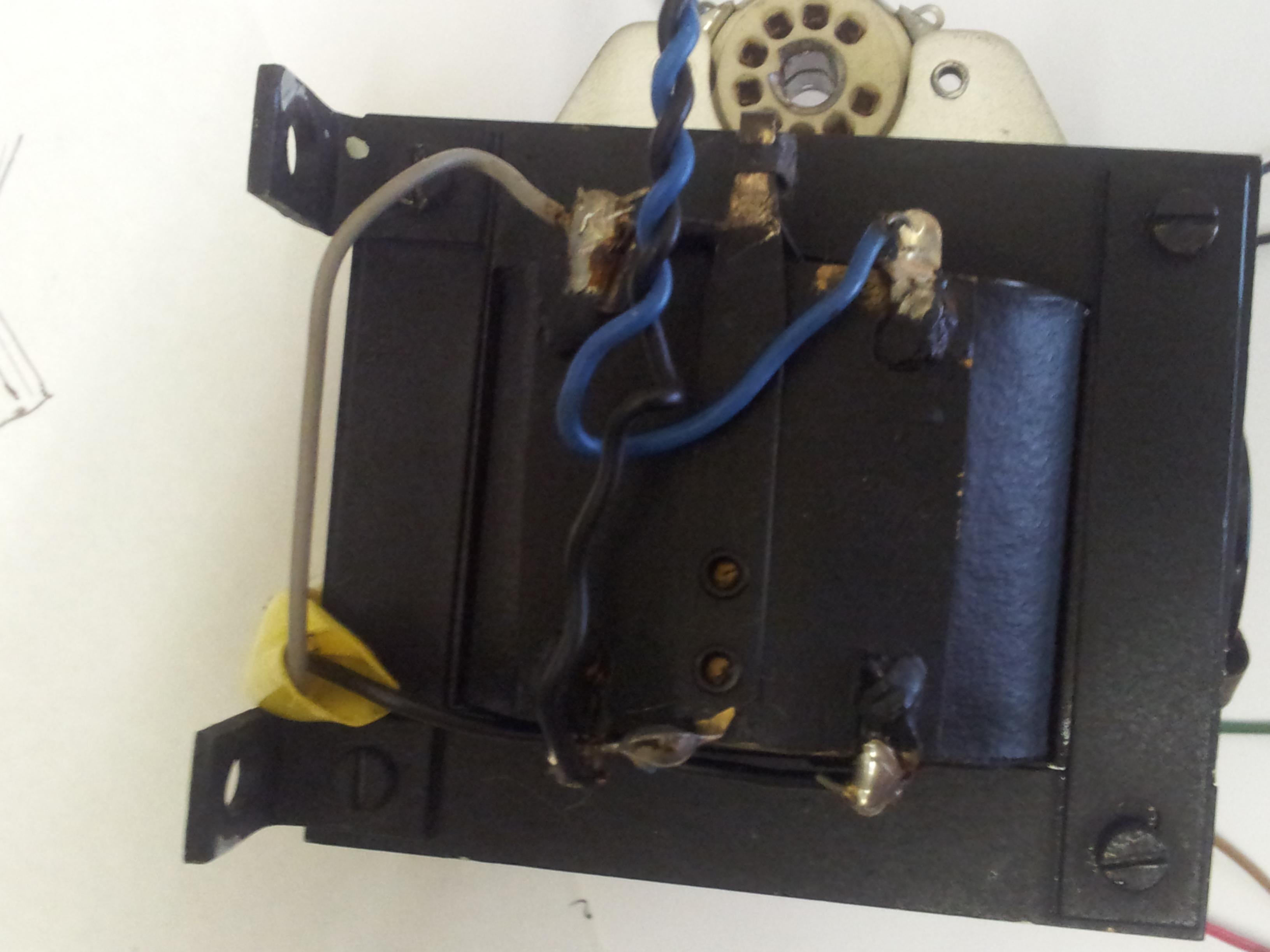

Post me a photograph of the Mains transformer. if they resemble the transformers made for the Philips "plano" series. i might be of assistance.
The 245 volts winding should be between the black winding (the one connected to the temperature cutout) and the upper-left tag. the tag under that should be 220volts

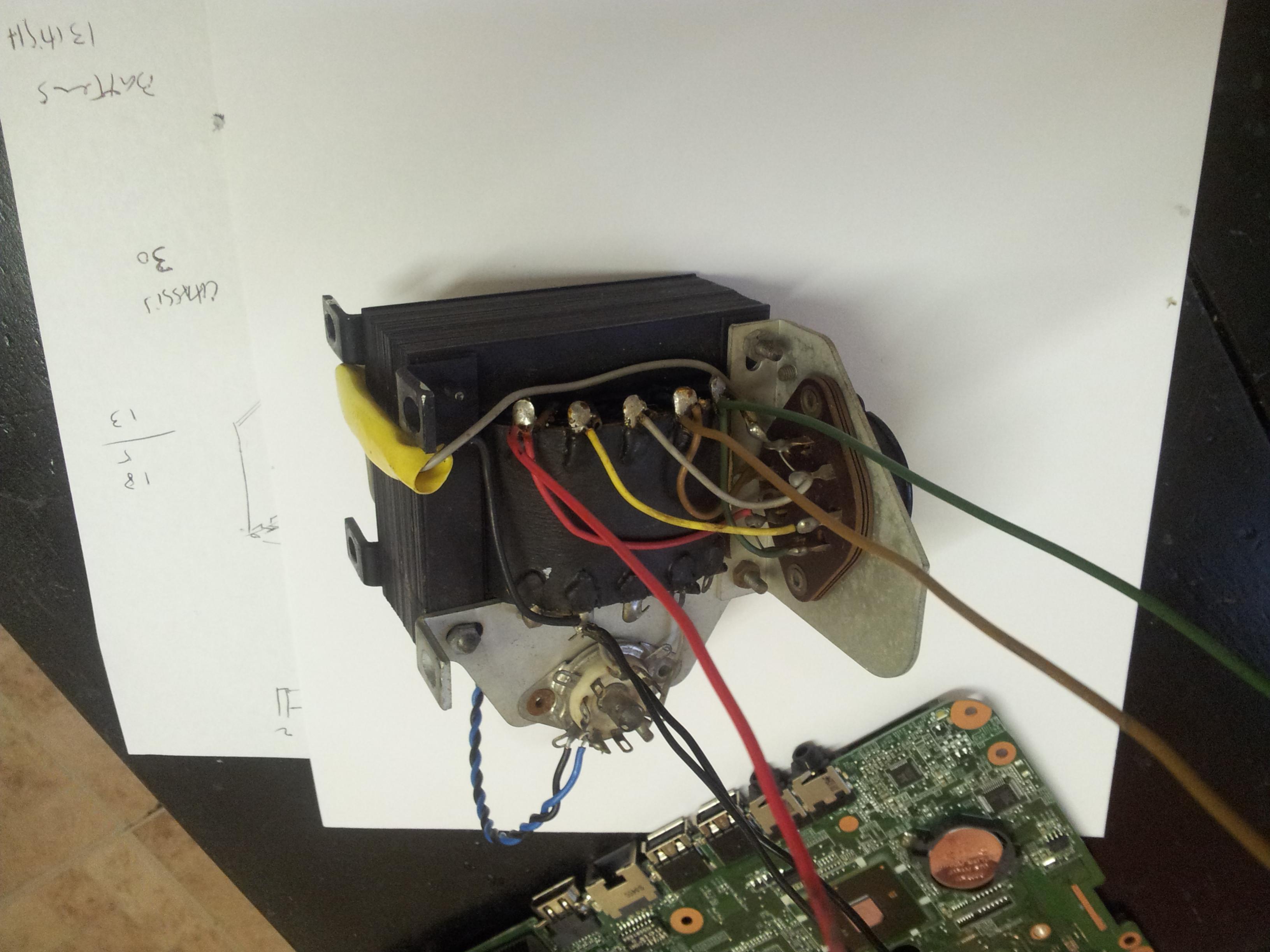

Still kinda lost on this, even after all this time as I put it away and am now looking at it again. After looking at rocaat's pics my PT is identical but I still am not sure where I can get any info on both the Power Transformer or even the Output Transformer (wt 511 21) for that matter. Any suggestions? Lastly does anyone know or can confirm the device that these came from. In my original post I thought that they came from el3536. Can this be confirmed and if so what tube compliment did it have. Thanks. 🙂

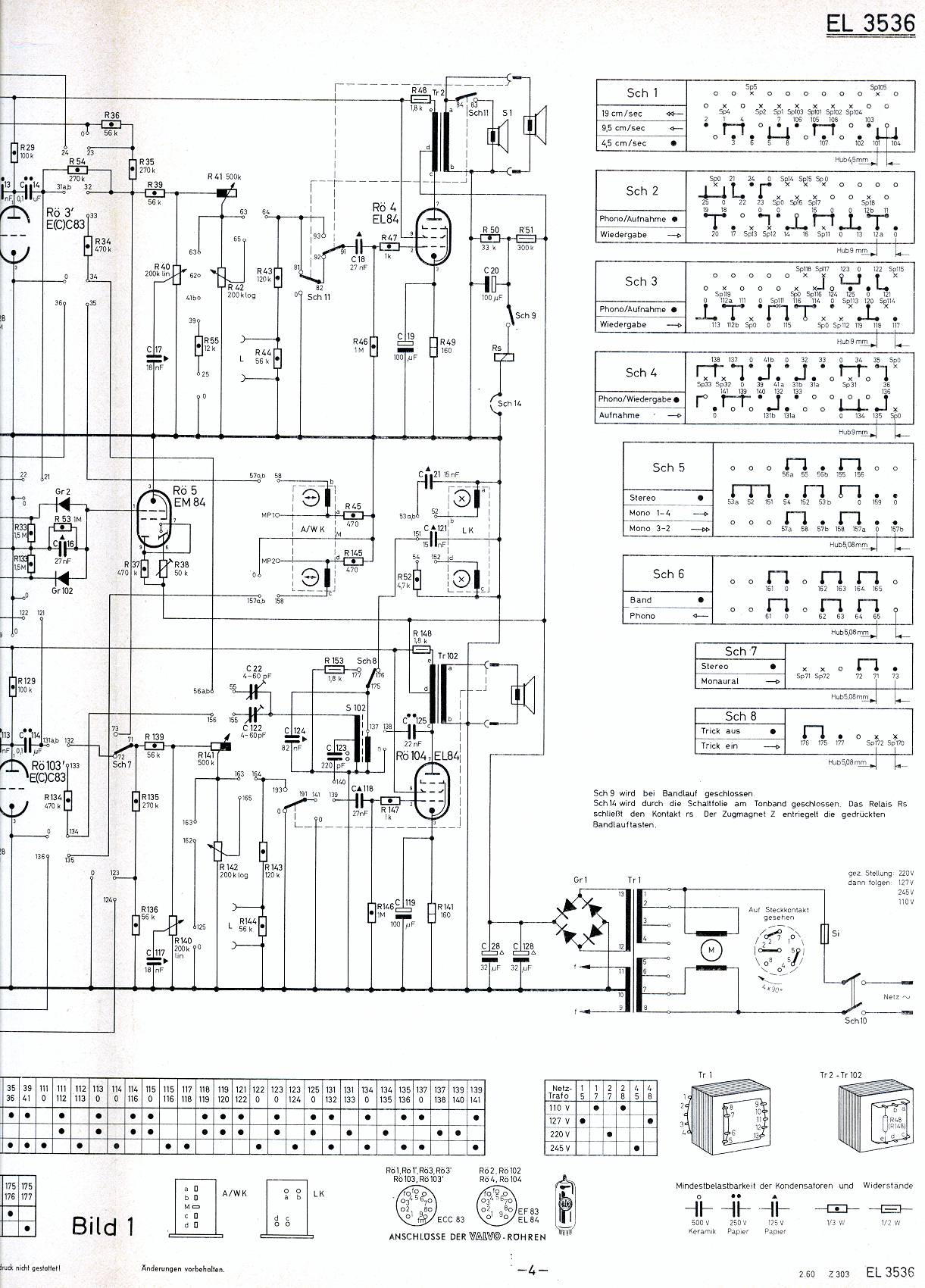

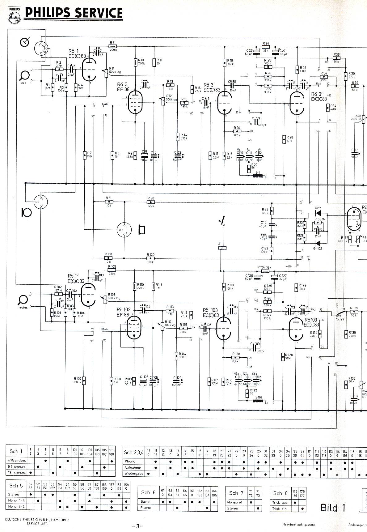

Dennis...if it is the Philips EL3536 the tube complement is as follows;
1X EM84
3X ECC83
2X EF86
2X EL84
This is a great place to find info on Philips radios, recorders etc: EL3536 R-Player Philips Radios - Deutschland, build 1959, 1
They have schematics for various Philips reel-to-reel recorders of that era with enough detail to give you voltages etc

Thanks, I appreciate it a lot. If it is from the el3536 then I have a way on reusing it. Where it uses a ez80 tube (the PT that I have) for rectification I'm gonna have to really look at what schematics cover that type of rectifier. Looks like if it does use el84 tubes then maybe I can make a ac-15 out of it. 🙂

This is the power-section schematic of an EL3536A.
It shouldn't be hard to figure out with a simple VOM what is what.
