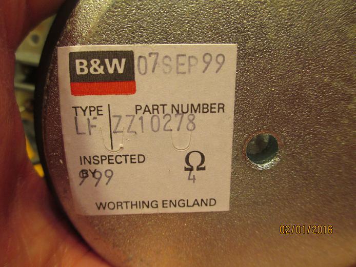

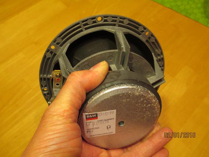

The top will be the excellent B&W DM302 monitors. And the bottom should be the mid/bass unit from its bigger brother DM305, sidemounted in an open ended TL (see my sketch). The factory DM305 are bass-reflex units targeting about 55Hz (-3db) so I figured the TL should probably target about the same?
Unfortunately I have no T/S parameters for the bass drivers and have no time to pursue measuring those, thus my plea for a little wisdom from the more experienced.

re: the T/S parameters. I tried passing the question through their sales front end people, even through a university researcher who at some point worked with B&W guys in the U.K., but no luck. it looks like the B&W engineers made it clear to everybody that they were not to be bothered 😡.
Thanks for the pointers. exactly what I am looking for. 🙂

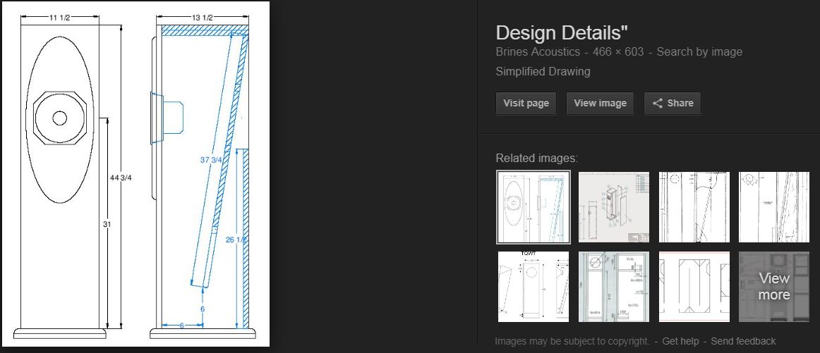

I am in the process of making this TL based on the recommendations I received here (B&W did not provide me with driver T/S parameters 😡).
I only calculated the added vented volume in their DM305 speaker from which the driver came and it was 30L, so my TL is going to have the same volume. I have 45 inches overall length (31 +another 14 after fold) and the length is 5 x the depth (9); slope ratio (3.2):1; driver offset by 0.22xlength from top.
As I understand the offset length (above the driver) is to be heavily damped?? I am planning on a couple of inches (~3-4) of open cell foam. does that make sense?
My other question has to do with the terminus (a.k.a open vent) area being equal to driver Sd (~120cm^2 for a 6-1/2 inch driver). That opening is pretty big and I read that the stuffing might reduce the sound pressure wave speed by ~20% so I was thinking maybe i should extend it by another couple of inches even if I am to get slightly under Sd? does that sound reasonable?
btw for stuffing below the driver in the fold I ordered AcoustaStuff from Madisound.
the design is based on this picture (my dimensions are smaller though as the overall height is only 33 inches; DM302 monitor will be sitting on top of it).
