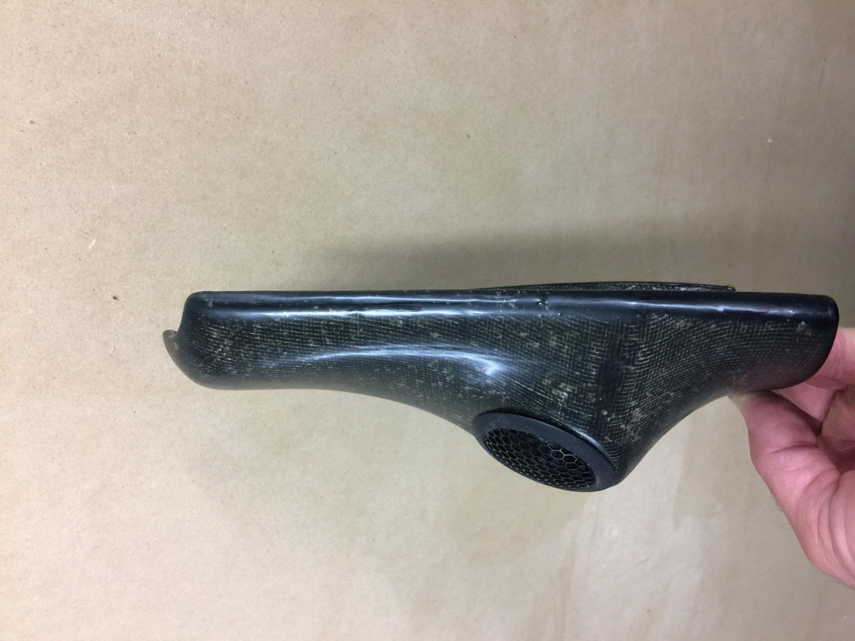

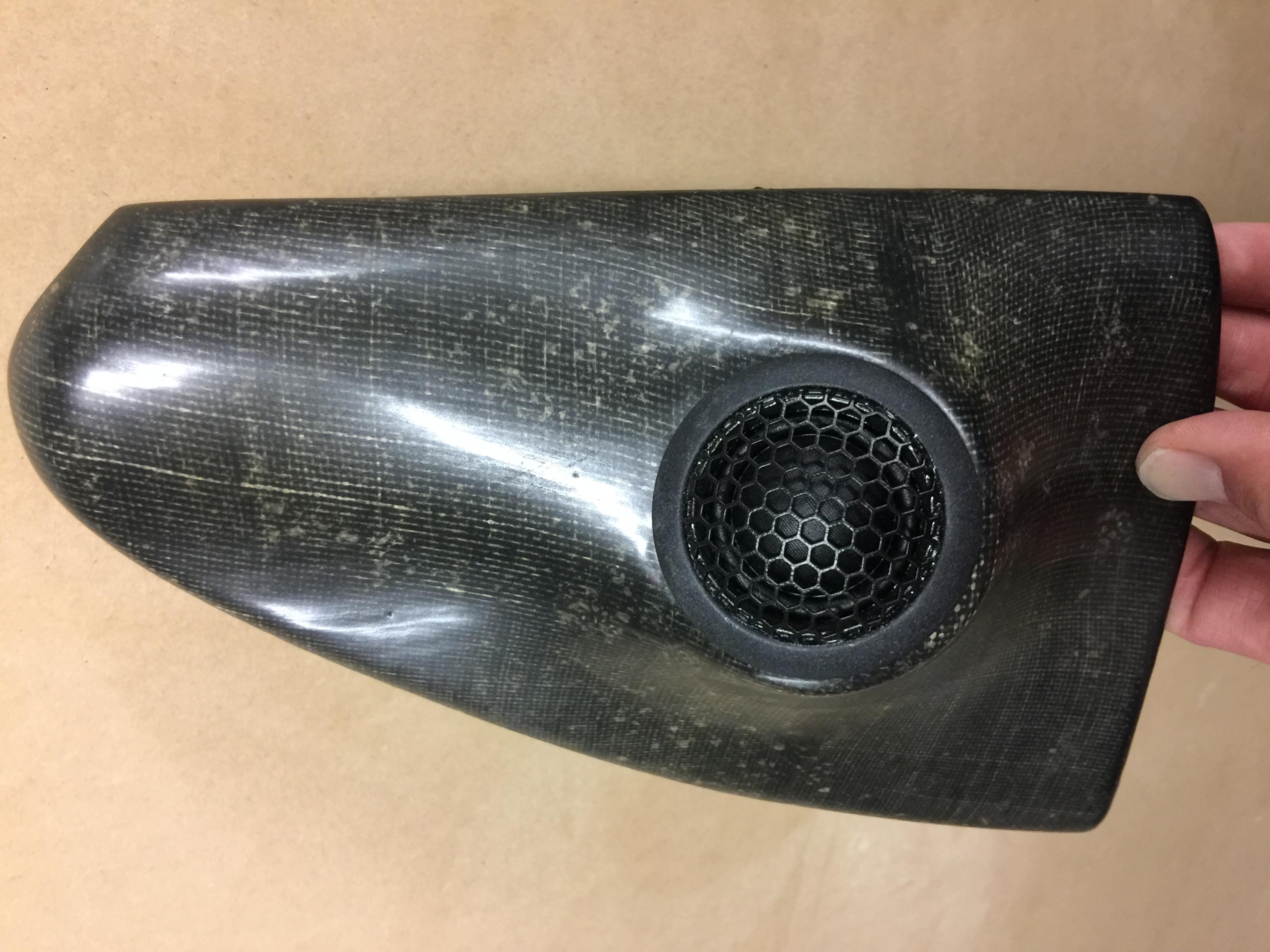

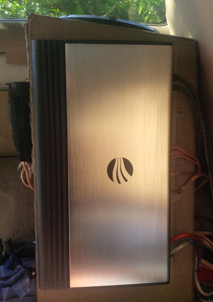

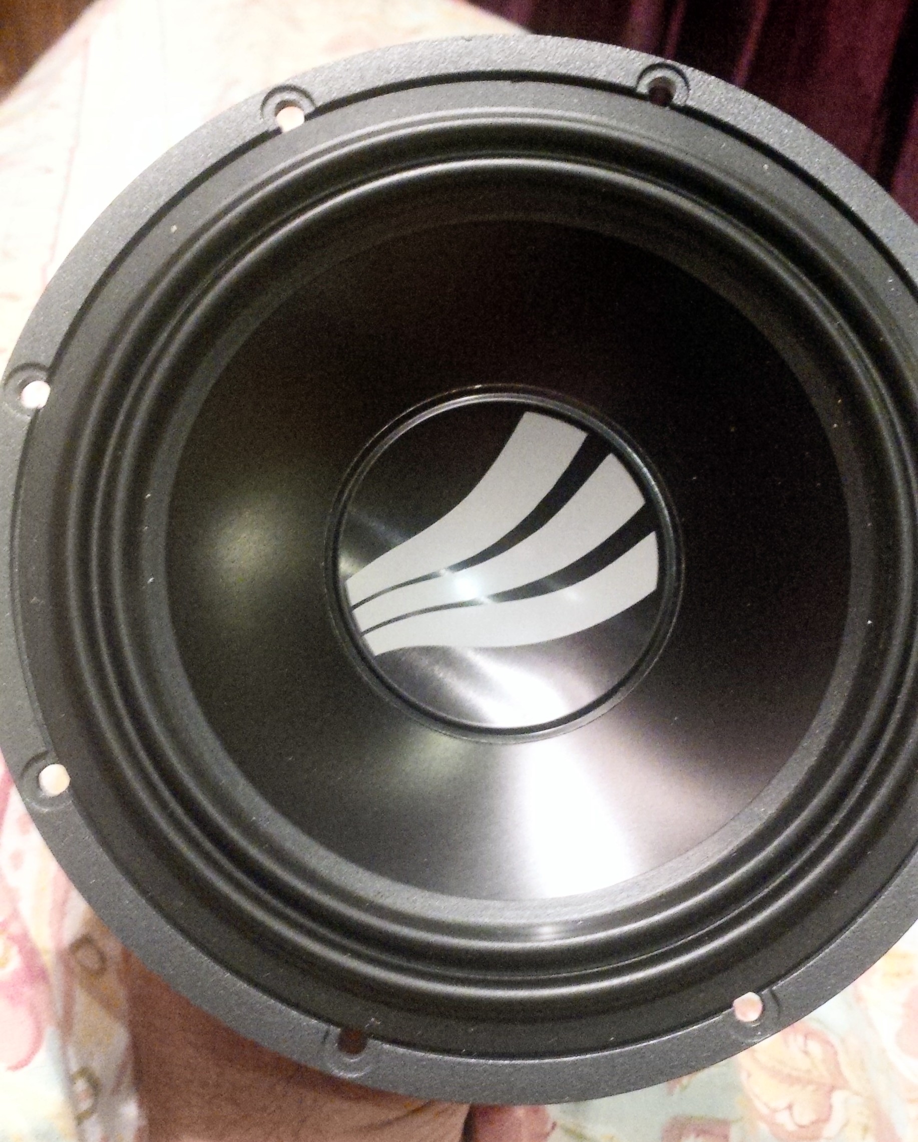

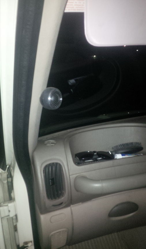

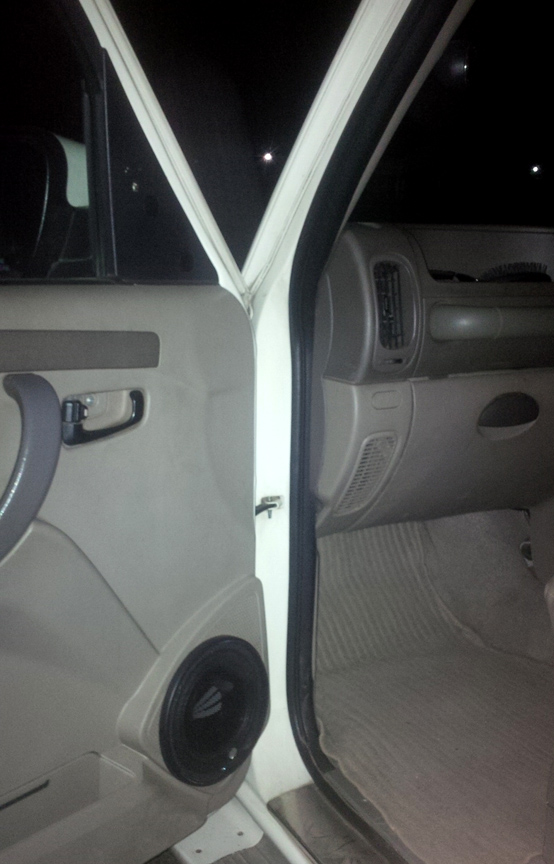

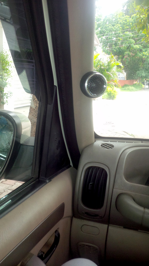

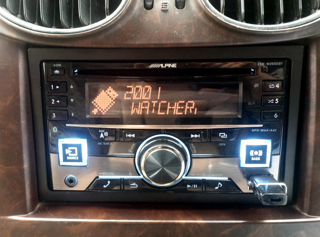

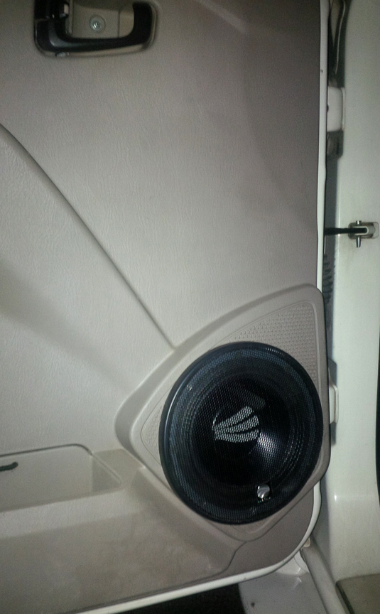

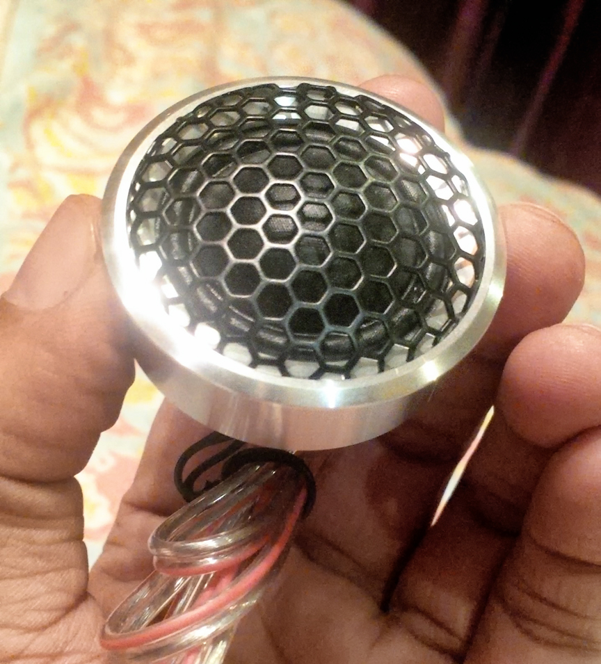

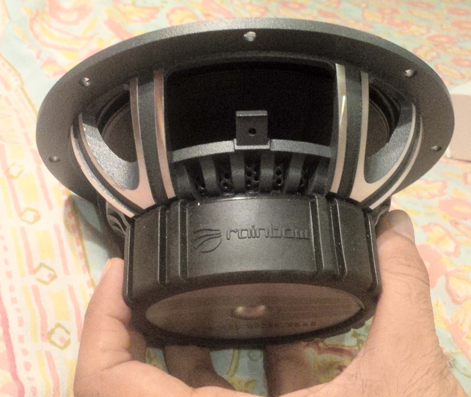

posting some pics of the Rainbow sound line Pro and the germanium amp and some install shots. will post more of the rear sub and 6x9's later.

The main problem with systems like this is correct integration and correct design, rather than the quality of the individual components.
You are inherently limited, by the cars cabin design, as to what you can implement and this is usually for worse.
As is usual you have a pair of woofers down in the bottom panel of the door. This is convenient and practical but that does then leave the question of where to put the tweeter?
Clearly you need something to cover the upper part of the spectrum but for good performance you need two things that are quite mutually exclusive. You need the tweeter at (or close to) ear height, but you also need the tweeter close to the woofer.
Of course systems like this don't sound horrible but rather sound decent, but cannot possible sound spectacular due to design limitations.
My brother visited recently with his new car and I went over the basics with him as I had upgraded the stereo in his previous car and he was wondering what I could do with his current one.
The basic sound was actually very good and I'm going to say to you what I said to him.
You can upgrade the floor mounted woofers, and the tweeters mounted much higher up, but for any real upgrade in sound quality you need to alter the basic concept of how the system works.
This idea isn't really anything new but it does depend heavily on what you can fit into your cars front area.
Basically you would need to change from;
Tweeter + Woofer + Sub.
to
Full range driver + Woofer + Sub.
This sounds like it could be an accident waiting to happen but everything revolves around the quality of the full range driver.
Use something like this...
2½" SB65WBAC25-4 :: SB Acoustics
And you're good to go.
The basic idea is to mount the little SB driver in a pod up on the top of the dash that fires towards you, so you're listening reasonably close to on axis. Yes the full range driver doesn't have the off axis performance of a small tweeter but this is actually quite advantageous. Its limited high frequency dispersion will reduce the number of reflections (caused by the irregularities in the dash) and improve imaging.
Treble/high frequency balance, is easily adjusted with your tone controls to tilt the response up or down to your tastes with the SB having excellent treble fidelity.
The crux of this design though is that the SB driver can be crossed over low and very low compared to most tweeters. I would high pass it from ~300Hz with 4th order acoustic slopes. This gives you painless integration, free from driver separation issues, between the top mounted full range driver and then the floor mounted woofer in the door.
Going this route automatically solves the two basic limitations of car audio installations without being overly complicated. Obviously you would need an active crossover for the 300Hz xover. The woofer would need a 300Hz low pass too.
If you need a sub, then add one, but the nice advantage of only needing to use the floor mounted woofer up to 300Hz is that you can pick it for its bass capabilities, rather than needing it to do both bass and midrange.

From what I can tell your system is already half active anyway.
Your head unit has several outputs per channel with variable crossover slopes and operating frequencies.
You are probably familiar with active crossovers even if you are not familiar with the terminology.
An active crossover basically operates along these lines.
CD player output > Volume control > Active crossover > Several channels of amplification > Loudspeaker drive units.
Whereas passive works like this.
CD player output > Volume control > Power amplifier > Passive crossover > Loudspeaker drive units.
I'm sure you are possibly familiar with the various pieces of car audio hardware that do the above.

Thanks for posting pictures. Looks like nice gear and a clean install.
5th element already pointed this out, but I will just add to it from some my experiences. I have found that when using components with passive crossover networks, mounting the tweeter and woofer as close as possible to each other usually works best. With some of the DSPs available with time alignment, EQ and filtering you would have more flexibility with mounting. I have had to completely rebuild door panels to get the best mounting positions for SQ. It was a very time consuming project, sounded very good. Probably will never spend that much time and money on a car stereo again though.
Going to a three way component set could help your situation, but adds more complexity and problems with mounting the drivers. 5th elements idea with using the the full range SB driver could work very well in your vehicle with the woofer so low on the door. You don't have to locate the tweeters at ear level to get good imaging. I made some custom fiberglass kick panels for a Honda Civic and it sounded like the sound was come from the dash. I should add that kick panel mounted speakers in an SUV don't work very well.
If you are still interested in changing up your current setup, you should consider learning how to work with fiberglass ( if you don't already know how ) it will open up unlimited possibilities. I will attach a picture of a tweeter pod that I fabricated for my Dodge truck. It still needs to be finished sanded and painted.

first of all, I think you guys really know your stuff. so I use a 2 way crossover of my head unit and i have set the front rainbows on 63HZ@12 slope, 6x9 80@no slope (full) and sub 100 hz at 6 db slope. so sound is well balanced this took considerable testing to get too on my own. the fiberglass is the real thing and i thought one can't make it at home. now research begins.i heard a 3 -way rainbow platinum setup here and it was too midrange dominated for my taste. but it was active so maybe that could be controlled? I had this setup on the JBL GTO 1004 and the system actually came alive when I put it on the Germanium amp.. Boom! Good amps make aso much difference I could never believe. I always thought that amps don't have a lot to do as long as they are decent. The focal ES165KX3 comes with a mount for both tweeters and midrange. Make life simpler? or limits things? How are the 1650.3 mille legends compared to focals? can they be powered by the germanium? 105watt@4ohm. Let me look into fiberglass cause that would give me more flexibility. any links? no space for kick panels in my suv. midbass cannot move but the doors are thick and huge so thats cool. also 8 guage power cable is enough for each amp? main one is 4 guage pure copper and then it splits on a splitter.Thanks 🙂
I learned how to use fiberglass about 20 years ago from several books that I had checked out from the library. I highly recommend books if available. Videos are good after you've learned all the basics like safety, cloth types, resin types, and how to build molds, and much more.
