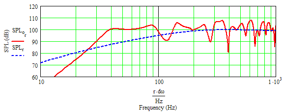

CLS said:I notice it has a relatively small Vas for such a big driver, so BIB comes to mind![]()
(Or I should say, BBBIB ?)
Just plug the numbers in, I got:
Vb = 460.3 L
H = 207.3 cm
W = 39.6 cm
D = 56.0 cm
Height of Driver = 114.4 cm
Looking good![]()

I see, still too tall, three feet would be ideal for me at center. - I found the BIB website from Godzilla - These look like they may have some bass ripple? I'm reading about this...... hmmm - it's almost a horn - why not add a back chamber?
It can be scaled to 3 ft.
BIB are just simple pipe horns with the emphasis on 'simple'.
Considering your audio systems history though, I doubt you'll be satisfied with a BIB even if corner loaded as they're meant to be to reduce the ripple somewhat.
Anyway here's the ~36" driver height version:
L = 124"
W x D = 17.75" x 25.125"
zdriver = 26.875"
a-b-c = 12.5625"
GM

Well i kinda like the tall profile and narrow front baffle- What type of loading would you propose then? Is it possible to get great bass without resorting to adding bass drivers in a system out in the room like this? I never thought so but single driver folks obviously are getting great satisfaction from single eights!!!
I was hoping to find a low comprise design I could upscale to a 15 - I have some 32" diameter spheres here I could load these into and add some woofers below the sphere but just using the coax without helpers intrigues me.
Yes, they are, but they accept the limited dynamics and higher distortion such systems impose, things you historically have strived to increase the former while decreasing the latter.
Anyway, probably the lowest compromise design without resorting to a helper woofer is a ML-horn driven with a high output impedance amp to EQ it ~flat. Otherwise a ML-TQWT with a big SS amp and BSC ckt. to flatten it at the expense of 3-6 dB eff. loss depending on your room gain.
