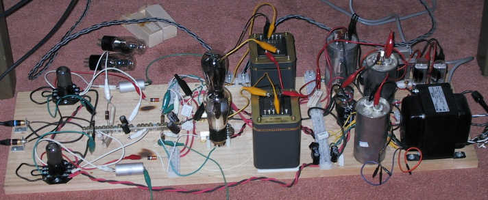

Hi Jeff, guess what immediatly came up my mind while looking at Your breadboardHave a look at my breadboard amp below. No metalwork necessary!
By no means I would like to fire up something like this without help of a scope.
>>guess what immediatly came up my mind while looking at Your breadboard .......oscillllllllationnnnnssss<<
>>By no means I would like to fire up something like this without help of a scope.<<
Your fears are much worse than reality. In a couple of years and dozens of circuits, I've had one problem with parasitics and that time I was asking for it. (I was using LED bias on a high gain pentode and had rigged up an unwieldy arrangement to swap in different LEDs rapidly.) Now, if I were using lots of valves designed for RF, I'd tend to agree with you, but it is not necessary with the low gain stuff I like to use.
Still, if I had access to a scope, I'd use one, but I don't let not having one stop me from experimenting. If you wait until you've got everything you think you need to build the perfect amp before you're willing to begin, you wont ever start!

are you competing with J.Epstein or D.Slagle for the cliplead award 2002 ?
jeff mai said:Have a look at my breadboard amp below. No metalwork necessary!
