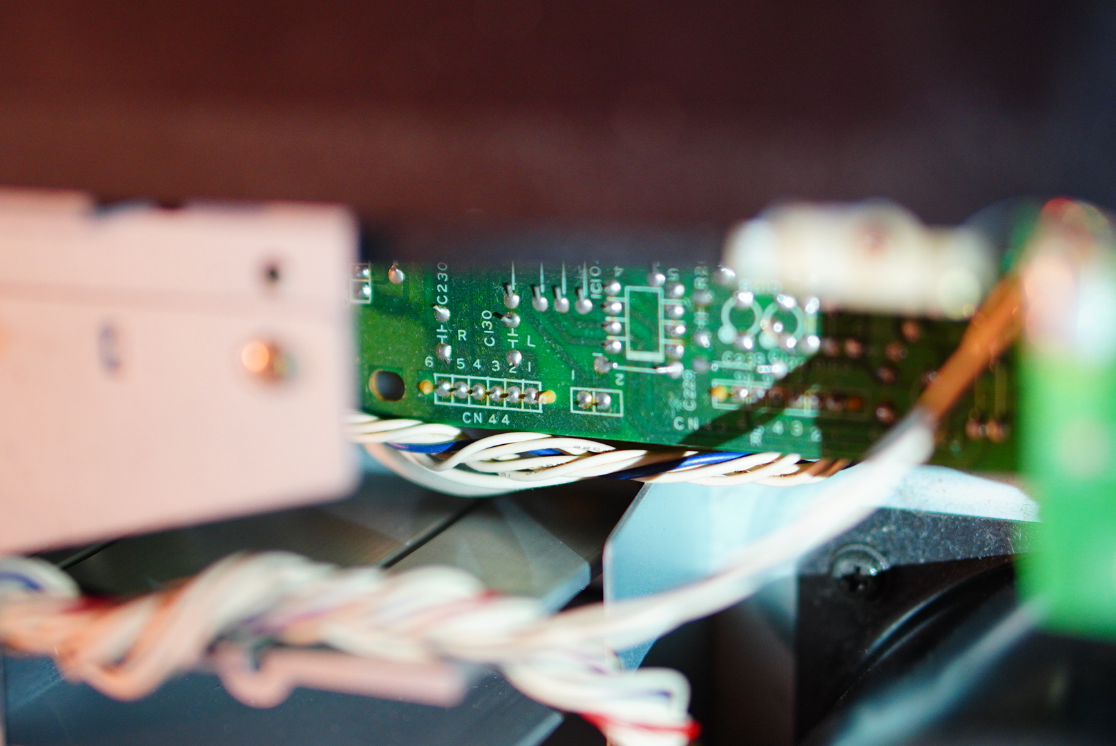

I am fairly capable. Basically I would like some help finding the spot where pre amp signal is sent to power amp.

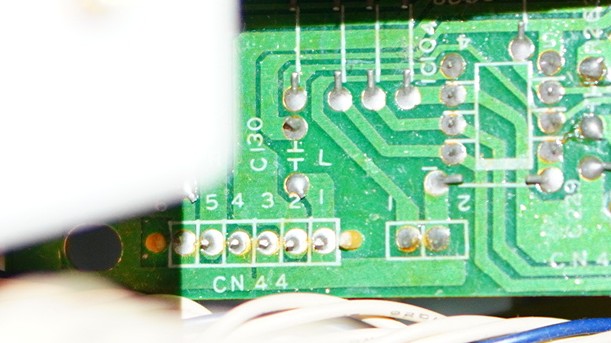

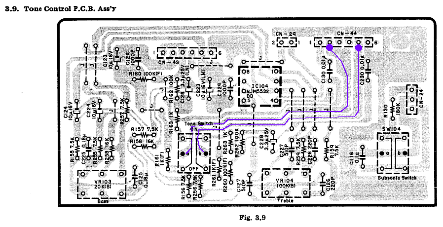

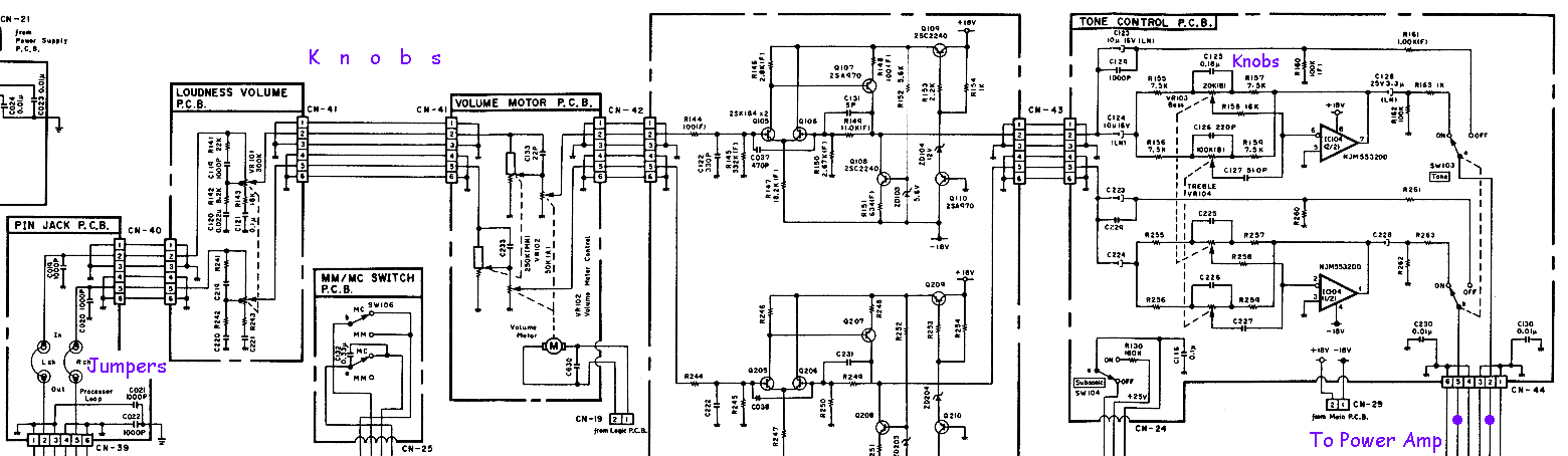

Sequence is selector, tape switch, jumpers, Volume controls, line-amp, tone-amp, power amp.
You probably want to tap the power amp feed.
Tone Control PCB, connector CN-44, pins 2 and 5 signal, other pins ground.
Depending how it's built, it may be easier to find these points on the Tone Switch.
Gain of power amp is 23, so about 1V max signal here.
Thanks for this reply. I will try to locate those connectors inside the amp tomorrow. And to confirm my findings could I connect headphones to those connectors . 1v should be enough to power ear phones right
So connector 2 and 5 is either left or right channel
And all others (1,3,4,6) are ground?
So when I plug in ear phones 2 and 5 will be either left or right . And i could connect ground of headphones to any of 1,3,4 or 6 connectors?

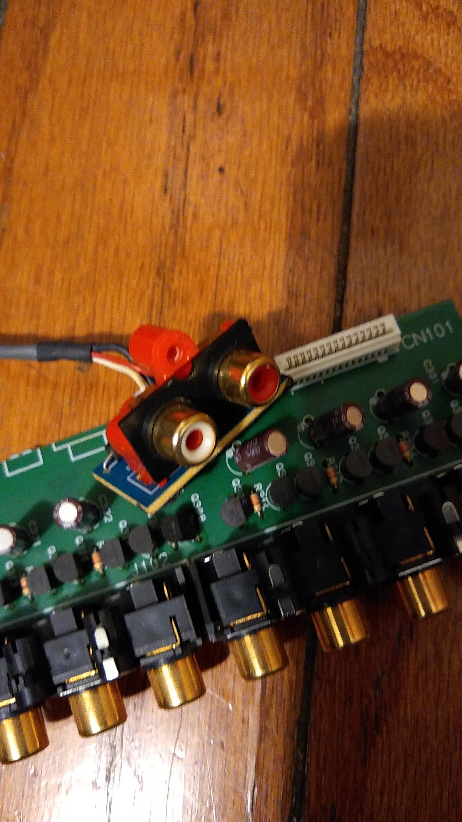

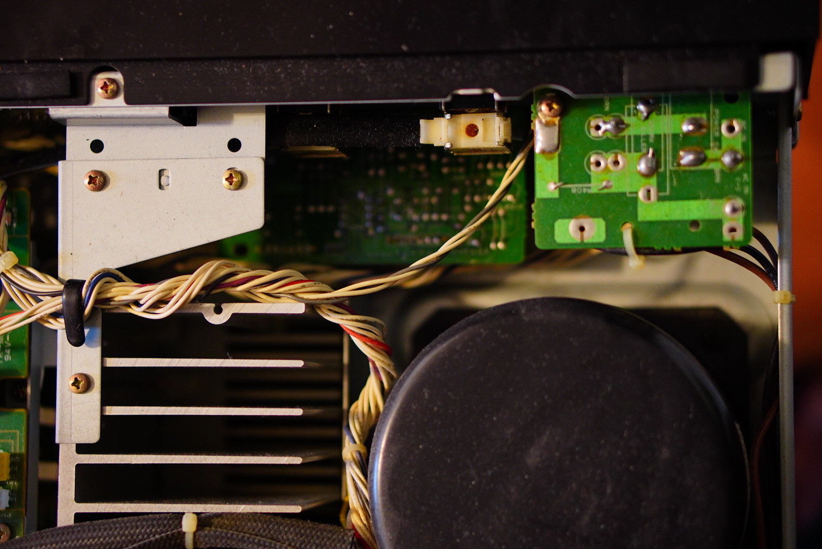

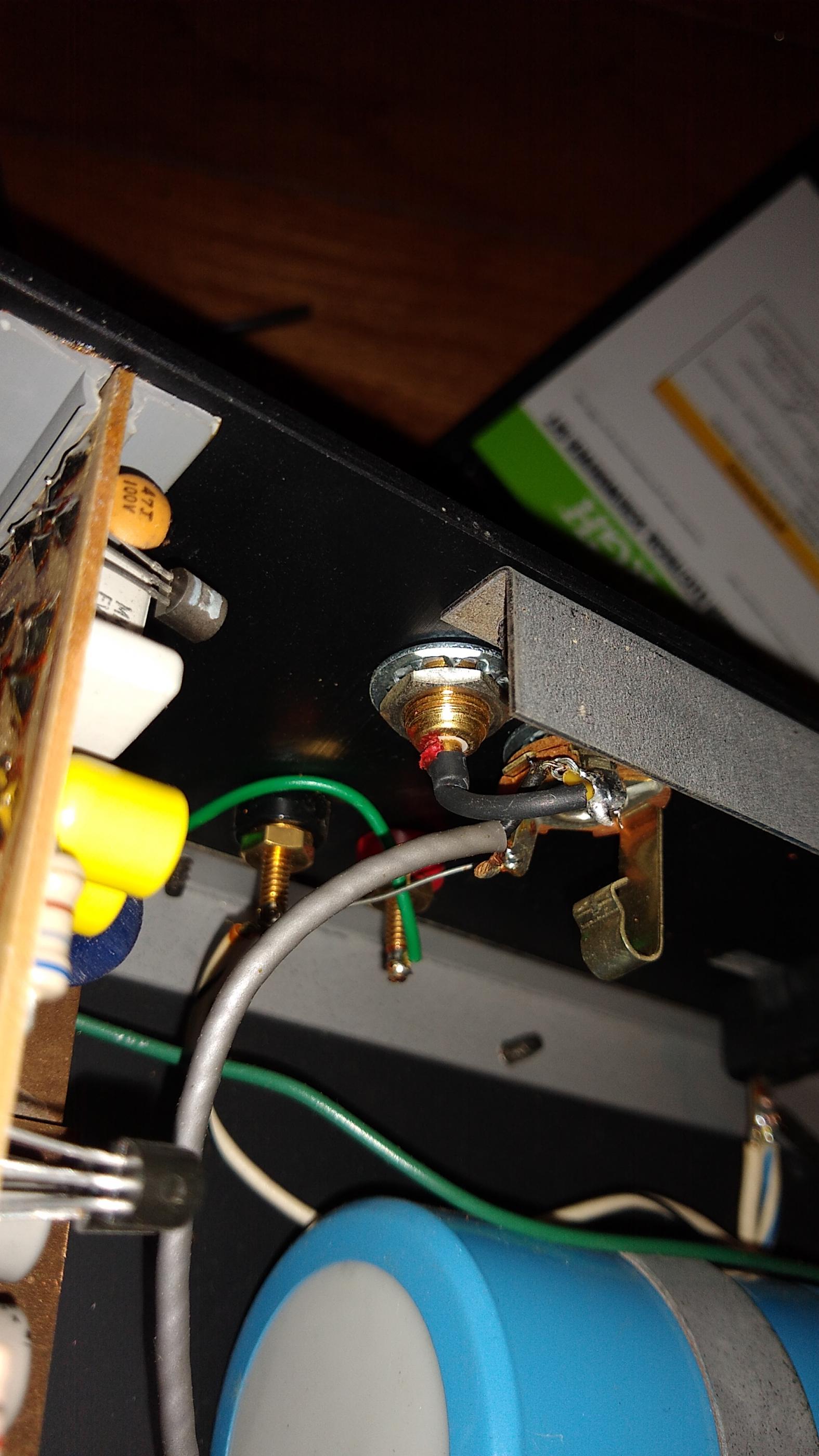

So I tapped in connector 44. Used headphones to confirm volume and tone controls work.

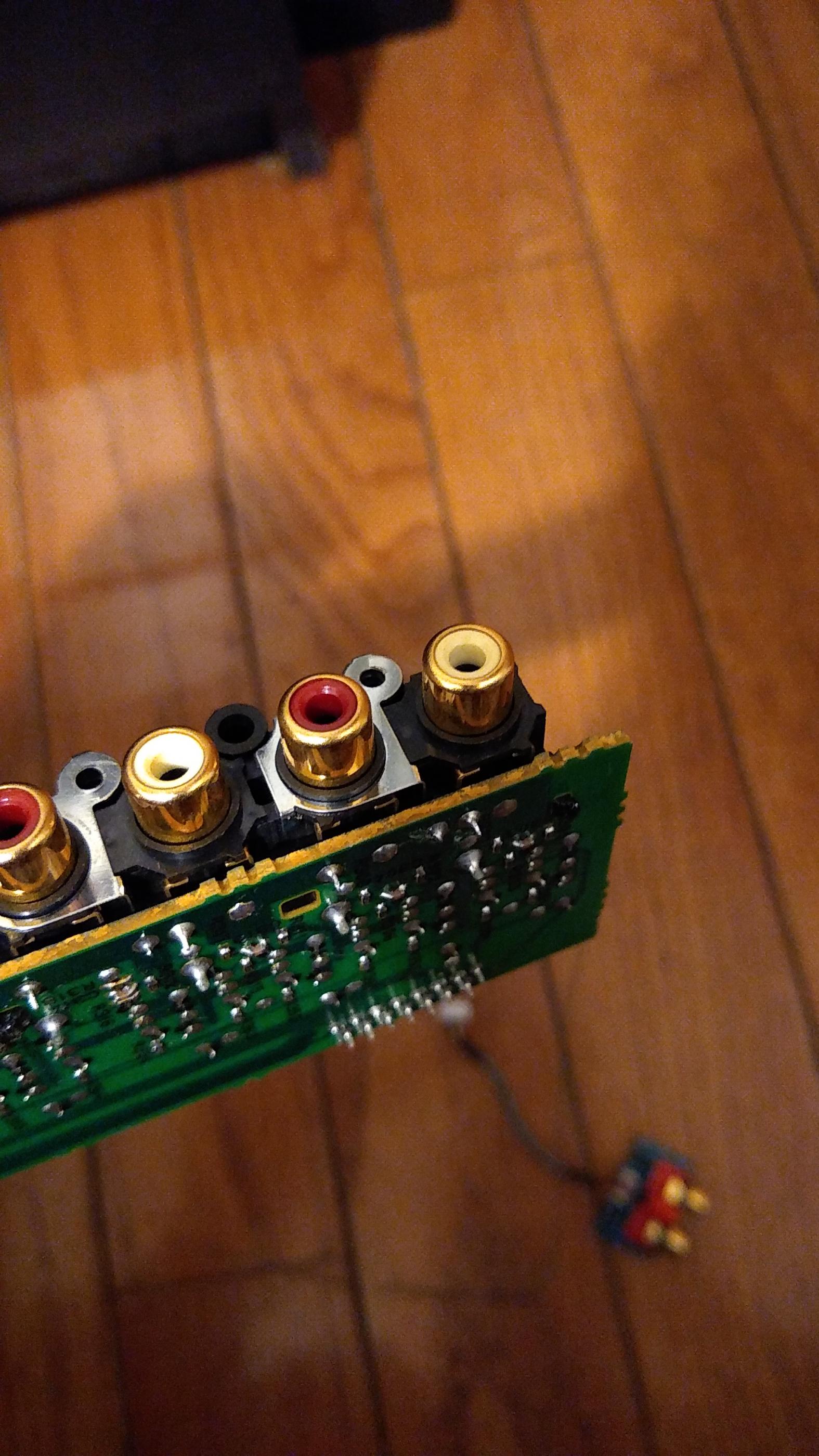

One quick question.
Do grounds of rca jacks connect to chasis eventually?(in general and in this receiver in particular)
I would like to only run signal wires from pin 2 and 5 to the rear pannel. Tight space and I don't want to clutter it with many extra soldered wires
I have 2 types of rca jacks. Please See images to visualize
One quick question.
