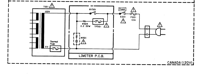

Hi Everyone,
I purchased a Nakamichi PA-7aII power amplifier this weekend, which is a model I've coveted for many years...unfortunately the amp's first owner shorted the speaker outputs on this amp a few years ago, and it hasn't turned on since.
A local Tech diagnosed the problem with amp for the previous owner as being a burnt out thermo fuse; this would be an easy fix, except that device is located INSIDE the huge potted proprietary transformer. The Tech told the old owner that it would be necessary to physically chip away at the potting material inside the transformer to replace the thermo fuse, so he declined to perform the repair.
I did some basic testing and reviewed the service manual schematic with a Technically minded friend, and confirmed the thermo fuse is, and is located inside the transformer. Does anyone have any solutions on how to fix this problem? I'm assuming I can't just safely bypass the connection where the thermo fuse is wired into limiter PCB. Are there solutions that might help to dissolve the potting compound so I could get inside the transformer?
Any suggestions would be welcome!

Hi Trevor,
Have you confirmed that the transformer primary is in fact open?
There is a soft start circuit that will prevent the amp from turning on. This is commonly damaged if anyone actually is successful in blowing one of these up. There was only ever one blown under warranty (for real) and I had to fix it. I was a copper staple from the box that fell inside. The copper staple did not survive.

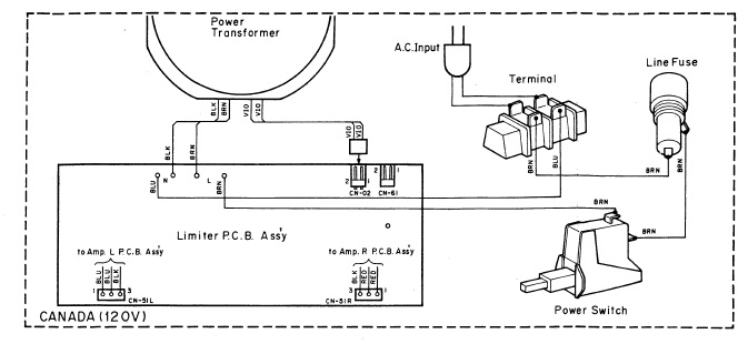

Hi Chris,
Thanks for the reply. I think the circuit you're referring to is located on the The "limiter PCB" which has both a fuse and a thermofuse on it; both are OK.
The primary winding is open, so we're operating on the assumption it's the thermofuse rather than the winding itself. My hope was that if I chiseled enough material out of the transformer I might get to the thermofuse and just bypass it to restore the main winding. Have you ever seen a transformer setup that way?

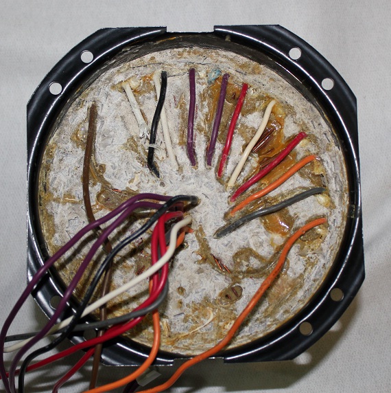

Hi Trevor,
Good lord!
Do you have any idea how much it takes to open the thermal fuse on one of those?? I'm impressed with the obvious stupidity involved with this (by the original owner). Is it possible that some moron cranked the bias up "to improve the sound quality"?
I have never once heard of an open thermal fuse on any of these series of amplifiers. I didn't think it was possible to do under normal circumstances - even under "professional" use (no professional would use one of these, they are mismatched to the job at hand).
I can think of two reasonable options for you. One (cheapest I bet), find a destroyed PA-7II and buy it for parts. Two, contact Plitron and see how much they can build one for, offer to bring in the dead thing. With the original, they will be able to make an exact match and they can also estimate how much since they will have size and weight, along with the specs from the manual and also loaded secondary voltages.
Chiseling into the potting will not end nicely. You'll know you've cut the copper once you see copper in the cut. It's probably a better bet that someone who does this for a living can maybe repair it for you. Who knows, Plitron might be able to do a repair. I've never asked them. Thing is, once you destroy the transformer, no one can measure the inductances or capacitive coupling. Useful information I've been told.
Of all your options, working on the core yourself is the least likely to succeed. It will also probably end up as wasted effort and a destroyed set of ex-clues. Please don't do that until you have at least a new transformer mounted inside the Nakamichi and running first.

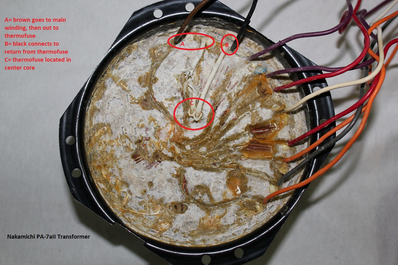

I would certainly love to find a dead PA-7II, but I expect the cost of even a dead one, plus shipping, would be really high. Getting a replacement transformer made is a reasonable option, since I didn't pay much for this unit and they do still fetch $700-800 in original shape.
I've actually been chipping away at the potting material already, and I've got to the bottom of the transformer now (see the attached photo). I have nicked a couple wire jackets, but no damage other than one thin lead that is covered in a white cloth over at about 11 oclock (easily repairable). The cut wire seems to be part of the main winding as one end meters to the brown wire, the other side is dead. Another thin lead covered in white cloth is to the right of the wire I cut, and it meters to the other end of the main winding (black lead). I'm wondering of the two white cloth covered wires aren't the leads for the thermofuse, in which case I can just connect them and I should be good to go.

Well sometimes ignorance and persistence pay off
I connected the two exposed leads which were covered by soft white cloth insulation, since I was pretty sure they were what put the thermofuse in the main winding, and quick test with a multimeter suggested I was right. Next I installed the transformer in the amp and tested the output windings with AC connected, and all seemed good. Then I hooked up all the connections, powered up, and after a few seconds the protection circuit clicked off, confirming operation.
I've now had tunes playing for about an hour, and all seems fine. The heat sinks are warm at about 38 degrees C, and it's sounding great
When time permits I'll re-cap, upgrade the adjustment pots, reset bias & DC offset, and do some critical listening.

Thanks. Attached is how the transformer looked right before I connected the two wires to bypass the thermofuse. I basically connected points A & B by joining the wires in the white cloth insulation.
