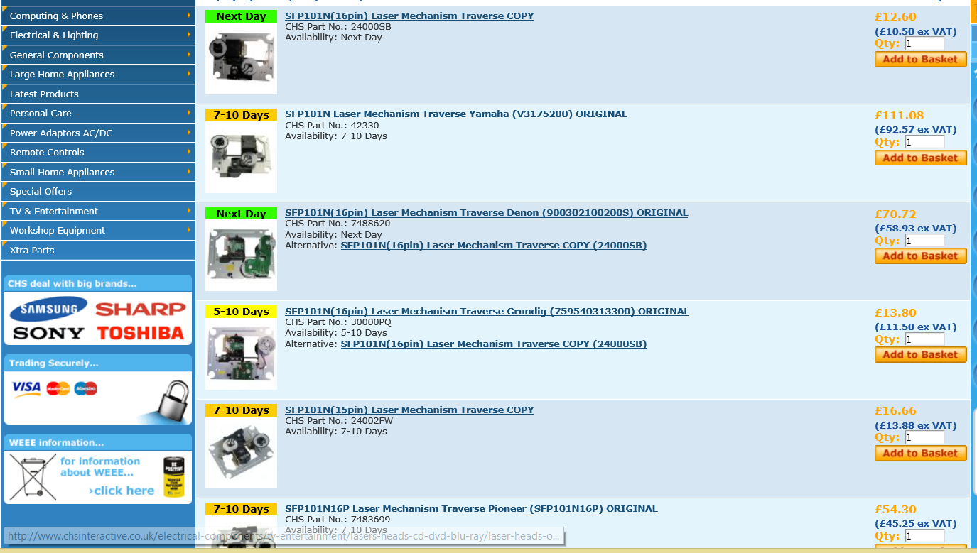

I have one more question: are those ebay 'original pickups' geniune? On the original, there's a Sanyo logo on top of the pickup, I don't see that on the pickups for sale on ebay.
That I'm afraid I can not answer. Philips CDM 12xx type are well known for being poor quality non originals but I've not heard anything regarding these. There are many "generic" replacements around for the likes of the common Sony KSSxxx types and these are generally fine.
So I would say a fair chance its fine.
If you look here (if the link works) you will see all the different prices on offer,
Search results for SF-P101N
If the link is no good search for it here,
CHS - replacement remote controls, instruction manuals, audio & video accessories, electronic components & spare parts
You will see the cheapest one in those above is described as "copy" but that is what a service dept would order and fit as a general rule.
