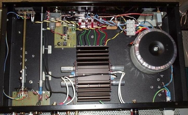

The AKSA and the P3A IMO need an active pre to get the best from them.
With the chipamp.com Non Inverted GC you can get away with a passive pre and just put the pot 10K-50K and selector in the same box as the power amp.
Like this as this uses a GC kit from chipamp.com
