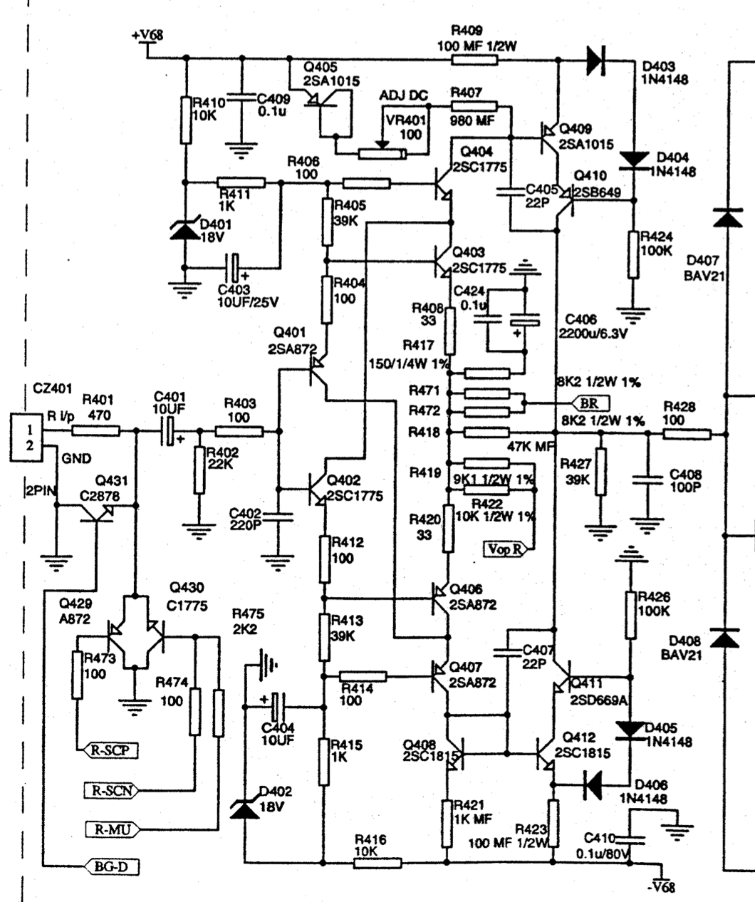

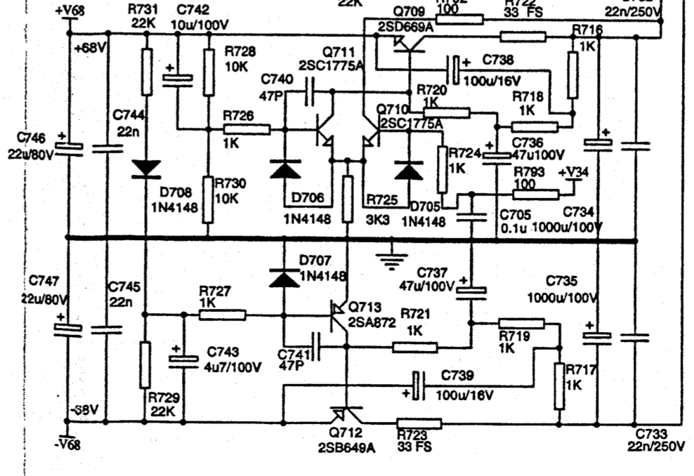

Thank you all for your input. I've traced the fault supply (+68V and -68V) to the first stage of the power amplifier. I only get +27V and -27V from the supply. That would explain the hum/buzzing on both channels equally and then a valid protection mode.
I'll look at replacing the large Caps on the power supply and see if it restores the +68V & -68V
The +/-68V regulators use the preamp power supply (+/-34V) as a reference, so it may be a good idea to check those voltages, too. Generally speaking, the C 370 runs quite hot inside, esp. around those regulators on the right side of the main board, which leads to caps losing capacitance, gaining ESR and often leaking electrolyte. While you are at it, consider re-capping at least the main board with some quality caps rated for 105°C.
