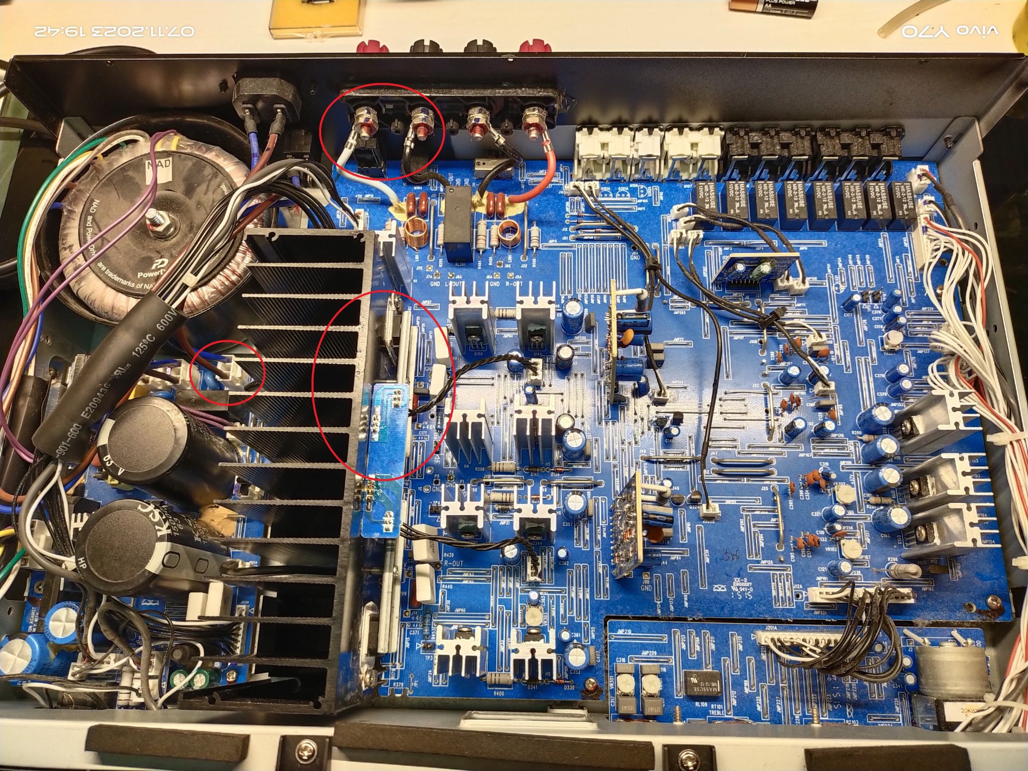

Hi everyone, I'm a new user.
my NAd 3266 goes into protection mode after about a minute.
I'm looking for help to repair it, I've done various checks and measurements.
The problem is on the left channel, the resistor R483 heats up too much and if I try to adjust the quiescent current with VR103 between TP1 and TP2 it doesn't move, it remains at a value around 5 volts.
When I turn it off I hear a discharge noise on the speakers, I thought it was a leaky capacitor but they are good, at least the ones on the left channel chain.
The transistors seem good, I also reversed the finals and the problem remains.
I attach the diagram.
Can someone help me?

The hot R483 suggests that the amp output is stuck at a supply rail, so I suggest checking amp output voltage before the protection relay. The bias spreader may be involved since you mentioned VR103 was unresponsive and you observe that excessive voltage across the emitter resistors R239 and R240--- 5V!
I infer that the amp may recover after resetting since you mention protection occurs after about a minute. This surprises me, as I would have expected the damage was catastrophic.
I normally enjoy troubleshooting amps, but the design of this amp leaves me unnerved. I hope other members will jump in.

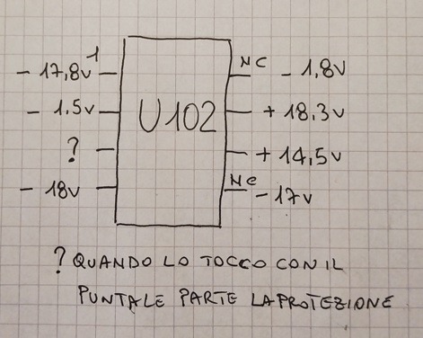

Hello, the output voltage on the left channel is 1.5 volts the right 0.
If you turn off the power to the left channel it works, when the attack goes into protection.
If I put a lamp in series on the 220 volt cable it works well and does not go into protection, but 1.5 volts remain on the left channel output.
On the control of the U102 operational amplifier which deals with the resetting of the offset of the left channel I find fluctuating values on pins 2 and 3 that vary between -3v and 1.5v ????????.
on the other pins:
4 -17,8v
5-17,8v
6 0v
7+18,6
8 0v

Hard to imagine 0V on opamp pin 6, especially with moving voltage on pin 2 that can come only via pin 6. Sure sounds like a bad opamp, though it would be a pleasant surprise if that's the only problem.
I think I'd double check readings, then replace. And install a IC if there isn't one already there.

Hi, I found a desoldered jumper. Now I was able to adjust the quiescent current.
The two operational amplifiers U102 and U302 have the same measurements therefore they work.
The problem of 1.5 volts on the left channel output remains.
I can't figure out what causes it.
If left channel is at 1.5V, I would expect U102A pin 6 to be stuck near its positive supply rail.
If the servos are working properly, their output (pin 6) voltages should be in the active region, well clear of both rails.
What do they measure?
