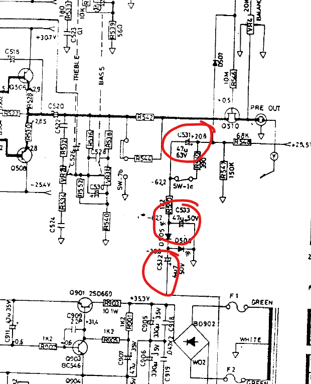

It may be this one attached.
I'm going to say many/any/all electrolytics caps on a NAD of this age could suspect. Normally I'm not a fan of blanket recaps but for NAD I make an exception.
Check these caps in the FET muting as deterioration can modulate the audio via the FET's

thanks Mooly, the schematic is correct for my layout. I will start with these three caps and see what happens
Thanks guys for replies. I did try one more attempt to correct the two issues, I left the amp on for 5 hours and the buzz/distortion/light sabre is still there on power up; however, amazingly the right channel has burst back into life. I can only assume the caps in the signal path have "reflowed" after a long lay off? I switched off over night and this morning the same result so one issue down. I will replace C531-533 as these seem to be the common cause of the power on noise? I will eventually get round to replacing the other caps mentioned but am leaning to the "if it ain't broke don't fix it" mantra.

Been some while but have just got round to replacing the three caps mentioned. I also for good measure decided to replace the large filter caps whilst I was at it and had to strip the chassis down and lo and behold one of the caps legs was disconnected from the board so I am not sure exactly how much of an effect having three instead of the four would have on the DC supply , less smooth I would assume and also shorting.
Anyway all in and buzz and hum all gone so all good.
