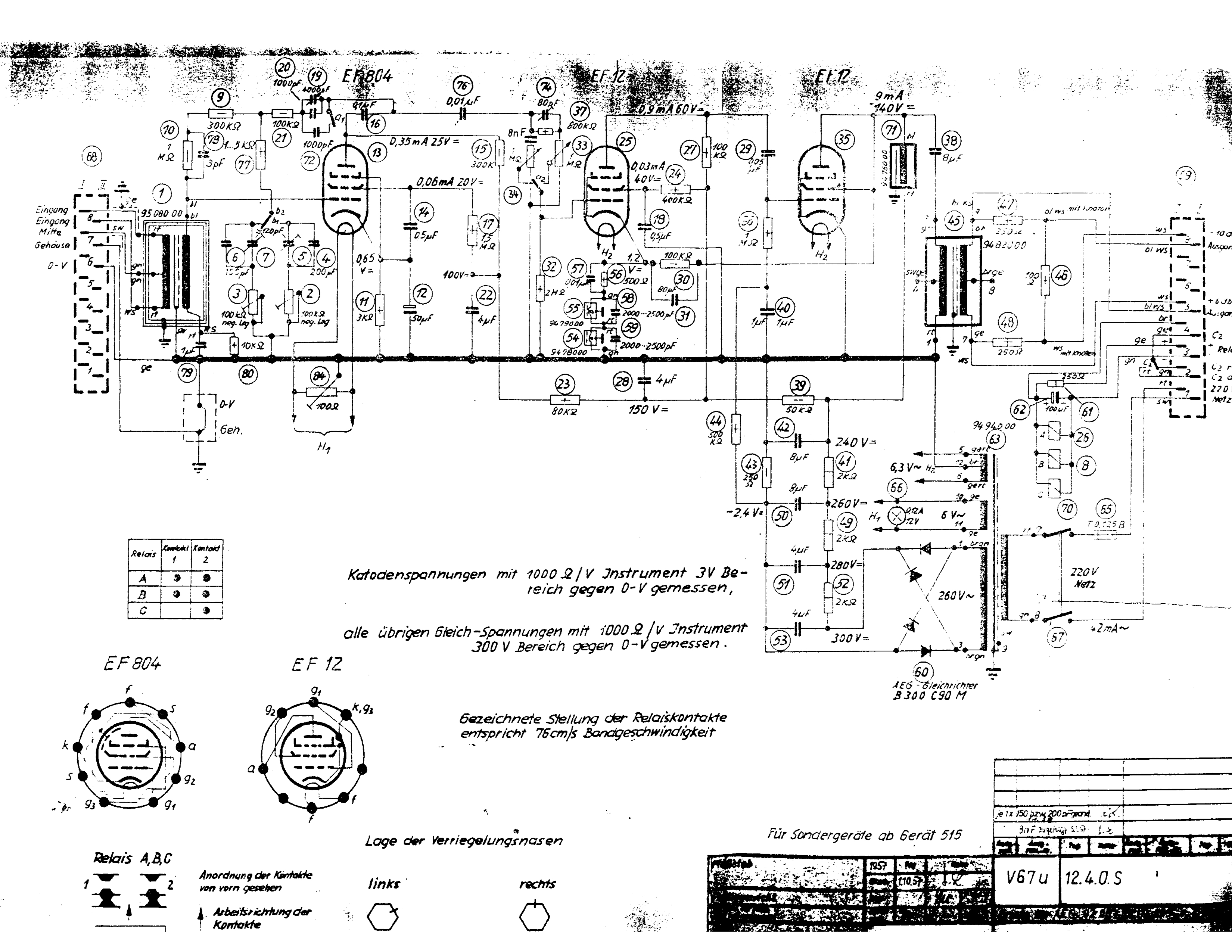

Right now i'm busy trying to figure out what unit i am working on. As far as I can find on the web it is a unit from a Telefunken T9 master recorder.
I found it sitting on the attic, waiting for me to restore it..
I remember that the guy that gave it to me many years ago said it had to do with an old Philips EL3500 master recorder that i bought from him. It came together with a headblock and a loose erase head. It might be an erase / bias amp but I am not shure..

If anyone has a schematic for me I would be very happy.
I took a go at it to draw one myself but the original stuff is always better to have.

Hello,
this looks like a head amp V67u (version with one EF804S and two EF12). The UY11 in the sockets are wrong.

OK Andreas,
Thank you for the answer. I had my doubts about the UY11's too.
It was written with pen on the chassis next to the sockets. Obviously very wrong!
I will buy the EF12 tubes and put them in. I hope i can get hold of them via my tube provider.
Do you know where to get the original schematics?

Great..!! Now i can try to restore the unit. The guy who gave it to me years ago, must have taken all the transformers, relais and choke off the chassis for a DIY project of his own in the past, so now i must try to find the missing parts.. If anyone has them for me?
Anyway thank you very much for the schematics

Andreas,
Do you know how to get the right specifications of these in / out transformers so i can maybe order them from Cinemag company? Audio Transformers By Cinemag Inc.
