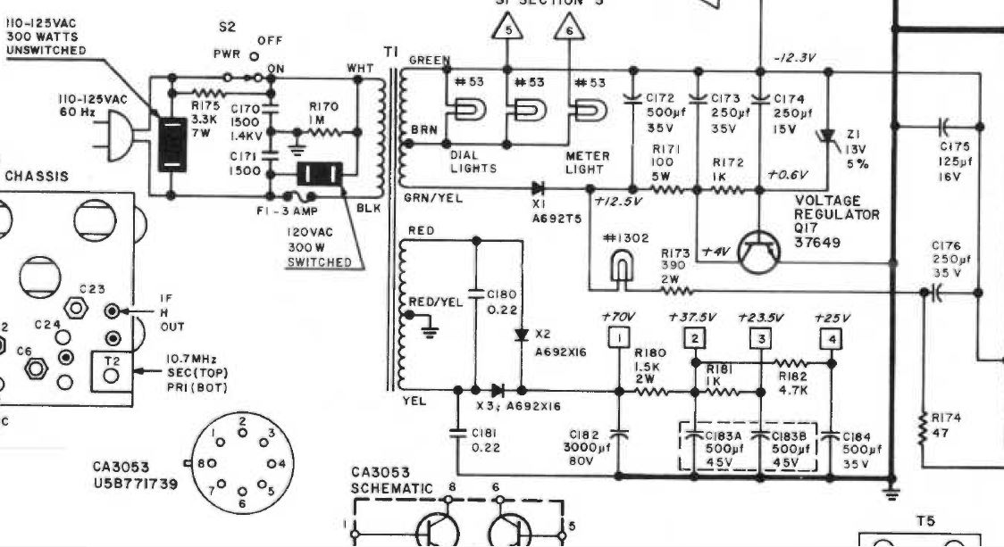

I clicked through this thread, as well as did some google searching. It would seem as if most of the filter designs out there require that the chassis be grounded.
For my Sherwood, it has just the standard live and neutral connections. The chassis is grounded, but it looks like in the picture. I think there would be issues hooking up a third ground pin in order to ground the chassis as would be required in a proper mains filter, and R175 and R170 might have to be removed. But I would be afraid of what might happen throughout the rest of the circuit if this were done. Would it be an issue if the chassis were not grounded?I think it would potentially be dangerous.

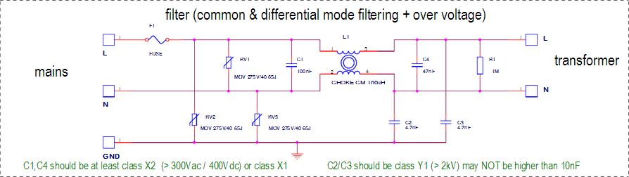

I was thinking about using this circuit, but this requires that the ground connection coming off the circuit be grounded to the chassis of the equipment- something I don't think I could do, referencing the above picture. I was wondering though.... I want to make a power strip or something with the filter to plug the equipment into. If i were to do that, and the power strip were made with a metal chassis, and I were to ground that, wouldn't it be all set to then plug in just two prong equipment? I understand the reasoning for the ground requirement being in case the ground lifts the enclosure won't become charged. Any way I could get this to work?
I will ground both for safety, after i have checked to make sure the ground pin in the outlet i am using is functioning correctly. I don't want to ground the chassis to filter circuit and have the ground lift because the ground connection itself back at the breaker box is bad.
