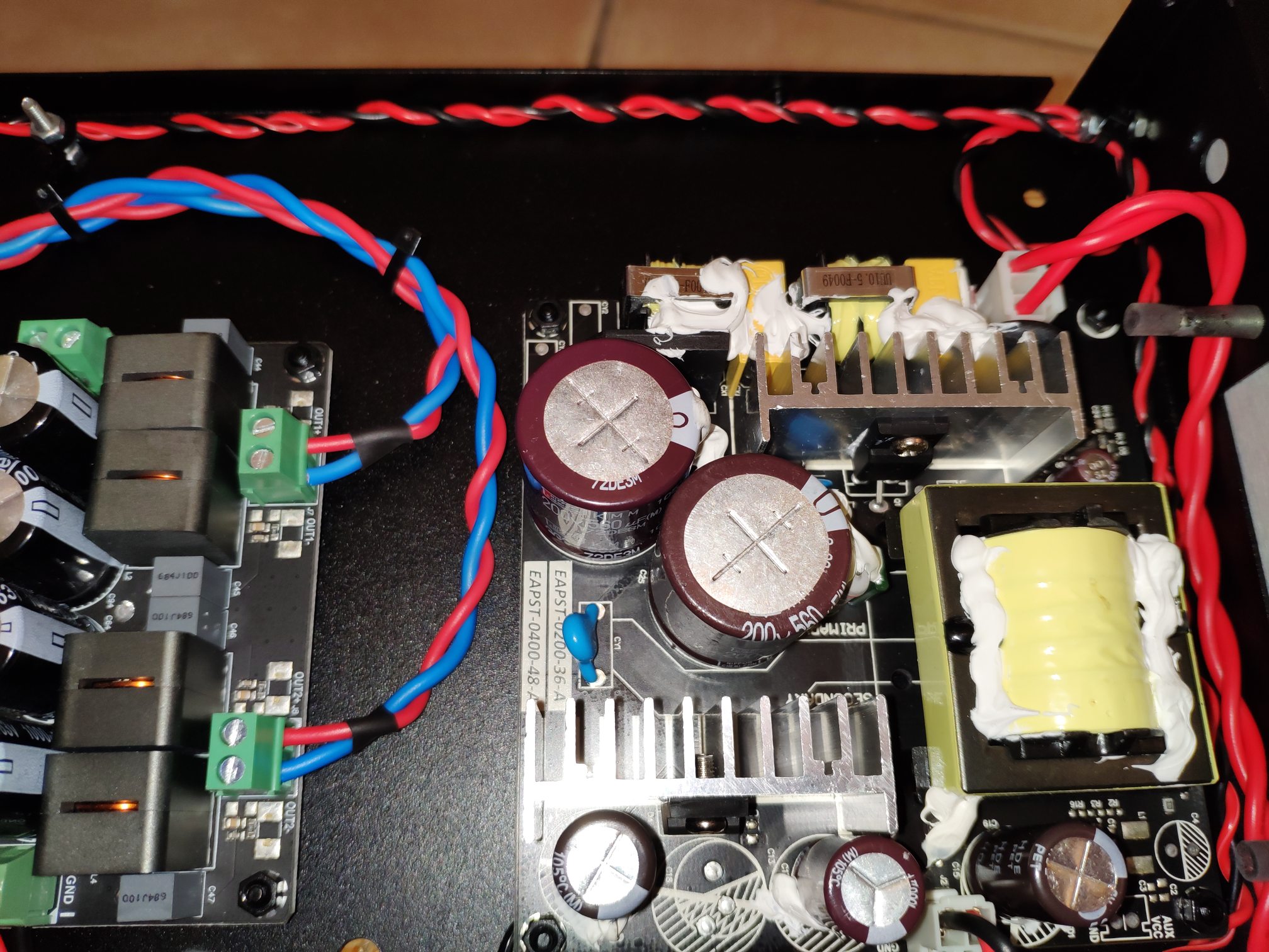

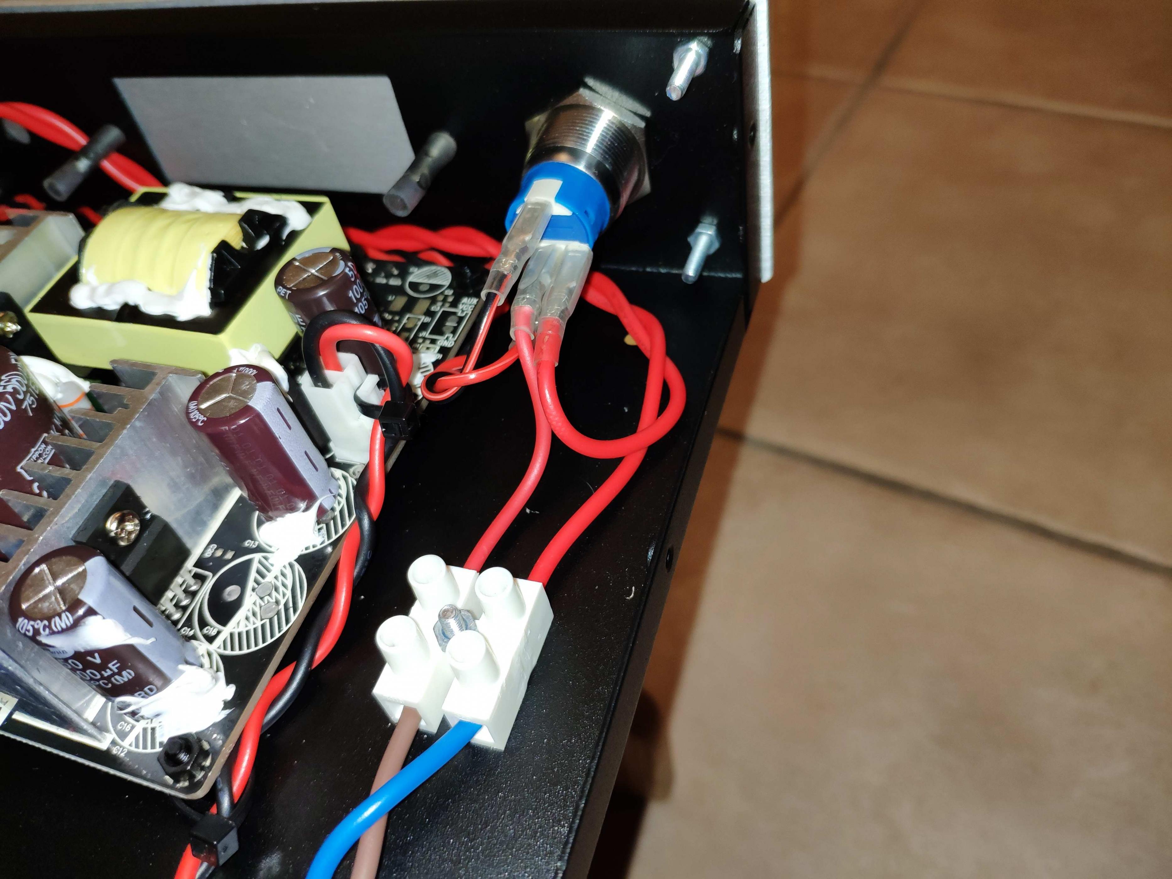

I just finished my build. I'm satisfied by the result, but if I had evaluated the layout better before, the solution would have been much more cleaner and the component distant from each other.

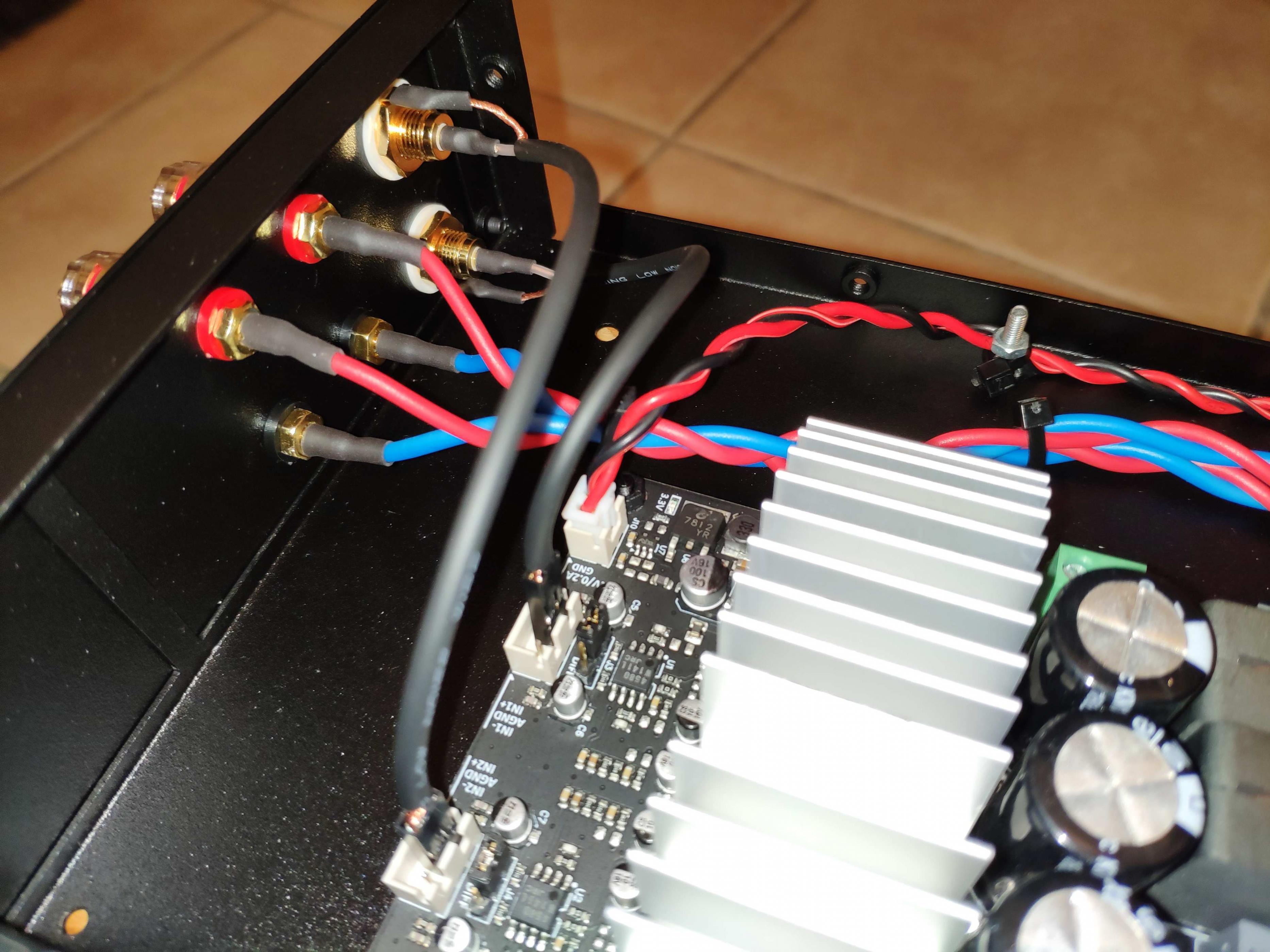

I used coax for line-in and twisted pairs for the speakers, but there's a light hum when i tend over the speakers.
Do you have any suggestion or do I have to live with it?

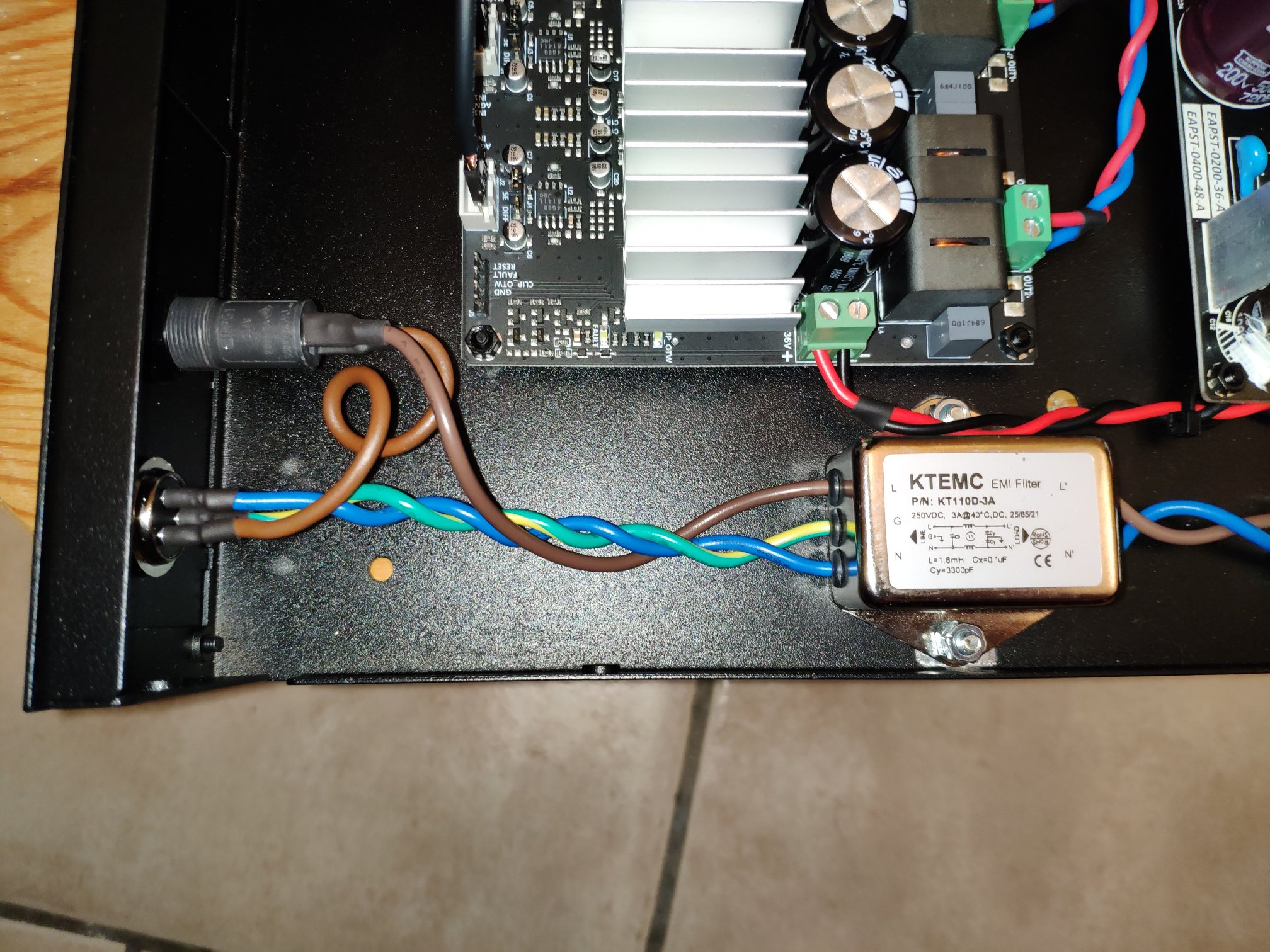

The small EMC filter casing is electrically connected to chassis?
The amplifier board signal ground is electrically connected to chassis?
You have tried to dismount the amplifier board and move it away (upwards on the photo) from the EMC filter?
The filter casing is grounded so I scratched the chassis and i fixed the filter on it.
The amplifier board is installed on plastic spacers and the line-in too, so the ground is not connected to the chassis. Do you think I should connect the return of the rca connectors to the chassis?
No i didn't move the board. I will try to do it.

Did you try to connect the not used input pins to GND?
The board seems to be with balanced inputs, but you use unbalanced cables.
Yes, the board has two jumpers that let you choose single-ended or balanced connections, shorting - and GND.

Have you checked that the RCA sockets and Speaker sockets isolated from the case? I have had it where the plastic isolating washers are not deep enough to cover the whole of mounting hole in the case. I wrap insulating tape around the threads and this makes an interference free connection. Use the continuity bleeper on your DMM to check.

Yes, as Puffin suggests, make sure that the ground of the RCA connectors is connected to chassis. This way the signal ground is connected to chassis.

Thanks Puffin, luckily this part was ok
That was it! The spacer holes are grounded, if I used brass spacers I wouldn't have any problem. I just wired a cable from the chassis to a ground point of the board and the noise disappeared.
