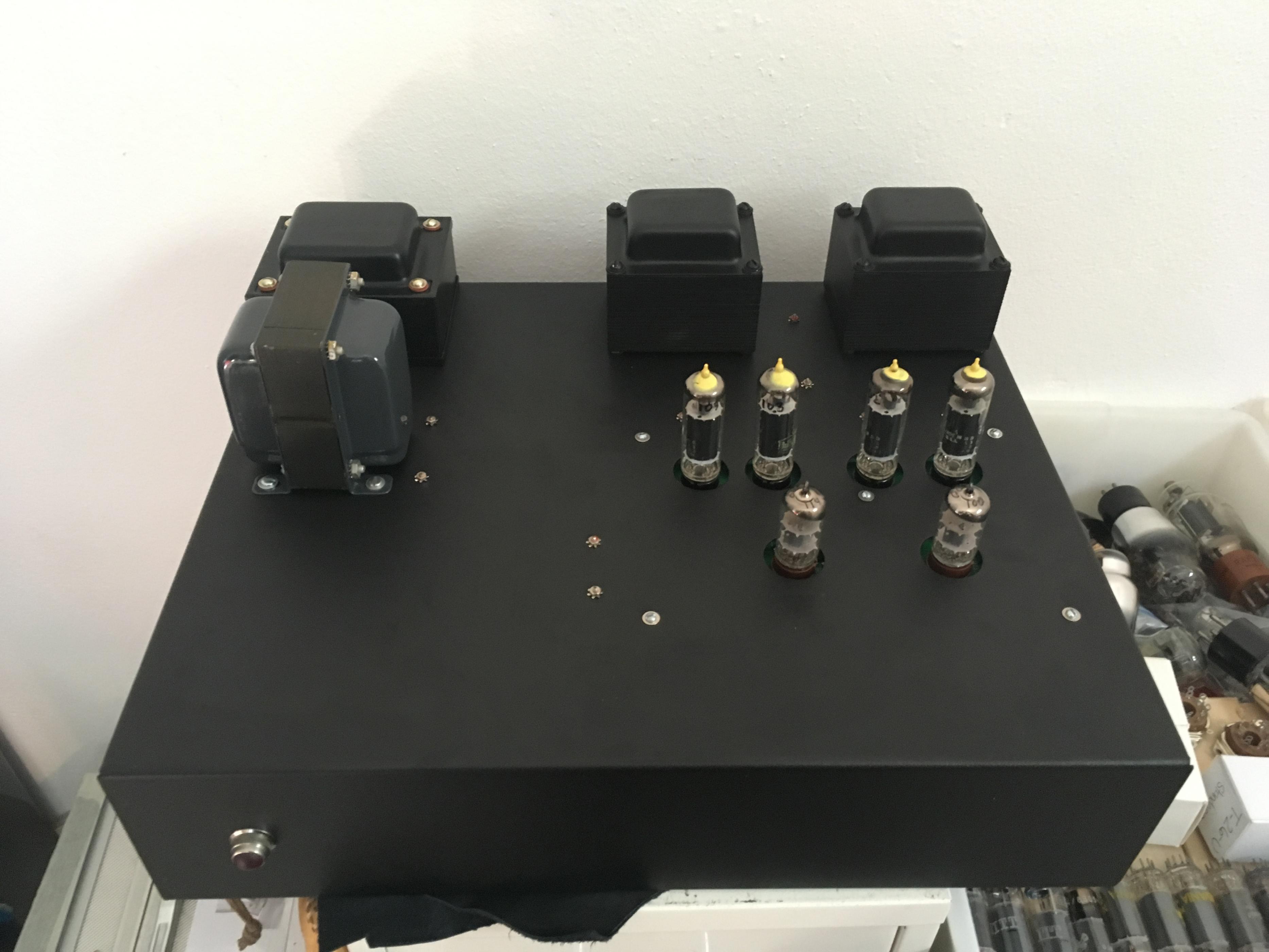

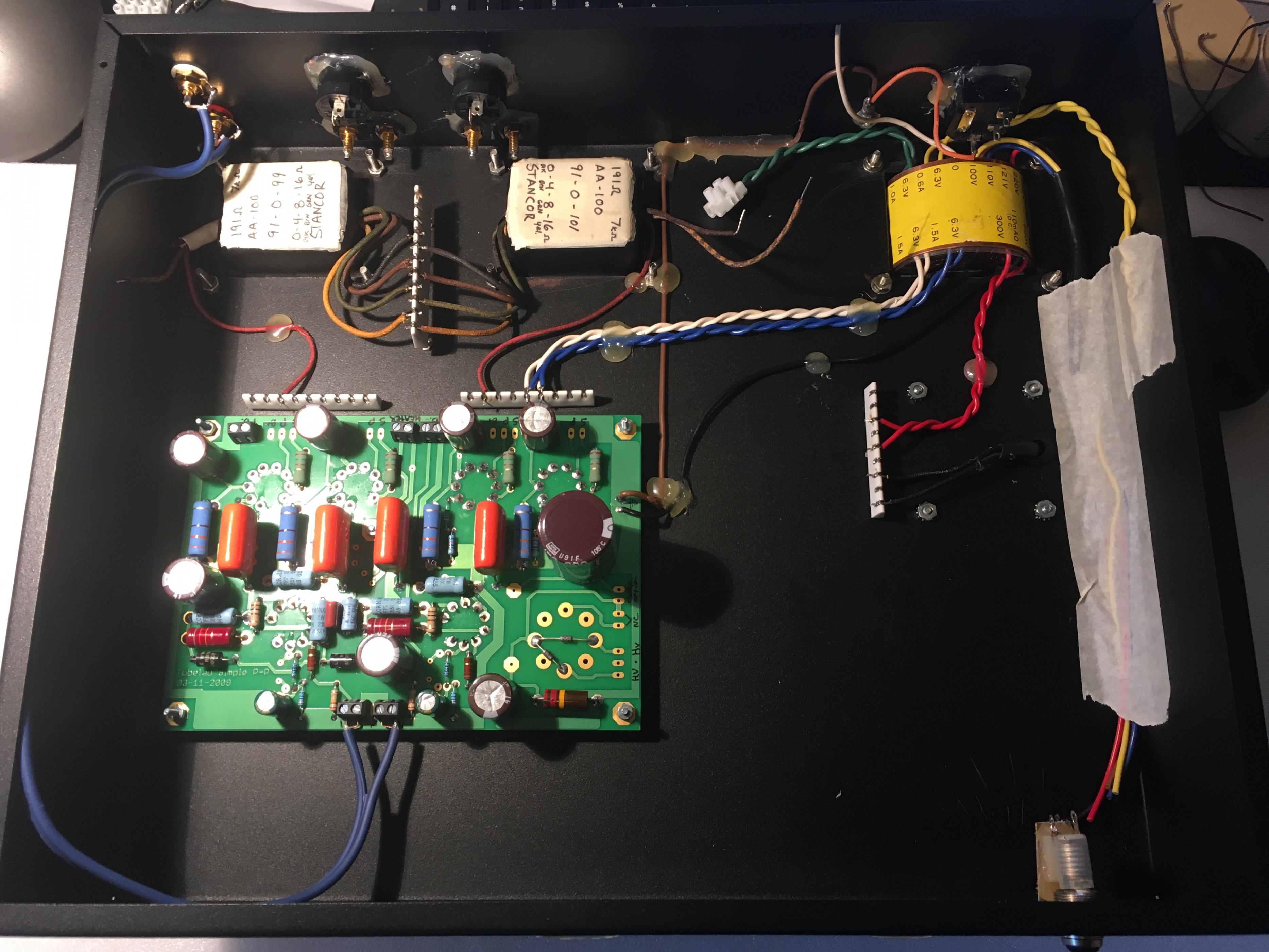

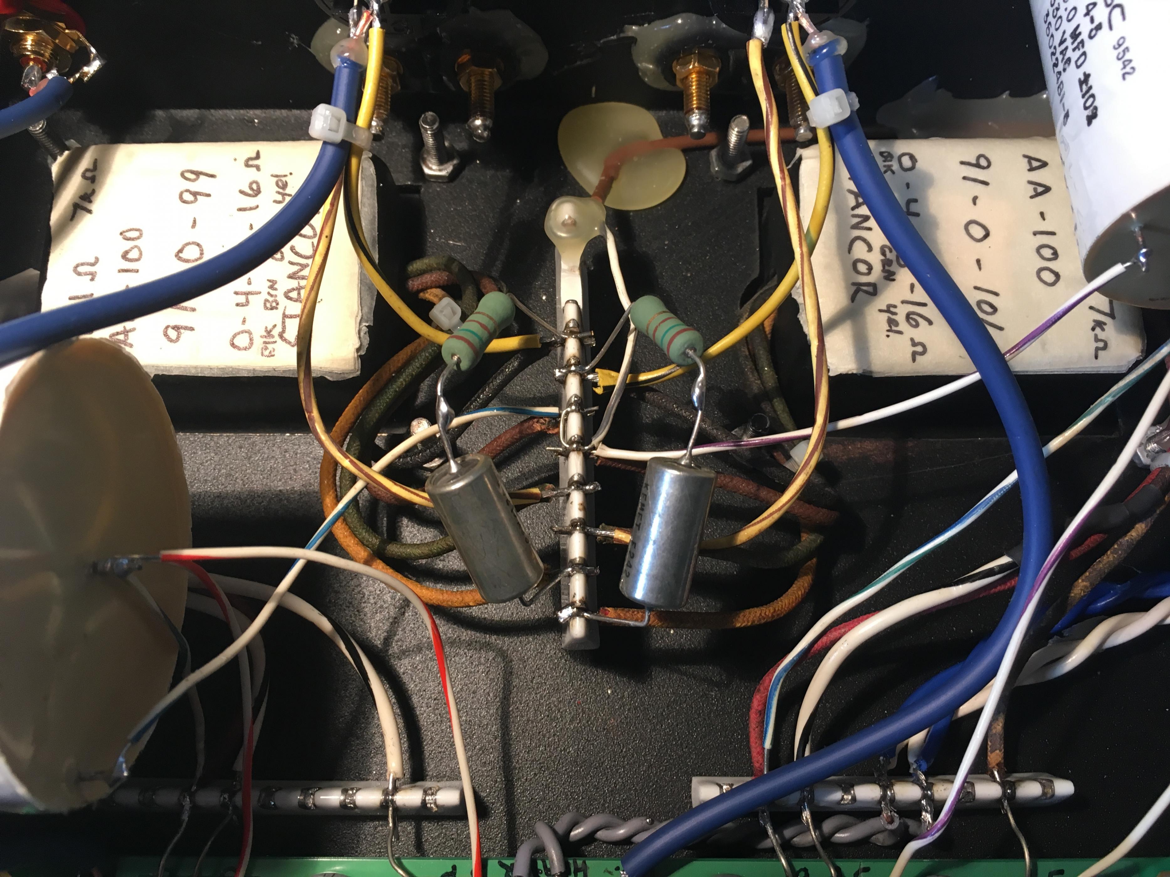

Working on my second simple pp! The first one was set up in triode mode and this one will have pentode outputs with a regulated screen supply.
I am thinking a pair of stacked glowtubes would suffice for a screen supply and look pretty...
The outputs are a pair from stancor out of a Heathkit AA-100 that are 7kpp with 0-4-8-16 secondaries.
Its coming along...
Its coming along...

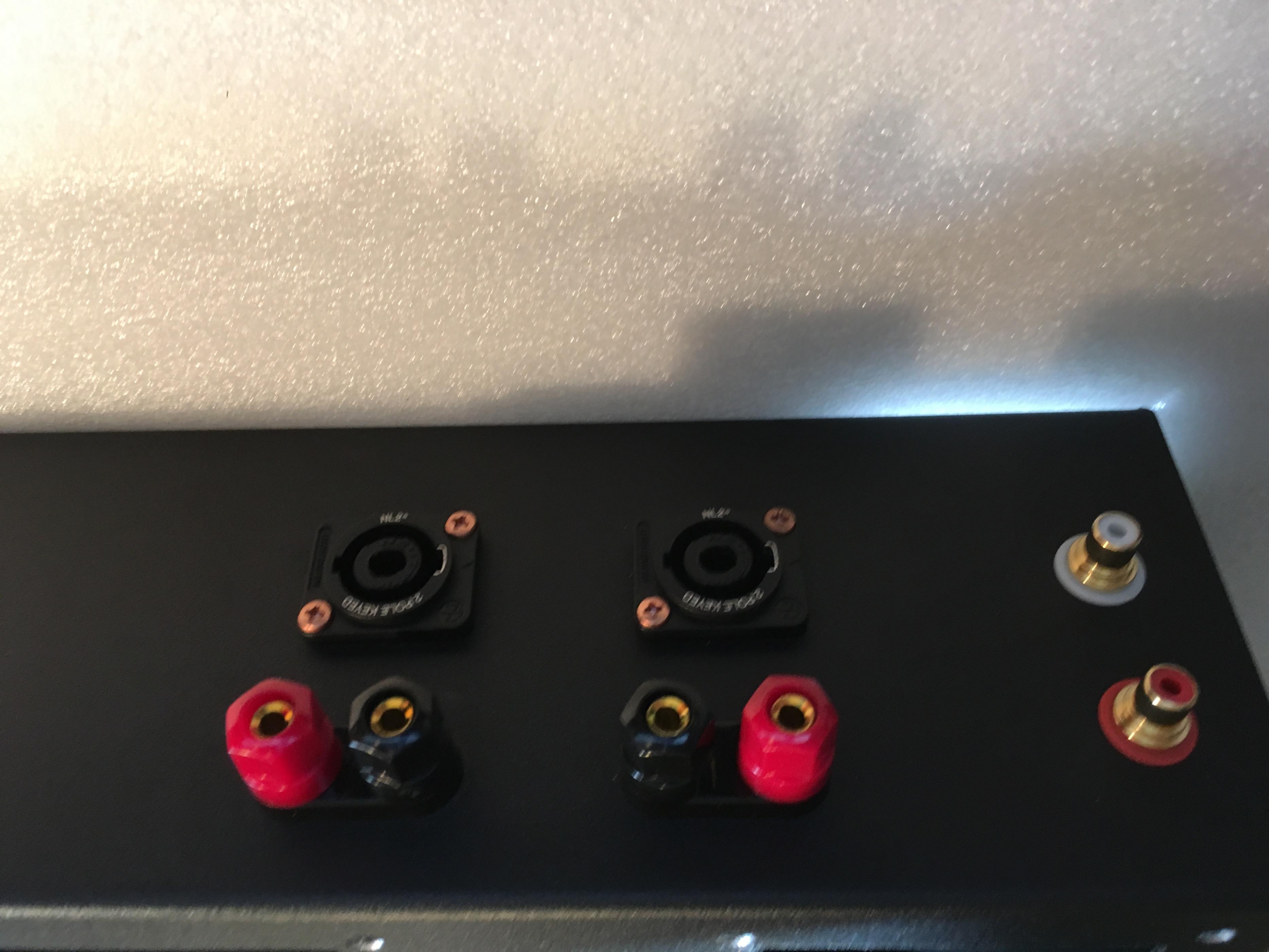

Being ignorant here, but what are the black sockets above the speaker terminals? I had assumed fuses.
If they are not fuses, does anyone bother to protect their speakers? I have 5 fuses in My SPP, 1 on the live in, 2 on the seondaries, and both speaker positives.
They are the neutrik speaker connectors. I love them! It’s pretty much all that I use these days. I just put binding posts posts on there, in case I have some random speakers I want to try out, they don’t have my cables on them already. I only fuse the primary. In my opinion there’s no need to fuse the speaker outputs, you already have galvanic isolation because of the output transformer. If the secondary of the output transformer is properly grounded, there’s nothing really that can happen. I’ll post some more pictures today when I get back home, right now I’m doing a tour of the new train tunnel being built in Semmering, Austria 🙂

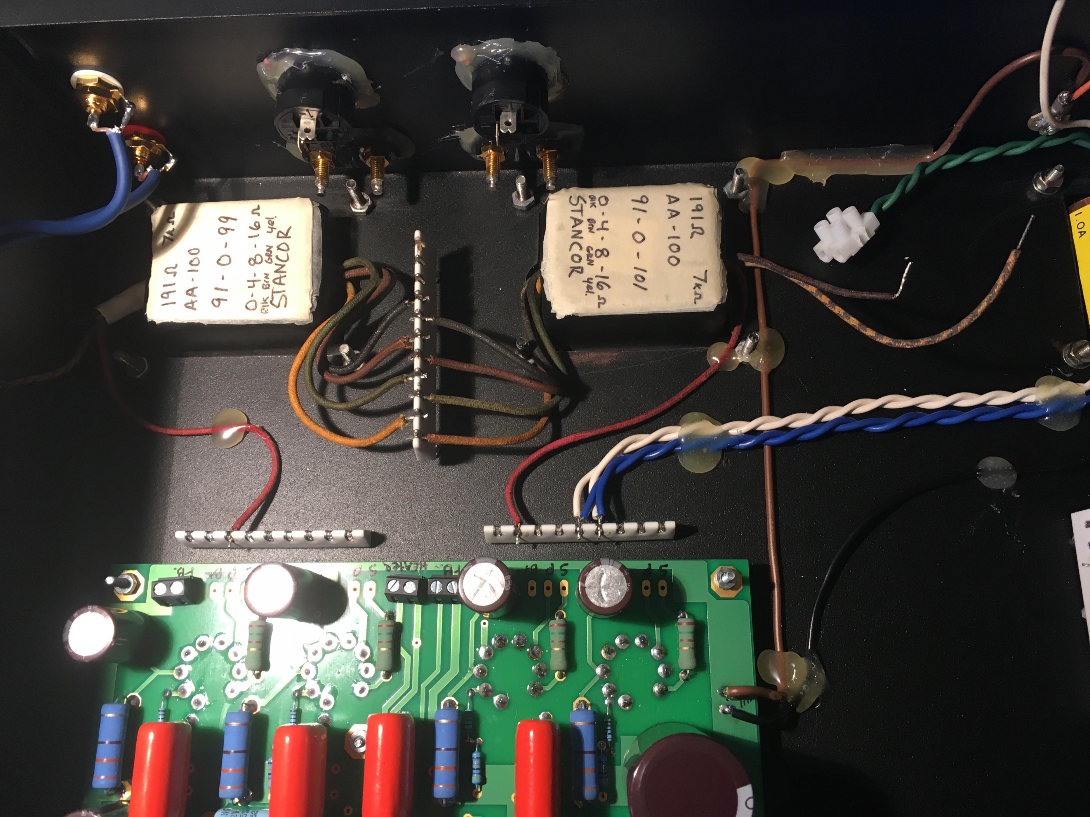

Made some progress!
I have tested everything out and it sounds great!
B+ is around 325, which is about perfect. I have the screens connected to the film caps at the moment.

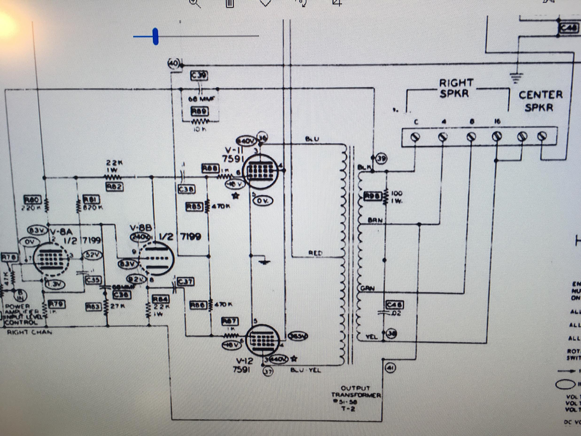

I have snubbers on the secondary of the output transformers, and I have them wired like they were in the original amp (Heathkit AA-100) with the 4-ohm tap grounded and the feedback taken from the 0-ohm tap.

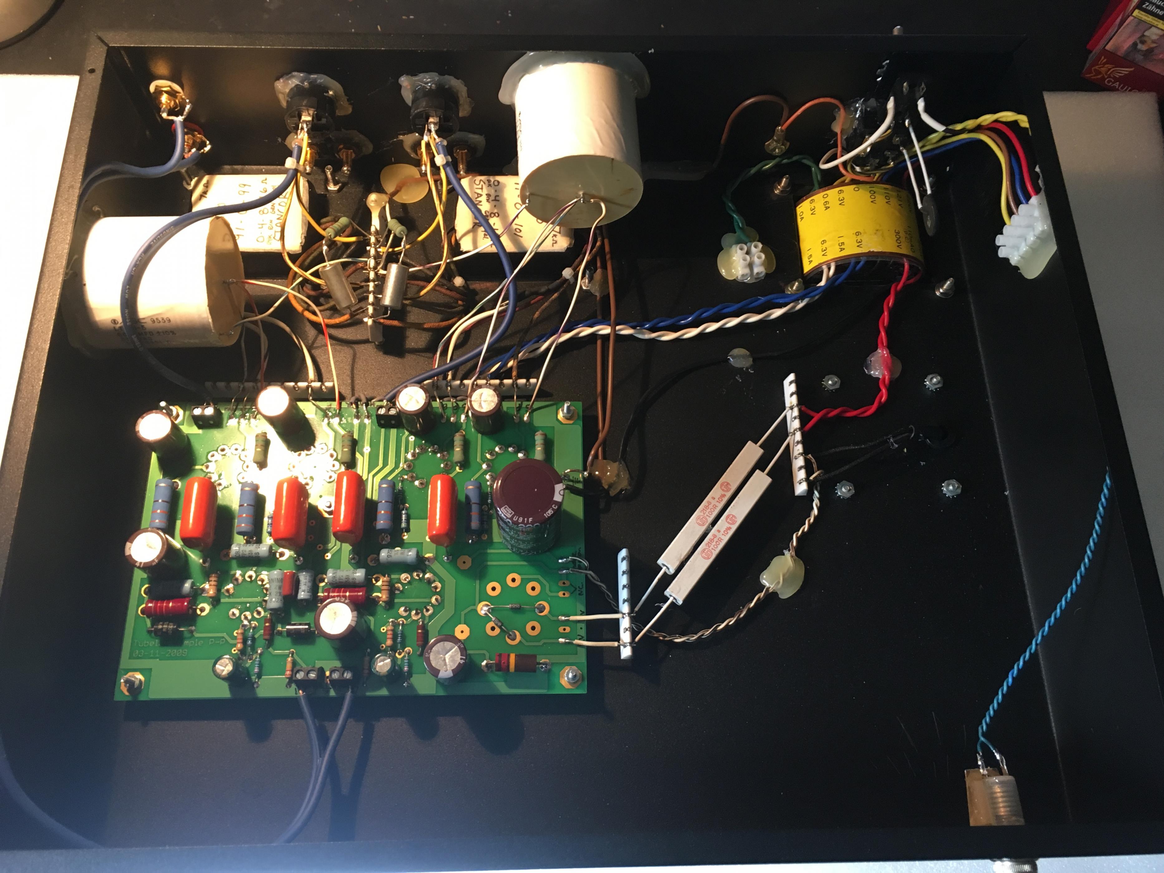

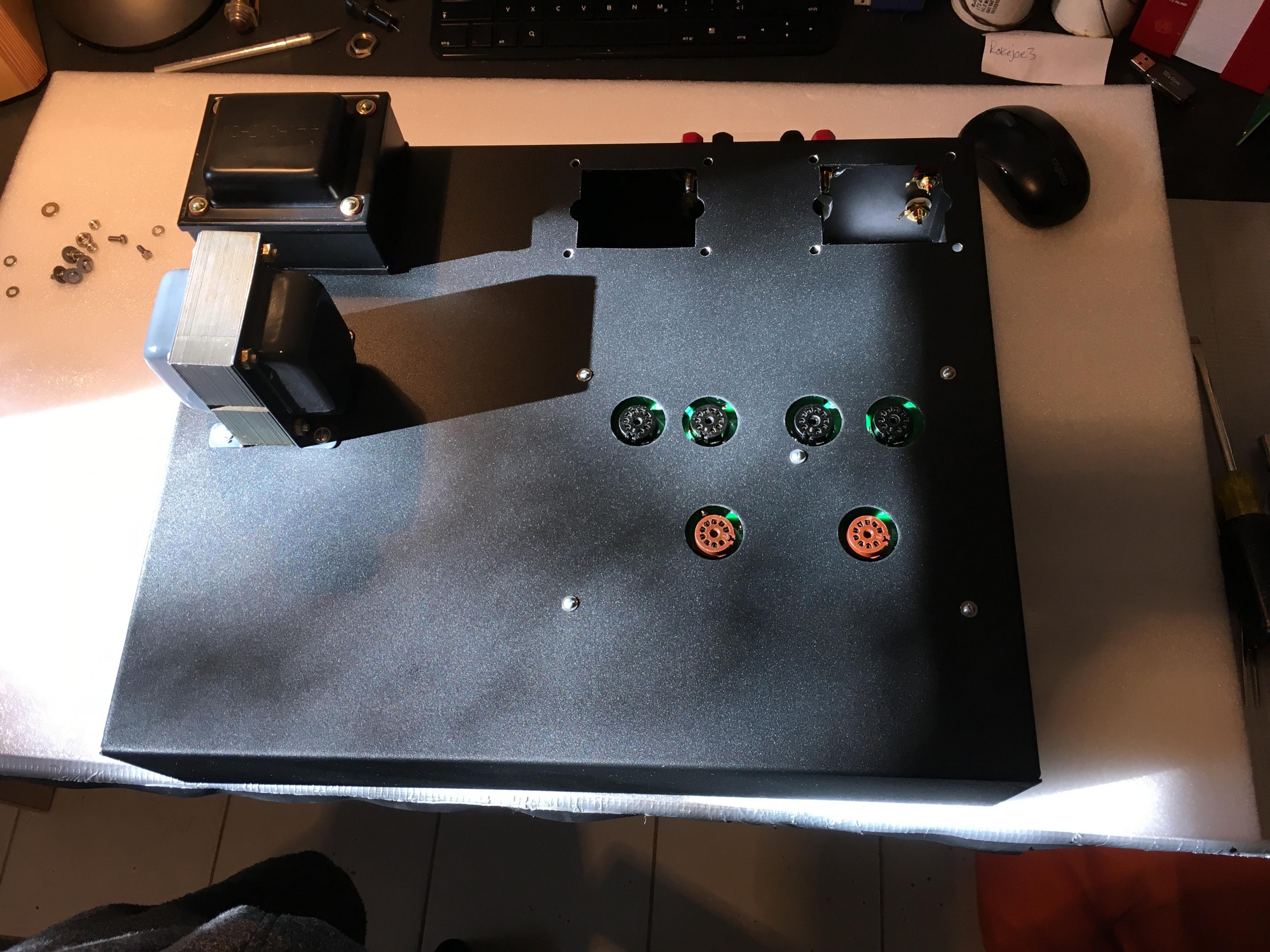

Well I have decided to go for it!
I am punching the holes for the 2 octal sockets tonight and will try the Gas tube regulation for the output screens.
So I will basically end up with 345v on the plates and either 300v or 240v on the screens.
The amp sounds great as it is but I thinke a lower, regulated voltage for the screens will contribute to a longer, happier life for the output tubes....

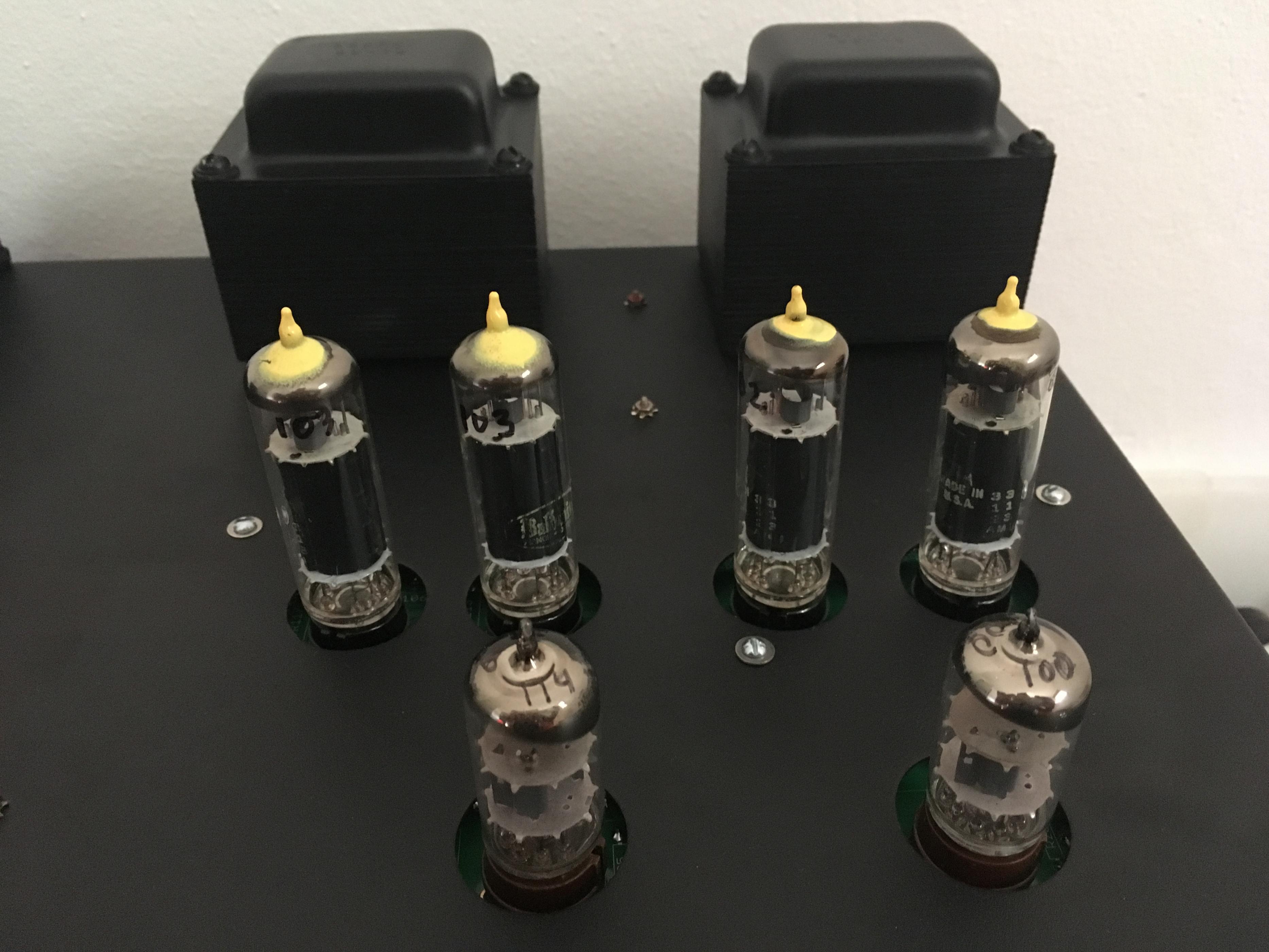

Well I have installed the 2 gas tubes. The b+ is now 365 and the screens at 300v.
I have changed the feedback resistor to 4k7 and the things sounds amaying!
The impression is that it has gobs of power and it has no trouble driving my somewhat low sensitivity SEAS L17 speakers.
Also sounds great on my Fostex FF225WK 2-ways with neoCD3 ribbon tweeters.

George, how much feedback (db) does the amp have with the stock values in the schematic?.....Anyone know the db amount with the stock values? George?
The feedback varies greatly with the OPT being used. Unfortunately much of the information I had on the SPP was lost when my computers and other stuff (including the original TSE amp) was flooded during a hurricane. This happened during the development of the SPP, and is why some of the build information is still missing.
I remember a value of about 8 db sounded the best to me with my speakers, but I was using 6600 ohm OPT's because I had, and still have lots of them.
Is there a good way (or ANY way) to check for stability without a scope?
Unless the OPT is really bad, and mine were repurposed guitar amp transformers, the amp will be stable. Lacking a scope the capacitor value in the feedback path can be tweaked by tuning for the best sound on signals with broad high frequency content like cymbals. Tune for the most natural sound. You are trying to balance the high frequency response with the rest of the amp.

One other thing, I have only .86v at the cathode of the input triode of the 12AT7s. Is this normal or am I looking for more like 1-2 volts there?

Got everything up and running with the gas reg tubes. sounds fantastic and all of the voltages check out now.
I am still curious about the low cathode voltage on the input triode - 12AT7.
Is this normal and a part of the design or should I be looking for more negative voltage on the cathode.😕
