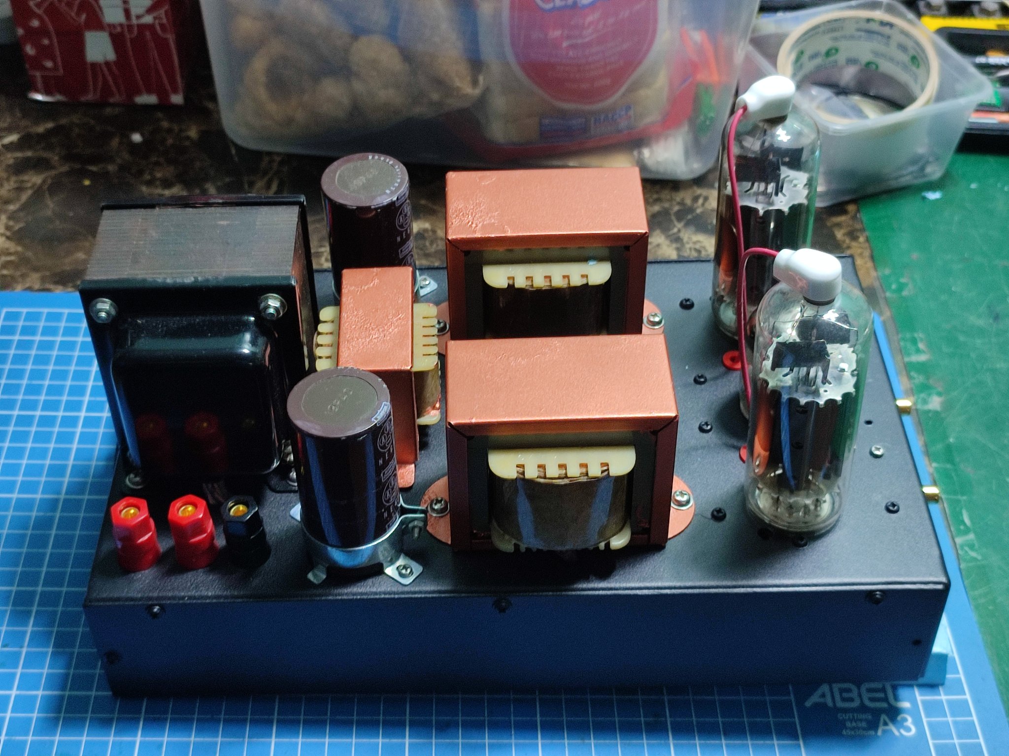

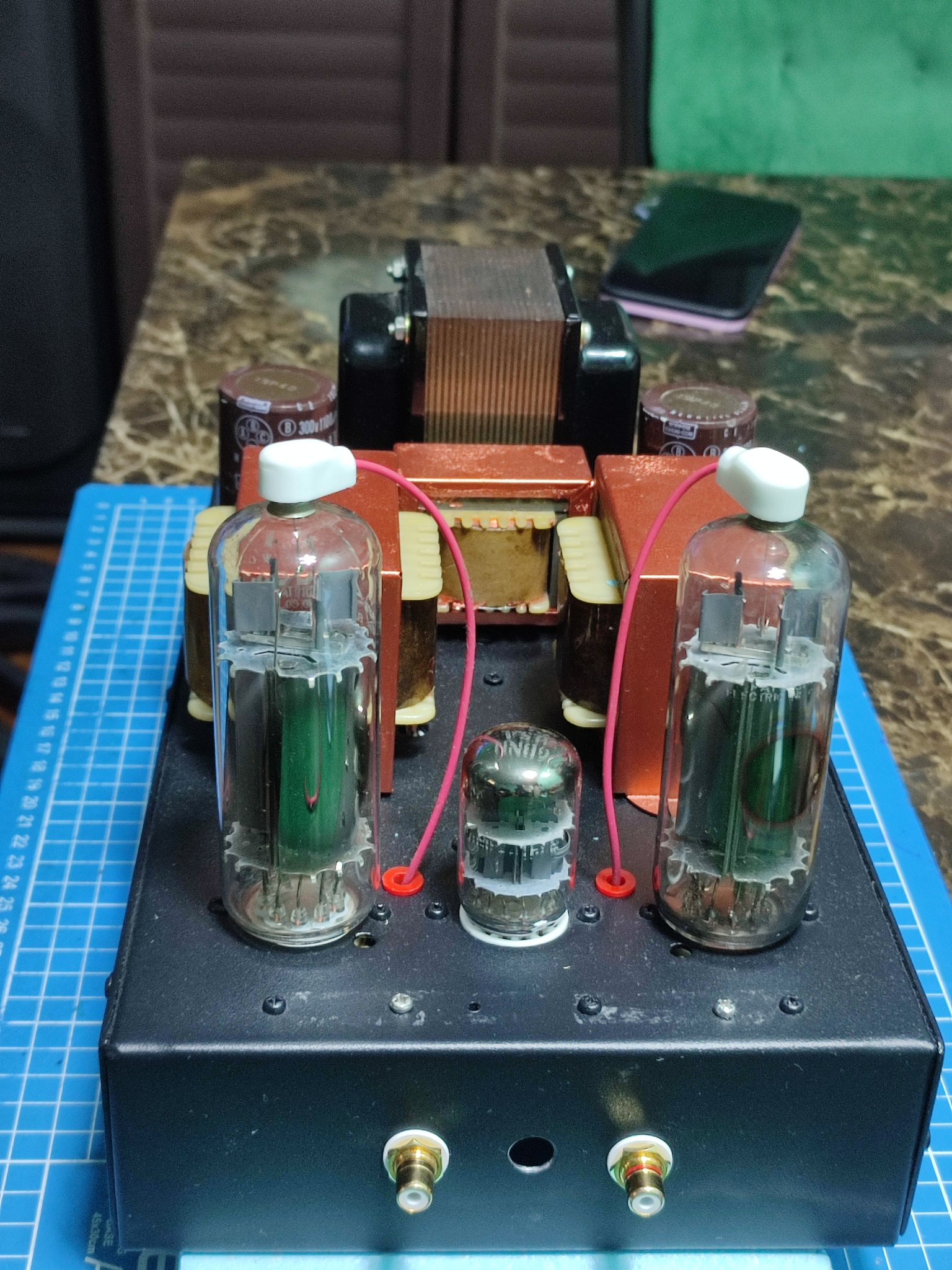

I have two DIY SE tube amps I built. One with 6V6 tubes and the other EL84. Both are strapped as triodes. I prefer the triode sound to pentode wired and don't need the extra couple watts. I have tried to listen to them with no NFB but they sound a bit too harsh and aggressive through Klipsch Forte's without some global NFB using a 10K resistor. I read about similar amps with no NFB and how great they sound. So please fill me in on what could be going on.

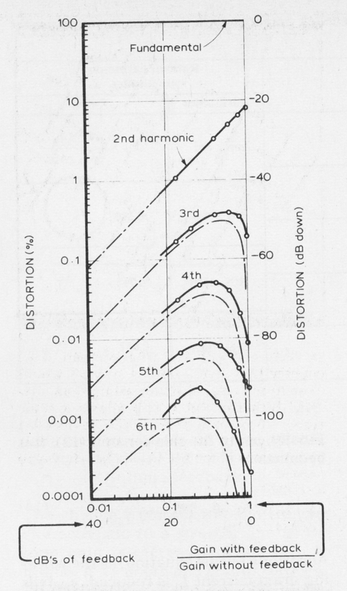

17dB of fb in a tube amp like this is about as bad as you can make it.
That can't sound good.

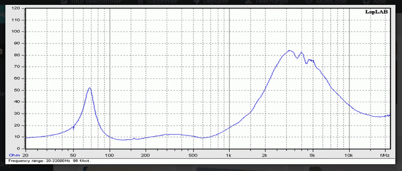

Easy : your Klipsch Forte - as many Klipsch speakers - has certainly a very tormented impedance curve... See my Heresy I original Z curve below, as an illustration, where you can see a large hump in the 3K-5K region :
Given that you amp has no FB, it offers very poor damping (usually less than 1). So in the case of my Heresy I, it resulted in a barking, in-your-face tone. If you have harshness with your Forte, it is possibly because the hump is also high and placed more in the treble region.
Check with a modern SS amp, offering good FB (usually over 30-40) : the harshness should cease, the damping offered by the amp "tames" the hi-mid / treble hump of the Z curve.

@tubelectron That makes sense. Both amps sound good with the feedback applied as you see in the two schematics. No Klipsch harshness whatsoever which people complain about. Wiithout NFB not so good. I suspected it could be a speaker issue.

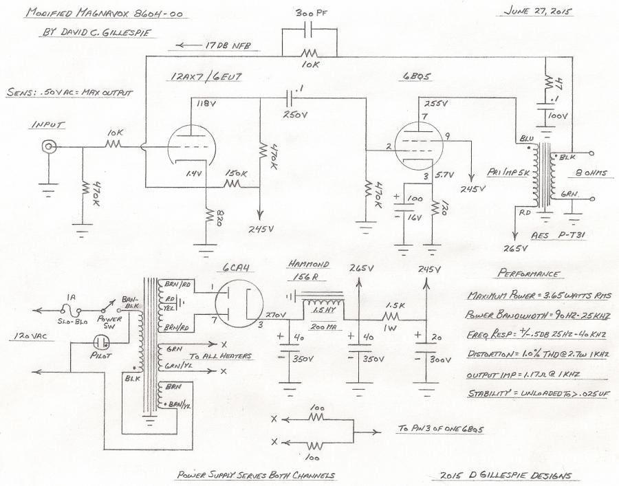

Dave Gillespie is no slouch and that's a very carefully-designed circuit. He never modifies or designs anything that doesn't measure beautifully. Changing it to triode mode probably reduces the feedback and degrades the sound to some extent. Removing the feedback will only make that worse.
No-feedback amps typically use low-mu, low-impedance output tubes like a 2a3 or 300B. This amp is designed for a pentode and as such requires feedback in the design.

Who said anything about his personality? He's a very skilled modifier and designer, to a limited extent. The amps he modifies or designs measure extremely well and are extremely stable. If you remove the feedback from that particular design it will not perform anywhere near as well. I'm not surprised that it sounds bad without it.
Whatever modifications are made to that amp may or may not not work as well with that particular output transformer. But it won't hurt anything to try. My guess is that returning to the original as designed will yield the best results.
