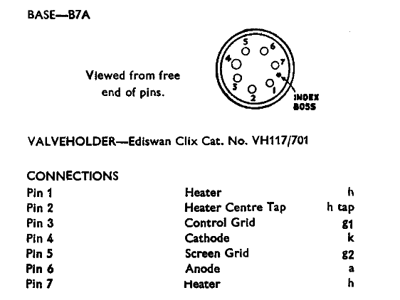

A 13E1 has two parallel cathode-grid structures, so in that sense there are two output valves after all 😉

There is only 1 Plate connection pin.
There is only 1 Cathode connection pin (they are internally connected in parallel).
That means there is only one output terminal . . . either the plate, or the cathode.

There are 2 separate control grids.
If they are driven with separate signals, that Makes a good Power Mixer.

Indeed Marcel, just like the other tube popular in this scenario, the 6C33C, but also like that tube you can only use it as a 'single' tube.
I don't think you can, because like the cathode and anode, the control grids are internally connected. The two internal beam tetrodes are really completely in parallel.
