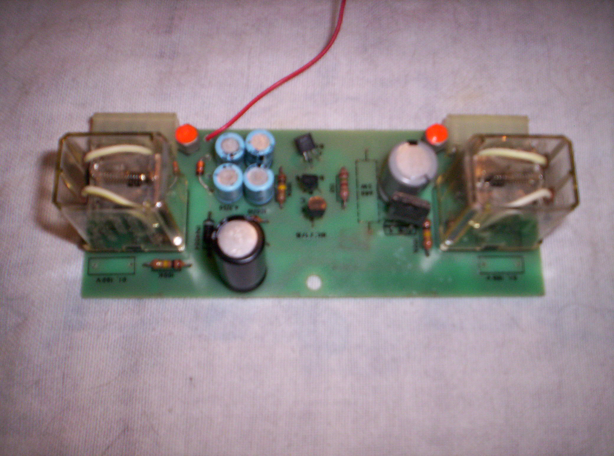

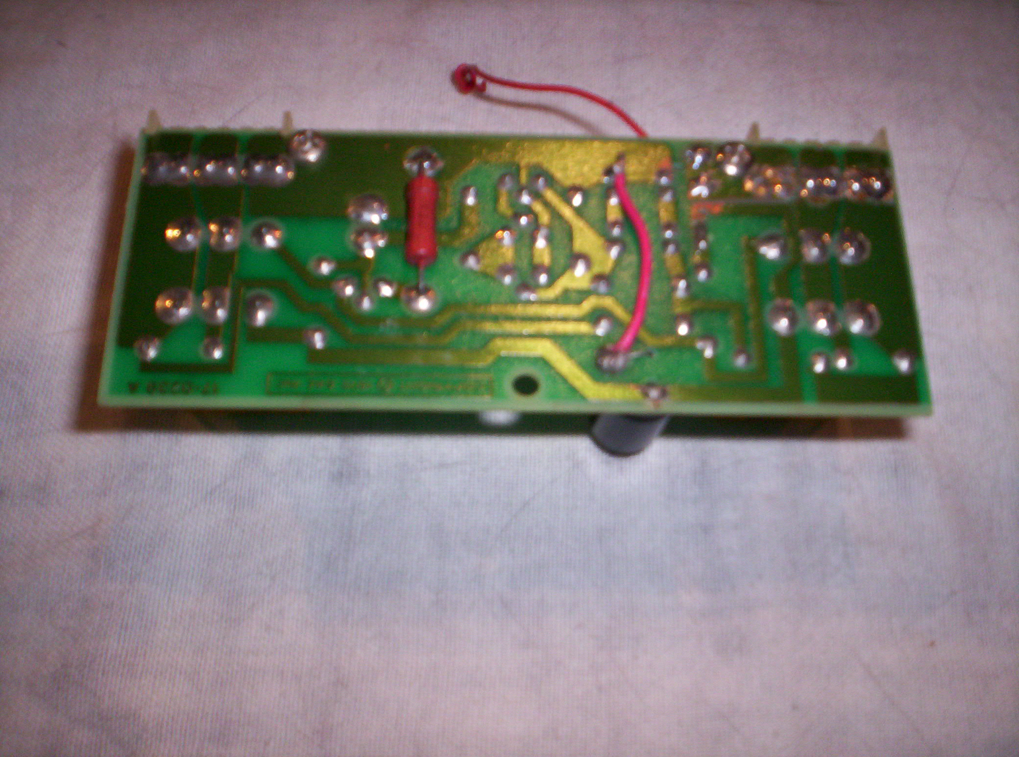

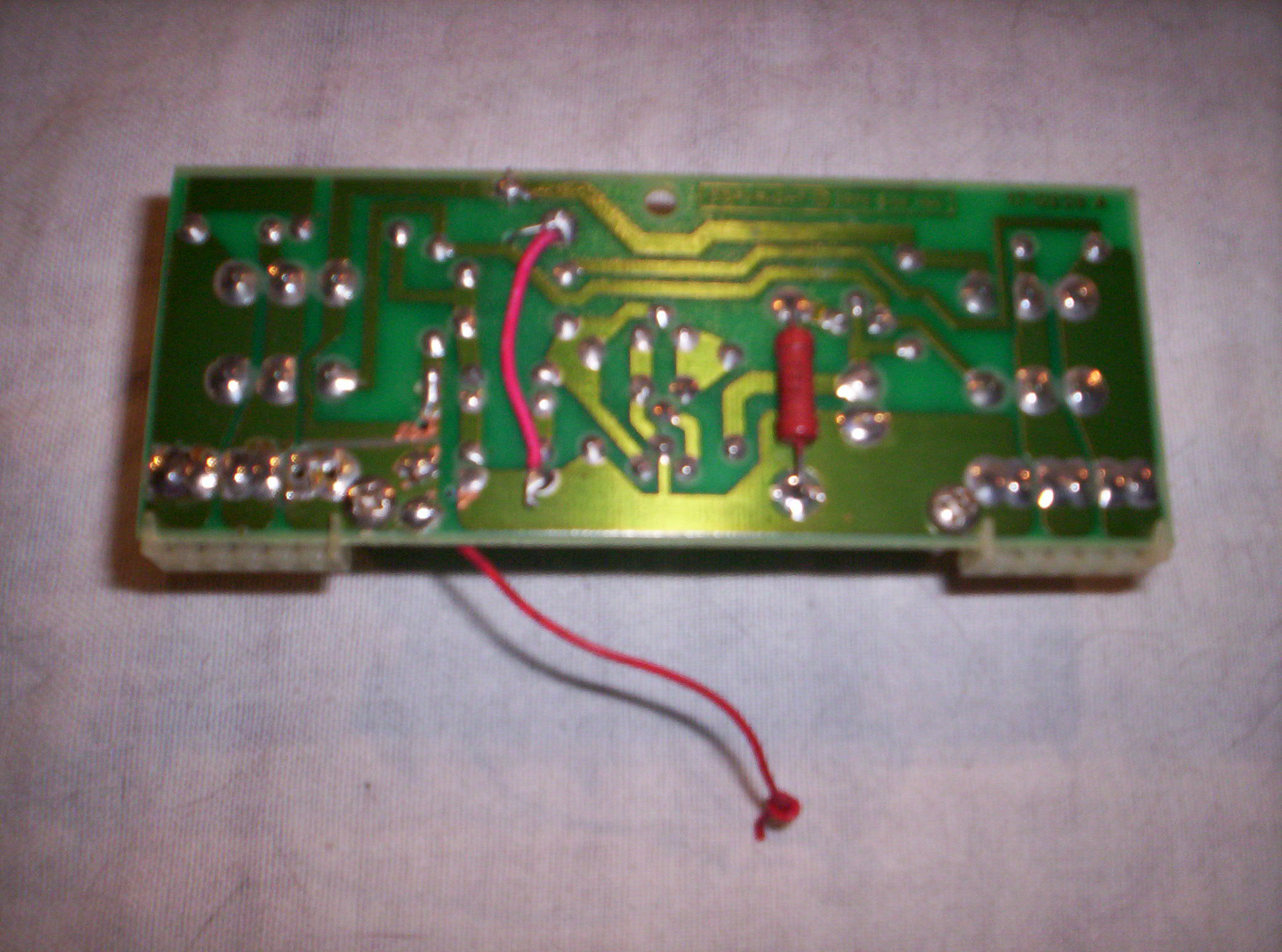

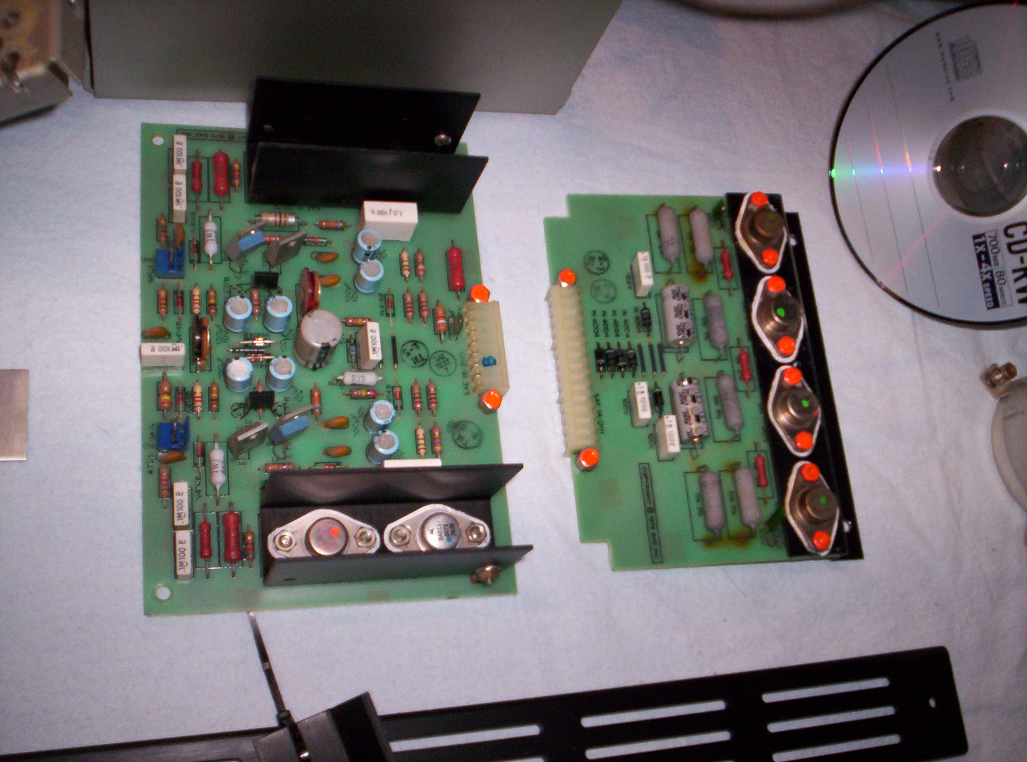

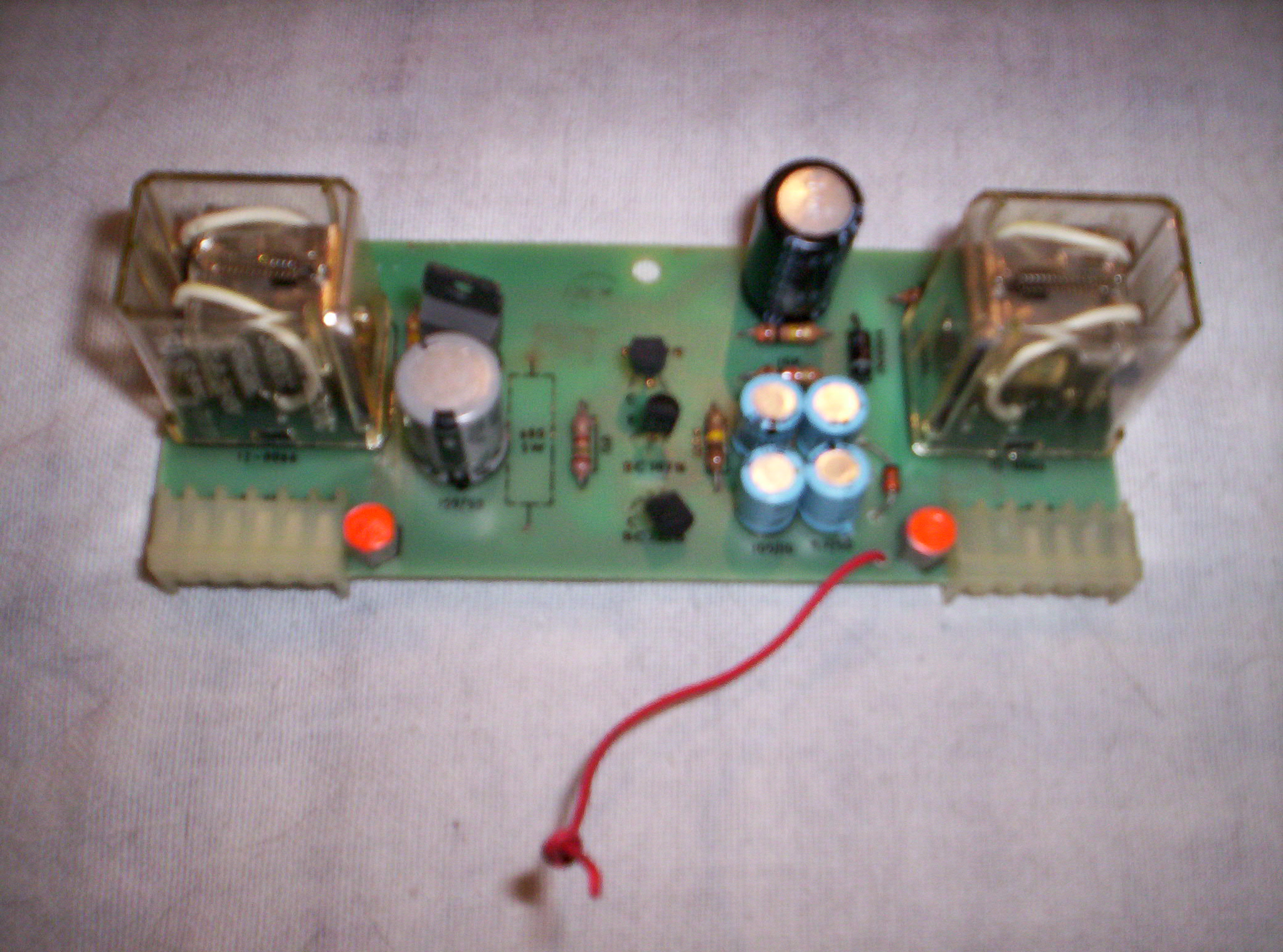

So far, i found one blown fuse on the - side... The protection circuit has been modified, probably for the known PUP, too slow opening of the relays?.
The tech removed 2 pins (the ones closest to the 4 caps).
He added a 10uf 250v cap, a diode and a jumper (red) under the board.
There also is a red wire that enters the board, that's connected to one AC terminal on the rectifier...
I took the covers off the relays, cleaned the contacts (they were very slightly pitted). Did not test the relays coils yet, will do.
One of the BC307B transistors on the main board is acting, i plan on changing all six. (i tested them in circuit with a diode test multimeter).
All of the outputs are original SAE marked 11-0068 and 11-0074 and all test good on the multimeter.
On the pre-driver boards, there is a pair of SAE, one Motorola and one RCA on each, and the driver boards, one channel has 4 RCA's and the other board has 4 SAE,s, all of those in TO-66.
I will order all the caps for it except for the PSU ones for now, recap it and reassemble it and dim bulb test. Will change the 4 trim pots for Bourns too.
I did not check how i'll be able to adjust the 2 pots on the main board tho?.
It doesn't look like it's feasable without major thinking!?.
Here's the protection board picts:

The relay board definitely has the mod to improve the relay. This amp is notorious for quick turn on and very slow turn off.

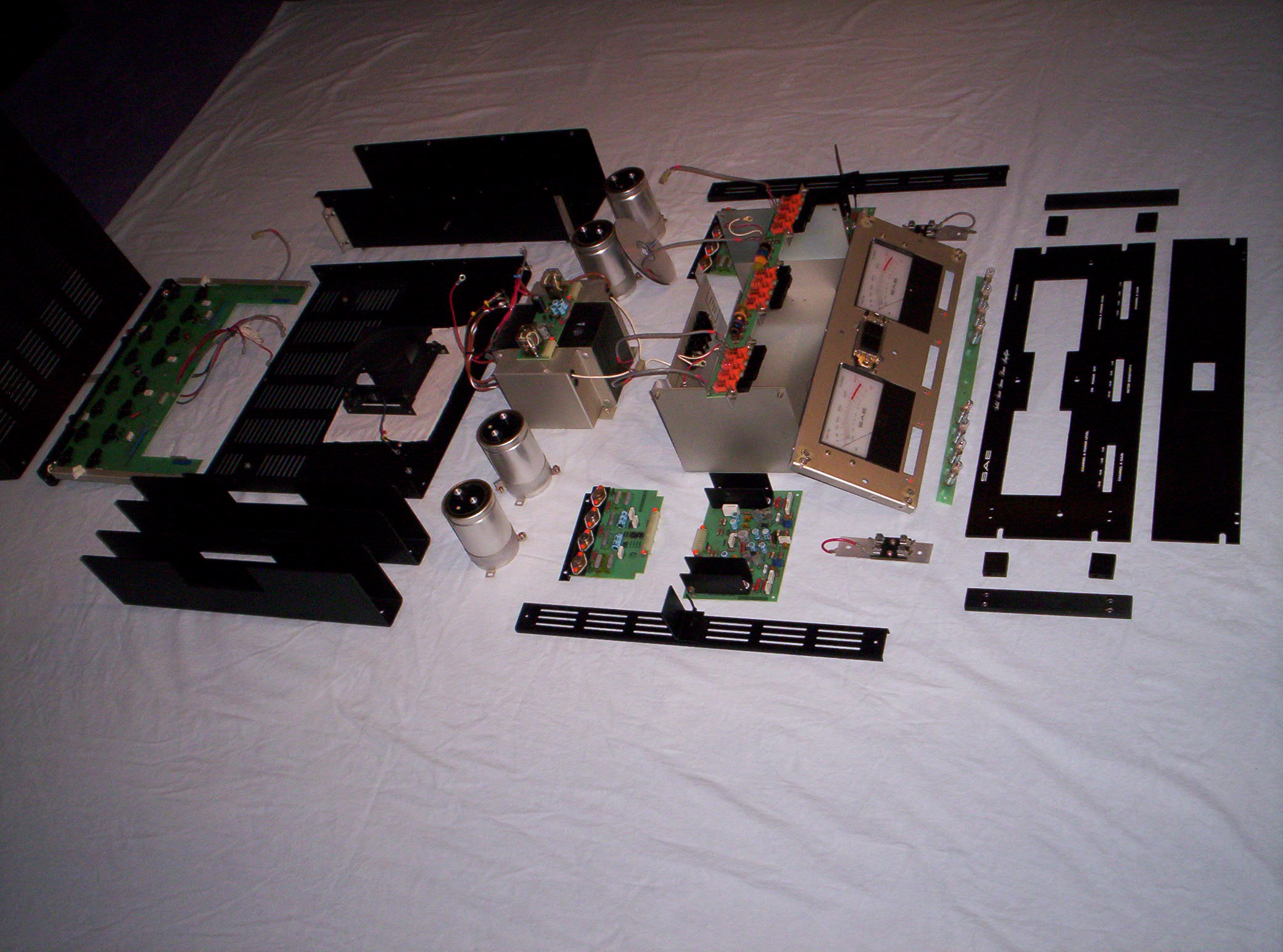

I'm searching for a SAE 2600 complete service manual.
I dismounted one but I forgot the location of screws and spacers.😡
I can not find pictures to help me for winding.
Have you got an exploded view or a complete service manual with all parts listing and view?
Best regards
Best regards
In my experience none of the SAE manuals were that complete. I've never seen an exploded view of any SAE amp, just schematics, parts lists, adjustments, views of PCBs and maybe some circuit theory.

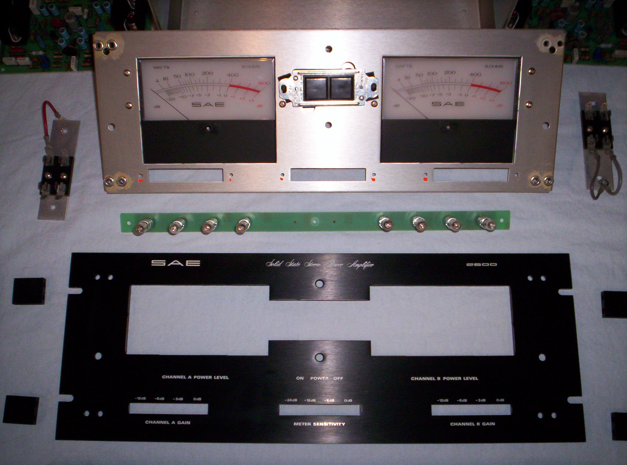

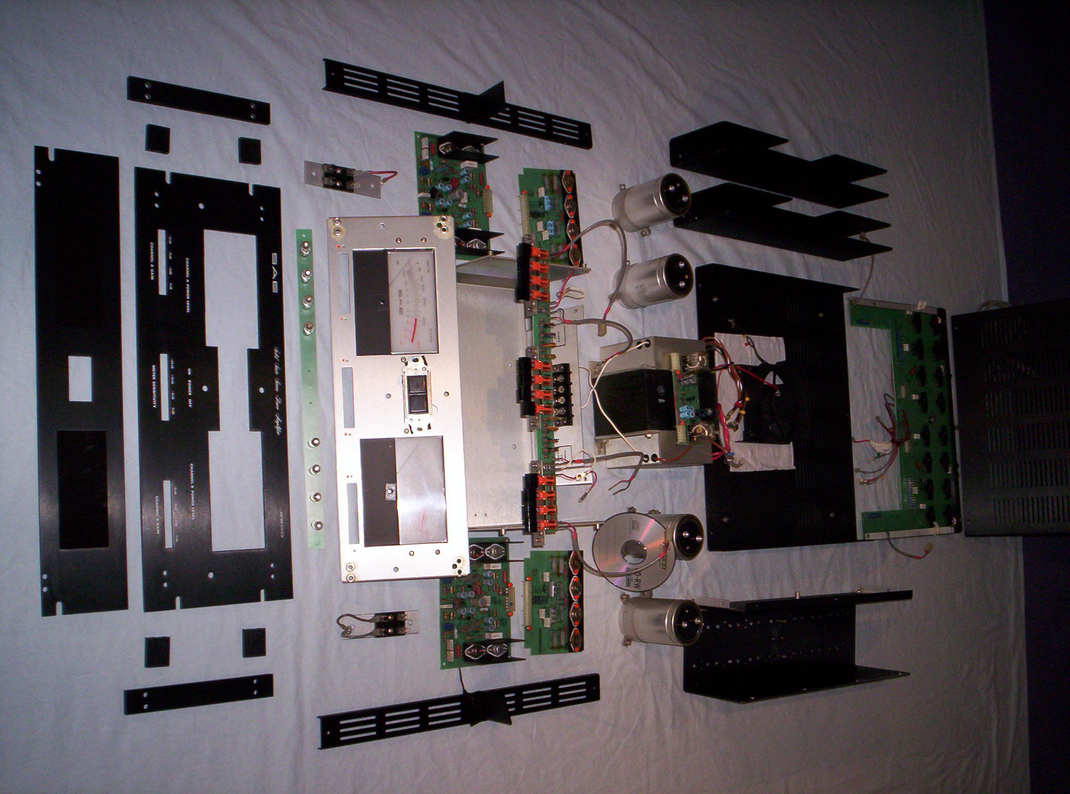

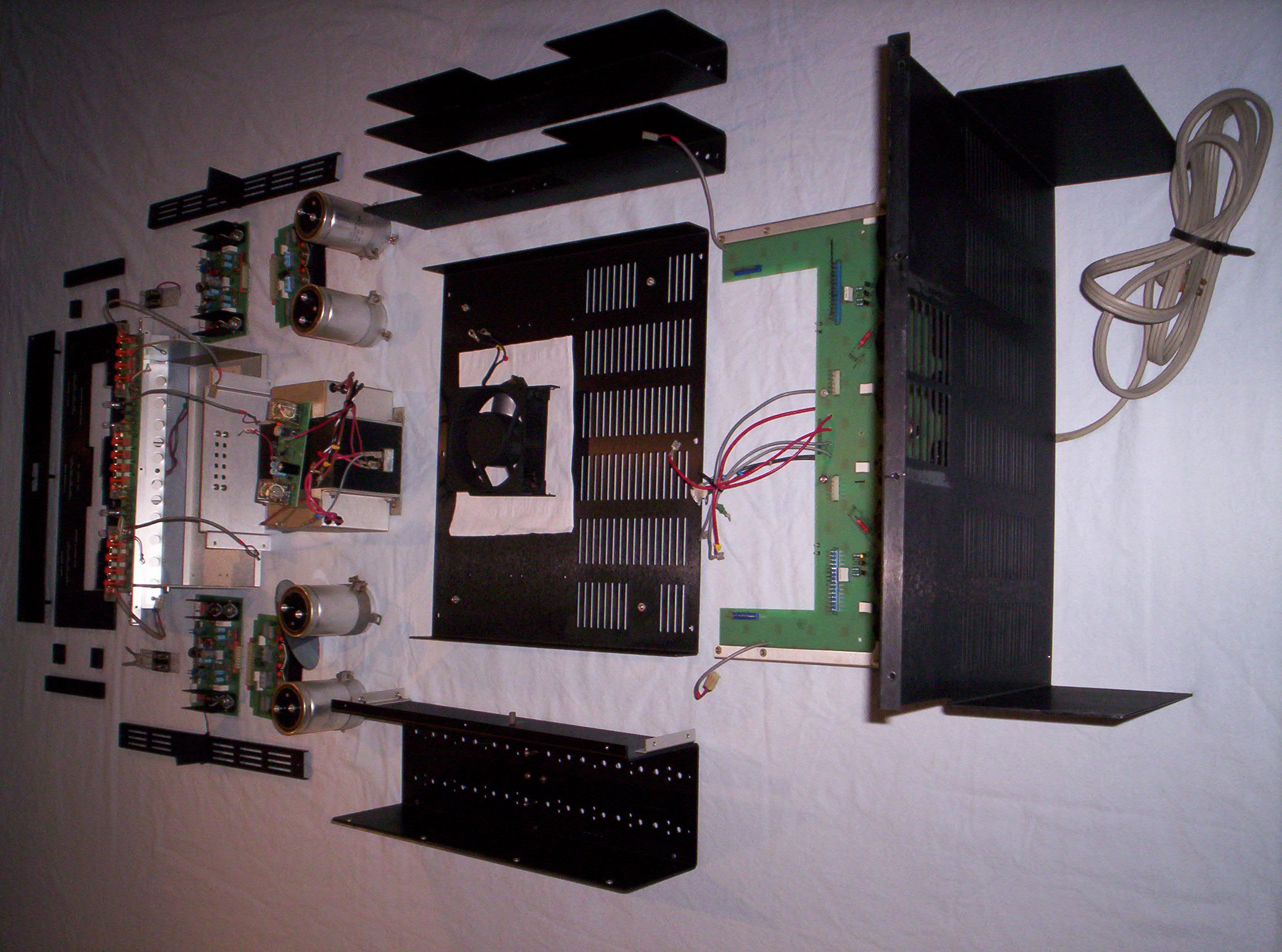

I just got a 2600 in for repair, what a mess. I hope somebody didn't quit their day job!!! It's fully exploded now, I don't there was one screw that was tight while I was exploding it. My Mouser shopping cart is going to be filled pretty well after I get done ordering parts for it. The only a major bummer is one bad filter capacitor, have to replace all four them now, 10,000uf @ 120VDC, not much to choose from these days. Fun, fun, fun!!!!!

- My new SAE 2600 power amp. Exploded
