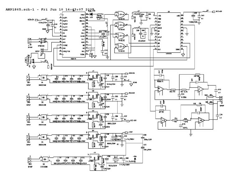

The AD1865NOSDAC, OUTPUT of my new design is an OPAMP
The TUBE edition of the ex- design of 1865 because the signal handle not good, I abandoned it, and afresh designed the OPAMP edition of 1865 NOSDAC.
Its LPF the part very is not good to do.
Now again my headache of is, if it want to hear to rise good to listen, then frequency demand from 14 KHZs start get downing, if to 20 KHZs start get downing, and that is what very not good to listen,
Part of and big contain good suggestion in the LPF?
I design the following diagram of the adjustment's LPF similar, this part of electric circuits spend me good long hours come adjusting to just do out.
