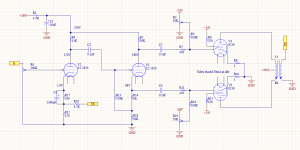

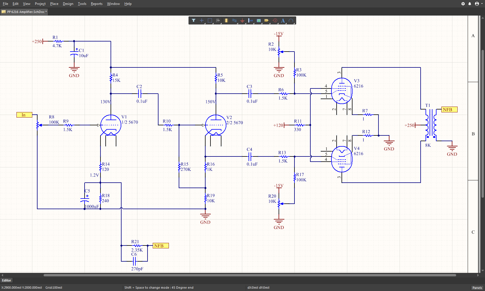

Very nice circuit!
A couple of gotchas though:
1. Put a safety resistor from the bias wiper to the negative bias supply.
Otherwise, if the wiper opens, you get Zero bias and max quiescent smoke.
2. Connect R6 and R16 directly to the pin 5 socket tabs. And move R3 and R17 directly to the coupling caps, C3 and C4.
That makes the resistor a true grid stopper.
As it now is, it does not perform R6's and R16's intended reason for being there.
All else looks good to me (or else just escaped my attention at this late hour).

As the circuit is drawn, feedback will be shunted to ground by C5.
Suggest you put C5 in parallel with R14 (or remove it entirely.)

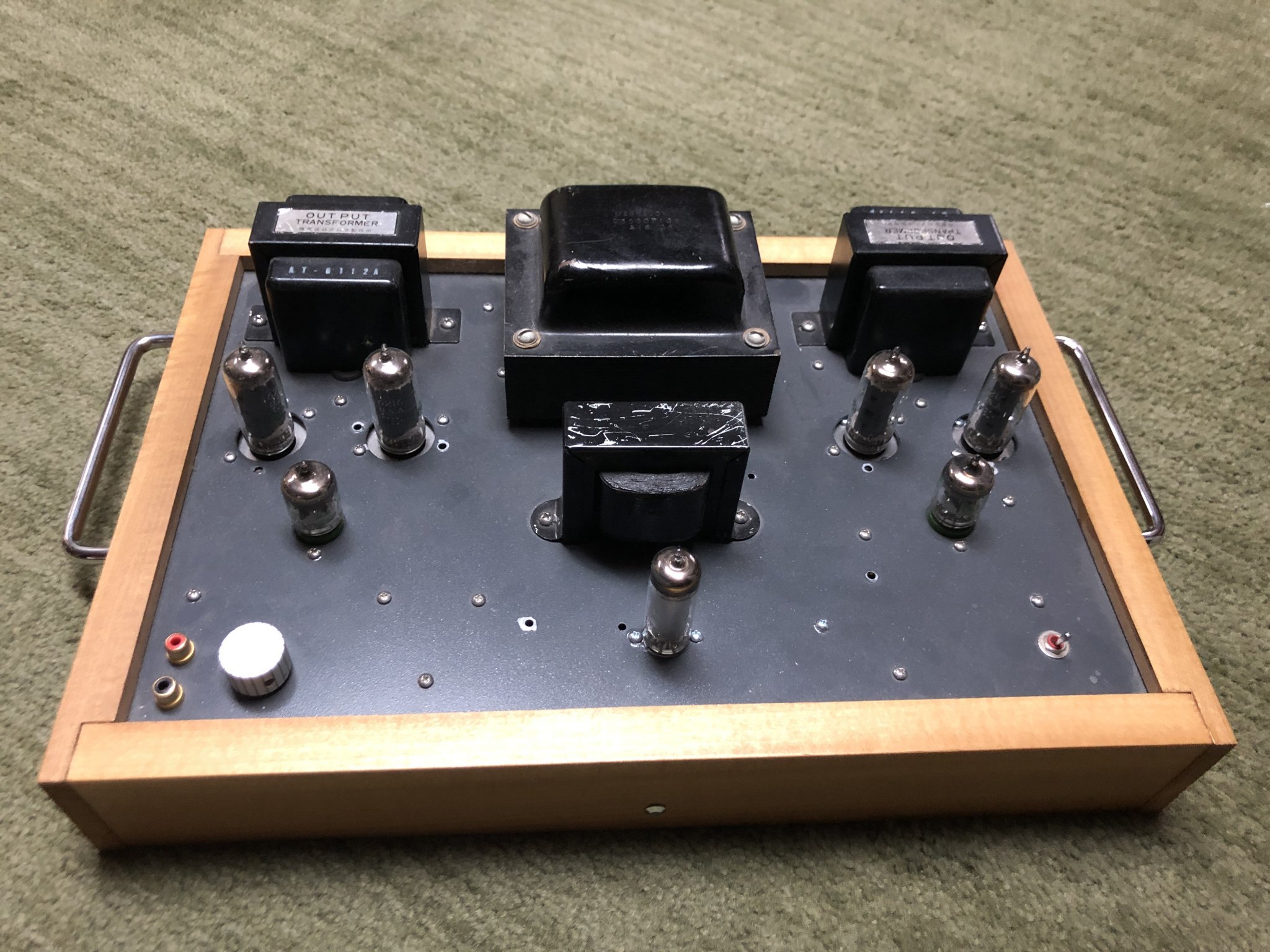

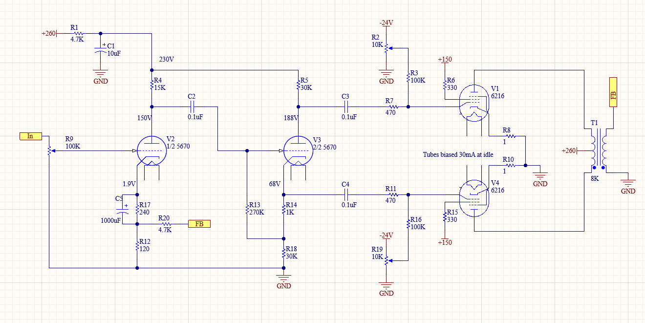

Yes it was always a real circuit. A few things have changed form the original schematic. The 10k resistors on the phase splitter were too low and weren't able to swing enough voltage so they were increased to 30k. The screen voltage was raised to 150 and regulated with an 0A2. The feedback resistor is also different.
THD is measured at 0.2% at normal listening levels and output power is 10 watts or so. I'm going to get roasted for saying this but my friend says (and I agree) it sounds better than the Sony VFET kit I was lucky enough to win.
astouffer,
Looks real good!
Good job continuing the design changes until it worked satisfactorily.
Have fun listening!

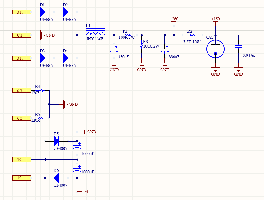

As promised here are some updated schematics with voltages. I didn't feel like drawing out all the transformer windings. The power supply is all reclaimed parts from other devices. Filter caps from a motor drive, bias transformer is from an old clock radio. No idea where the filter choke came from or it's limits. It only gets warm.
Many thanks!
Thanks for sharing the schematics. I have one question though - shouldn't the lower output of phase splitter be taken from the point between 1k and 10k resistors? In the configuration you're using one side gets slightly higher signal. Cathodyne resistors from signal outputs to supply rails should be equal for balanced operation.As promised here are some updated schematics with voltages. I didn't feel like drawing out all the transformer windings. The power supply is all reclaimed parts from other devices. Filter caps from a motor drive, bias transformer is from an old clock radio. No idea where the filter choke came from or it's limits. It only gets warm.
Less of an issue with the resistors increased to 30k as in the final schematic - but the reality is to use whichever connection results in equal (or the most equal) amplitudes. Cathodynes are pretty good right out of the box, but not always perfect. And neither are the resistors.
