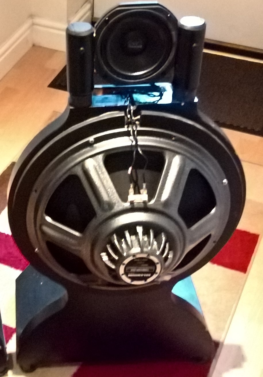

I started to become friends with Vic from Transfi and became interested in Open baffles I was a bit worried about not having enough bass and came across Hawthornes who's Duets were supposed to do good bass. I heard a few built in the UK so decided to build a pair using Darrell instructions. I used 3/4 birch ply I quite liked the result. A year later I had Vic help me with a more radical shape and had a baffle built to this design.
I kept these speakers for about 5 years and I did quite a few mods. Pushing the design as far as I could take it.
The next step of my journey was when I heard what the PRV 5MR450-NDY I really like how these sounded and decided to sell the Hawthorne drivers
I added the Neo selenium x 2 per speaker as the Neos are capable of going a bit higher than the Augies and needed this to match with the PRV drivers
It was not a pretty sight one bass driver on top and one at the bottom With the PRV 5MR450-NDY in the middle. But it was a step forwards

Next up I heard how the Neo Selenium sounded in a semi isobaric configuration e.g Both front and back facing each other. So I got the top of the baffle chopped off and placed the PRV 5MR450-NDY on top
This was a nice step up in performance I was finally getting the bass I wanted and the I loved the presentation of the PRV drivers
The design is becoming a bit more radical but at this stage I do not really care as I enjoy the results

Unfortunately, a few months later I blow one of the PRV drivers. Due to the cost of the PRV Vic suggested I go for the Beyma 5G40Nd/N - 5" 200W 8 Ohm.
I liked how they were a bit better in the treble but missed the mid punch of the PRV drivers. Thankfully I managed to get the PRV drivers re-done, Adding the PRV with the Beyma gave me the perfect mix for me of mid-end punch and treble detail.
The Neos are now in true Isobaric configuration. They go down to about 30nz which is low enough for me.
With all of this, I found that even Open Baffles added colouration. Now I get music that sounds natural and realistic. I do not see me ever going back to standard speakers. Whilst I freely admit most people would not believe it is possible to get good sounds this way. Let alone a system capable of realism for not crazy money. I think the major drawback is how it looks, it is not wife friendly for sure.
