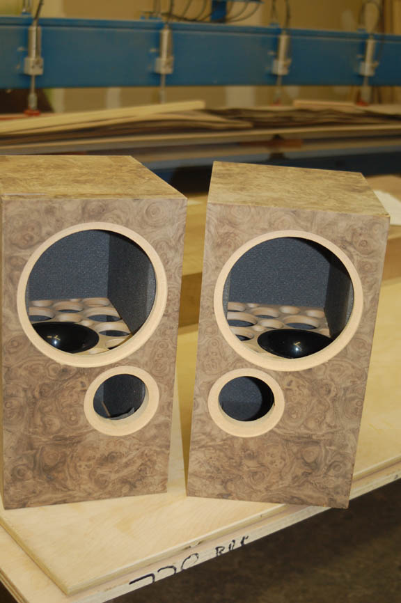

I’ve had this cabinets seating around for a while and now it’s time to put them to the good use.
I’ve been dying to try Hiquphone OW1 and Usher 8945P for a long time. So, I’ve crossed them over at 2200hz with impedance compensations on both (not including picks and port), 4th order L-R. I also ordered extra inductors to play around with BSC later on.
Legs will be made as a cylinders, running along each corner to the top panel and the cabinet will actually be cut in to them.
See what happens.

They are beautiful, I love your attention to detail, let us know how they sound when you get them finished!
Thank you. I will.

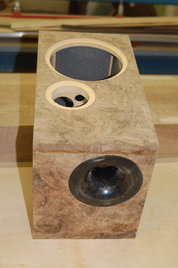

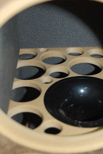

I'm still trying to fit the down firing port in my mind, and how that will work out. Could you clear it up for me?
Thank you for the correction John.
I was going to make legs this Saturday and just got too busy with the shop work.
Each leg will be a 1.5 diameter cylinder, running along side vertical edges of the speaker cabinet. Probably in Walnut or Mahogany. Each leg will have a rectangular cutout and the cabinet will sort of fit in to it. Lower portion will have a slight taper and merge in with chromed tiptoes. I am also considering a possibility of custom stands. Don’t know every aspect yet, I am designing as I go alone but my guess is that I don’t have to lift up the speaker from the table top or speaker stand a great deal of distance to let the port breath.

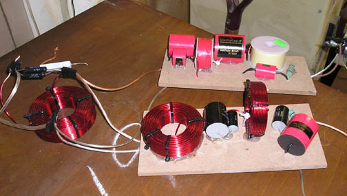

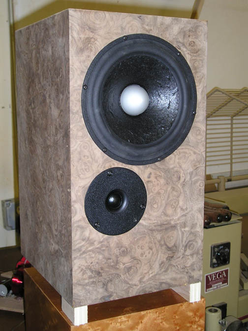

Drivers are installed and x-overs are together.
Without BSC, speaker sounds little thin and bright.
After playing around with 2.25 inductors (only size I have laying around) and different Rs, I’ve stayed with 2-ohm resistor and it actually sounds very pleasant.
This is not the end. I will get a few more inductors and start with “by the book” BSC calculation. I wish I had Sound Easy
to know exactly what’s going on.
It appears at this point that the resolution of this speaker is slightly higher then my ProAc2.5 clones (yes, yes, lower distortion). It’s too early to judge and it may be simply the case of the tweeter being a db higher.
The cabinets are not stuffed yet and the legs (which will play a big role) are not installed.
Pictures of x-overs are coming.

I don’t know if it’s Hiquphone OWI, the magic of L-R 4th order crossover or Clarity SA capacitors but this is the first tweeter (except ribbon in my Magneplanar 3.5R) that doesn’t make me shudder on the female opera vocals. The sound is almost holographic.

My understanding with a simple RL circuit is that the value of inductor changes target frequency and R can vary the amount.

I think I have BSC nailed. It ended up being 1.5mhz coil and 8ohm resistor. First time in my life, I got green color coils. I wander how the green color will affect the sound? After all, the capacitors are red. Could it cause a phase shift?
I am not going to rave about my own speaker. I like the sound now but the actual measurements are needed. I am going to set up Sound Easy in a month or so.
