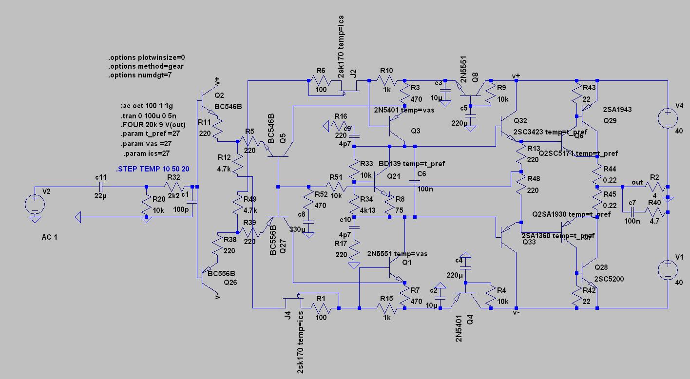

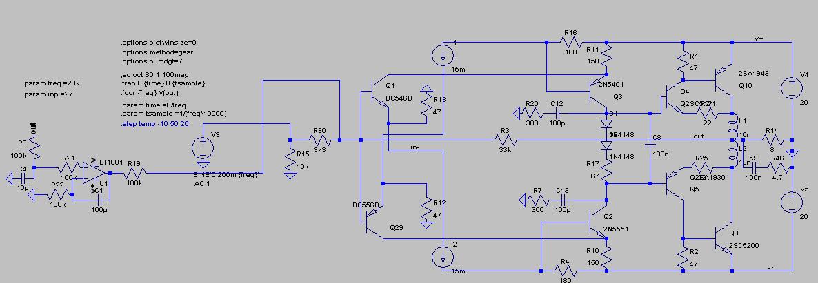

These are my future & ongoing audio amp's projects .
Because it is fun to design them and hear .
I prefer the sziklai/cfp sound overall and prefer lot of degeneration of the emitters in the voltage amplifiers because I believe that the solid state sound is less predominant .
The first is one that has harsh sound sometimes but full of dynamics .(In this topology I've heard a lot of dynamics,the drums and cymbals are great) .
A lot of amp's has the idle current dependent with the ambient temp of the vas and also the temp of the power heatsink .
The focus here was to reach low temperature drift over the idle current versus the components temperature ,also the vas current is temp-compensated (Q4 and J1 are sticked together ) .Also the multiplied diode Q14 share the same heatsink only with Q7,13,9 and 10 .The power bjt's are alone on other heatsink .
With this vas load (current source), the vas has the same current in it with the temp, so the idle current of the power bjt's don't depend on the vas current source temperature .
In simulators and also tests with audio souncard,scope, the thd is very low at 1khz and also at 20khz ,also at any power the thd is almost the same 0.002% at 20khz.
At 1khz the thd is less than 10ppm .The low thd and imd is achieved only if the power bjt's are biased with 10 to 15mA.
Because the thd is smallest at 10 to 15 mA idle current for power bjt's it was a little tricky to design it to keep the idle current stable with the temp.
The slew rate is also high and if one of the + or - supplies is not working , the dc voltage is not present at the output compaired to the other amp's which share almost the same topology.
This has also the smallest imd but :
The sound is very accurate and not so musical .
So let's get further

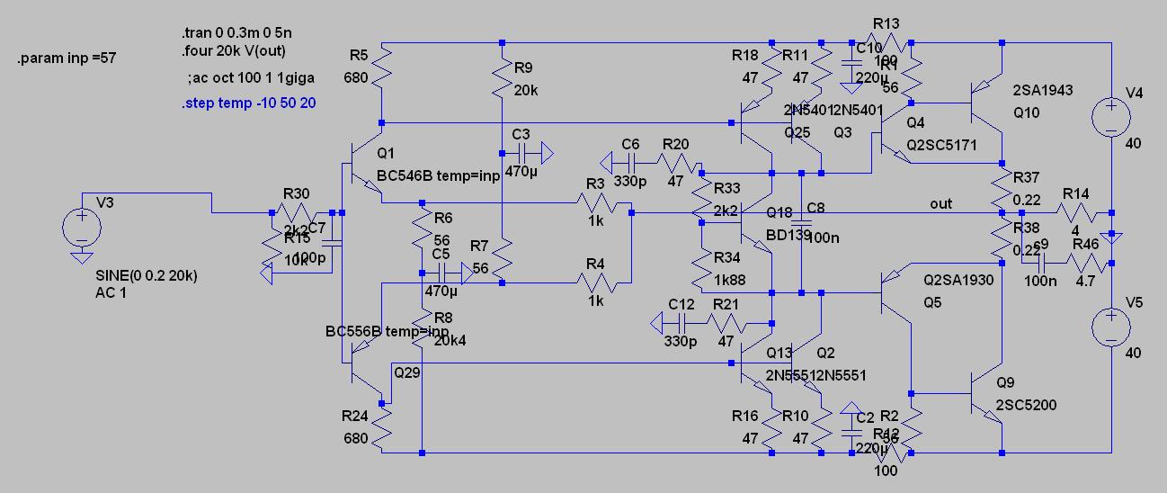

The second is a my_ref modded a little ,with Lm4562/lme49720 and all dc connected .No caps through the signal path .
If I have dc offset from the source(dac,etc) ,depending on the source I have an switch whitch inserts a capacitor in the input .
The sound is full and rich within all the octaves but has less power and to my speakers seems that is not enough .
The dynamics are less compaired to the first schematic, good enough but not outstanding.

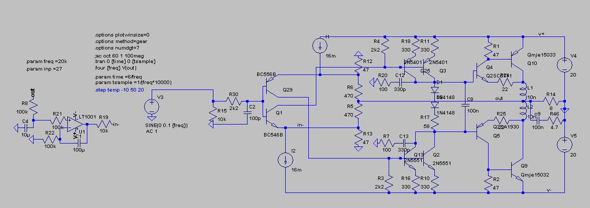

My dynaudio speakers eats a lot of current and a my ref is not enough .
The third one which is not done yet, I hope that will sound great .

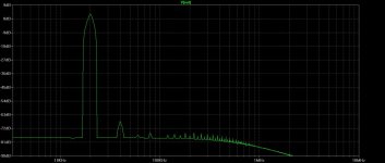

It has the highest bandwith from all , almost 20 Mhz,no global negative feedback and no phase turning in open loop .The thd is 0.02 at 20khz at 3 watts .I will study the type of compensation .

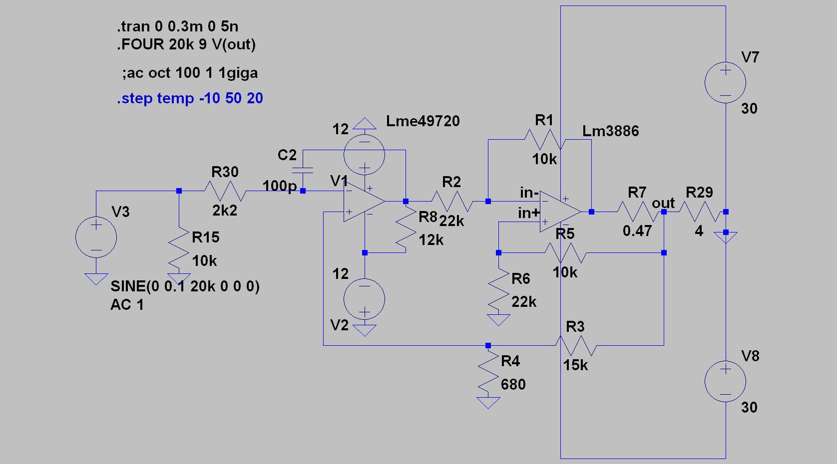

And the 4'th which I hope to finish it this year is a simple current feedback ,the idea being that less components =better sound .
This one has high slew rate ,small thd at low power and high to medium bandwidth .
We will see at the end what the ears will choose :)

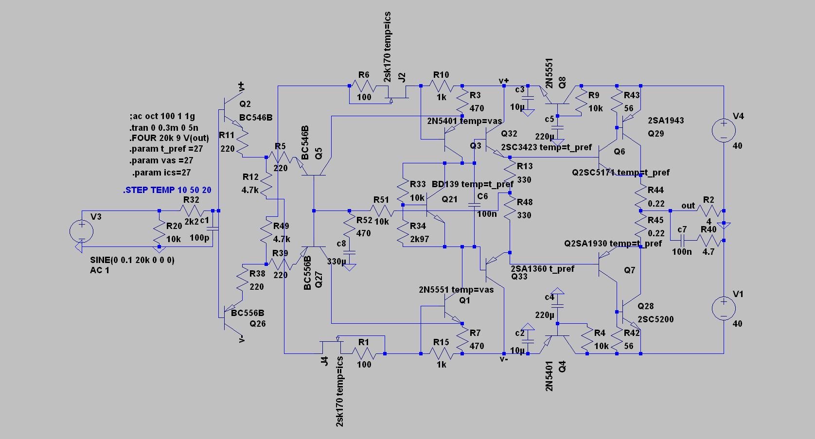

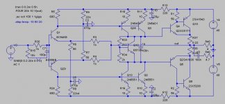

And the compensations for the latest two .These simple compensations introduce the smallest group delay .
I will try to find some time and make them until the end of the year .

Hi Guys
The first project is just the Blameless amp with a different current source for the diff amp and a buffer added between the VAS and CFP. The latter is beneficial where the former is not.
I would suggest that you found its sound to be dull, lifeless and boring because in fact you are hearing a transparent amp for the first time. Many have this same experience. Once you train your ear to recognise truly low distortion sound, you realise how much distortion is present in other things you hear.
Having a transparent PA will highlight deficiencies in the rest of the system. Or, if your speakers are also quite flat response with low-THD, you are hearing them play true sound for the first time.
You get used to certain distortions or frequency emphasis and likely even prefer some emphasis. When that is removed, of course the sound will seem to be lacking. The hard part is in assessing what it is we really like to hear and accepting that this may be different from technically accurate reproduction.
Otherwise, it is fun to play with lots of different circuit types.
Have fun
Kevin O'Connor
Hello .
I like the design you have and wonder why you didn't find the sound musical. Something to learn, something to fix perhaps. It looks like a good design, LTP with lots of emitter degeneration and current mirror to maintain good balance and improve the gain (which was reduced with degeneration). I'm not sure about the current source - it plays such an important role as it is used for the LTP and VAS, I wonder if it deserves a decoupling capacitor in there somewhere, perhaps on base of Q4 to ground. Some people find that a bootstrapped VAS load sounds better. I'm also not so sure about the cap multiplier (Q5) and it's possible impact on the sound.
The feedback scheme is the most interesting part. The benefit of a Singleton input is the 2nd harmonics giving the sound more richness. The current mirror you have may spoil this and prevent it - I would have to see some simulation.
The fourth design looks like something I have been considering - a marriage of Gaborbela's "20 year" amplifier and Rod's P3A output stage. I worry a bit about the bias stability though - the CFP output needs very accurate bias and the symmetric design is a poor topology in basic form for bias stability. I think this needs more work.

Hello Struth ,
Well it seems to be but may be not ....
How is the gm in contrast with the blameless regarding diff amp ?What value of slew rate you suppose here ? :)
The second important thing is the "unusual" current source for the vas & diff amp .Why do you think is done in that way ?
The response is the thermal drift ,In every amp the vas current has a high thermal drift, in this one no drift exists .The second thing related to the current source is that if one of the rails are missing, there will be no voltage at the output which ,at blamelless this is present .
Also have a look at the gm of the vas ...
These topologies has a big flaw regarding the psrr of the negative rail ,in this version this is eliminated .And if we take a closer look we can see a "current" feedback also :)
I don't know the thd20 for blameless can you provide it ?
So what it seems to be may be it isn't :)
PS :When I had tested/hear the amp(2 years) that version missed the psrr benefit also the temperature drift for the vas and also another gm for vas&diff amp .But a my_ref amplifier modded I like more than that version .
Thank you and greetings ,

3-th
It took me a minute to realize this is a double differential input stage, two LTPs. I've never used this topology but my Bryston B60 amplifier uses it and it provides for a very clean undistorted sound with strong bass. If I understand properly, the LTP drives a folded cascade VAS ?
Hello Bigun ,for the 4-th version I was thinking from begining to insert a opamp only in dc to make dc servo(I will have the option to mount it or not ,I will see at the tests) ,cheaper and simple !
Anyway even with big variation of beta the dc output is stable ,under +/- 50mv .For the forth version I wanted a low number of active devices in therms of voltage gain .Here we have 3 .
And I wanted only one phase delay through the feedback .
Also an super high bandwidth in closed loop through negative reaction ~30Mhz .This should improve the harmonical response .
And yes ,for the 3-th version LTP drives a cascode VAS .Doing this I have less phase turning in open loop .Also by not decopling the cascode I have a smaller gain but a great benefit ,small compensation caps .
