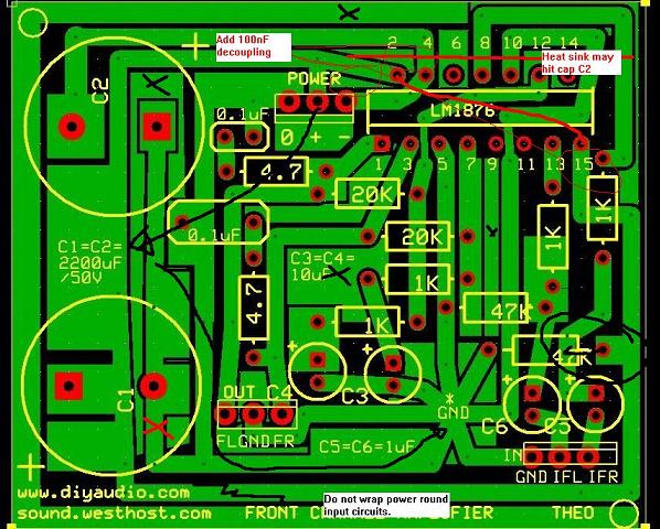

I'm going to build a good 5+1 channel ht with 2*LM1876, 1*LM1875, 1*LM3876.
Now there is the PCB of LM1876, Which I designed using PCB Express,
And the schematic is the "Auxiliary Amplifier Circuit" as it was in the official datasheet. I just removed the inductor.
Tell me your suggestions.

ok, this may be a solution, to use two LM1876 for front and rear. and one bridged LM1876 for subwoofer. And one LM1875 for centre.
Yeh, this is the best solution.
Now look at my PCB layout.

if you route pin 15 under the 1K resistor just below it and around the outside of the board, you can then evenly space your input leads if you wanted to use a standard connector there.
Get rid of all the copper pours that are not connected to anything. I would suggest trying to make all traces with 45 degree angles only for manufacturing purposes. Also watch for issues with spacing between traces and pads. Your layout has a number of questionable areas where traces appear to be very close to other traces or pads.

Hi Paswa,
I have had a look at your design and there are a few problems with it.
1. 47K resistor is connected between +ve rail and ground it should be connected to C5.
2. Remove the unconnected copper. It forms a parasitic capacitor between pins and can make the amplifier unstable.
3. The power supply should not encircle the signal input. Rectified signal currents flow in the power supply and this can cause distortion if it is coupled back into the input stage. Try to keep the +ve and -ve supplies as close to gether as possible.
4. The star point should connect between the center point of C1 and C2.
5. Power supply in should connect to C1 and C2 before it goes to the amplifer. Power ground should join between the two capacitors.
6. You may need some wire links to make all the connections but it would be much better to do this rather than compromise the design to use PCB tracks.
7. LM1876 should have 100nF power supply decoupling capacitors close to the power pins or it may go unstable.
8. The LM1876 may need to closer to the edge of the PCB depending on your heat sink.
I have attached a rough drawing with some pointers on it.
Andrew

Get rid of that junk Express PCB and use Eagle instead. I blew up a couple of amps designed with Express because it had the wrong pin description in the library.

Hey, check it out, I've modified my PCB with the suggestions of my friend Andrew.
Is there any problem remaining?
the layout is ok.i have 3 suggestions:
1,the power terminal is too small,i think 200mil lead is better.add more PG pads.
2,for the sginal track,i think 35mil is ok,for the power track i would like use 60mil.i would set the minimum clearance as 20mil.
3,consider how to mounting the chip on the heatsink,you should left enough room on the board for the heatsink or cut the border track(pin 4,8,10).
