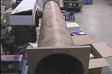

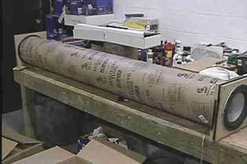

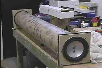

You obviously haven't seen my thread: cheap throw-together subwoofer. Your basic coffin-sized mdf box. Not very pretty either.🙂
Rino odorico said:Just bare in mind that the project was just built for fun...so it doesn't look very nice.![]()
The best kind 🙂
dave
I dunno...
It's beauty incarnate. Is there anything more lovely?
Seriously. It looks great.
Dave
Dave
the lines can be pretty blurred between a ported, a TL, and a baffle enclosure, hunh? I was imagining a 2 foot diameter baffle with a small driver and some sonotube to extend the bafle back some. Would have looked just like that but shorter and fatter and a smaller driver !
Hee, nice 🙂

Sure, just have to bring home my digital camera. But in the meen time, all I have done to connect the end plates to the tube is simply screwed them together. I measured the outer diam. of the tube, transfered the measurements to the end plate and cut the hole. Attatching the end was easy, slid the tube into the cut out of the end plate and screwed (from the inside of the tube to the end plate) it all together. I did add some silicone around the connections (end plate/tube) to seal it better.
Hope this helps
Rino Odorico
