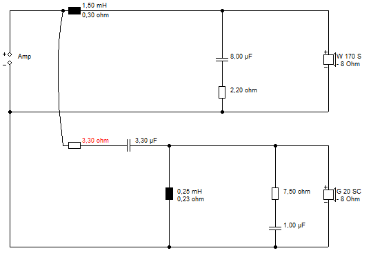

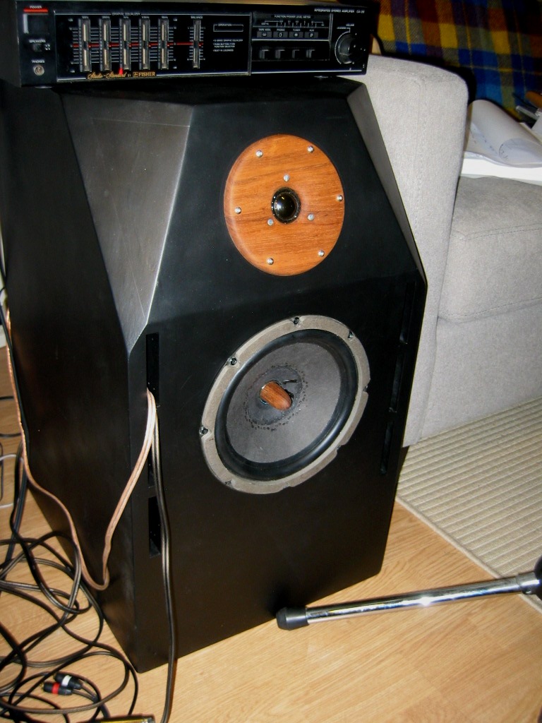

That looks like 6" bass plus 1" tweeter on flattish baffle at 8 ohms nominal. Pretty standard and easy combination. 😀

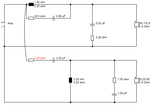

Either of these will be not a million miles away. Bafflestep to boost the bass level plus some bass rolloff. The second one notches the typical cone breakup of a 6 inch woofer.
The red resistor adjusts tweeter level. The first one is easier and kinda an industry standard. I'd prefer the smoother sound of the second. 😎
Oh, it's a 3kHz crossover. Anything lower is silly unless you really know what you are doing.

Well it's an 8", and you're designs look to assume an 8ohm driver on each circuit. Neither speaker are 8ohms, in fact at the 3kHz point you suggest they're 18 and 14ohms respectively. Also, the woofer's response starts to fall off at 2kHz so I don't know why you think crossing at 3kHz would be better - can you please explain?
I take it you ignored my request for a phase linear design? I was just reading A Bessel Filter Crossover, and Its Relation to Others and it seems to offer some phase linear solution formulas. It also mentions the fourth-order Linkwitz-Riley filters are in phase at the output. Which filter designs are these you've put together?
Also I only see the bass attenuation on the second diagram you've given - am I reading the circuit correctly or is that a boost?

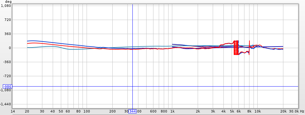

Am I mistaken in thinking that I've already measured the phase of the drivers and found them to be both linear and matching?

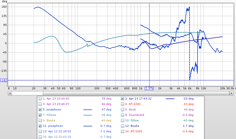

Is this the phase response(s) you are talking about?
It's difficult to tell what is going on. The scale is way off - phase is usually plotted with a min of -180 degrees and a maximum of 180 degrees, since this corresponds to the wrapped phase that you often get out of a measuring program. If you "zoom out" too far, everything starts to look like it's about at zero, and linear.
I would call only these "matching" phase angles if the phase was within 15 degrees over the band in which you will implement the crossover. For a Bessel crossover at 1.8kHz this will extend from something like 180Hz to 18,000Hz (the -40dB down points for the HP and LP filters).
Also, what are you plotting in the phase plot?? Measured phase? Minimum phase? Can you rescale the y-axis and repost the plot (keep the same x-axis scale). That will clarify the phase situation...
-Charlie
Wow, don't know why I didn't catch that scale issue. 😱
Turns out they're not that linear or matching.
I've taken out the measurement with the Rhode as I trust the Josephson mic a little more and the lines are hard enough to follow without extra measurements.
The phase here is what REW has measured on impedance measurements and nearfield mic measurements.

Ah, thanks. Now let's see...
I'm not sure that I like how the phase climbs from around zero up to +180 degrees for one of the series. That's not really physically possible. Phase is a quantity that can only get progressively more negative with increasing frequency, apart from a little wiggle here and there. Also, it seems to be hovering around zero too long (compared to what I have seen for a typical midbass drive unit). Was there some kind of delay subtraction or auto-zero of the impulse peak done?
Anyway, to cut to the chase, it's best to use a loudspeaker crossover design package because it will take into account all the things that influence the speaker's frequency response, be it driver impedance & phase, acoustical amplitude (e.g. SPL) & phase, or the reactances of the components in the crossover. If you absolutely cannot find any software for your O/S in which you can account for all of these things, you might try posting your situation on the Parts-Express Tech Talk forum. LOTS of knowledgeable DIY loudspeaker designers hang out there and someone will help you (if you do a little groveling) by designing the crossover for you using PCD or other software (if you ask nicely). They can also help you with the measurement side of things, too. Once you see the whole process done right, you can try to do it yourself with confidence that you won't be wasting your time/money.
-Charlie

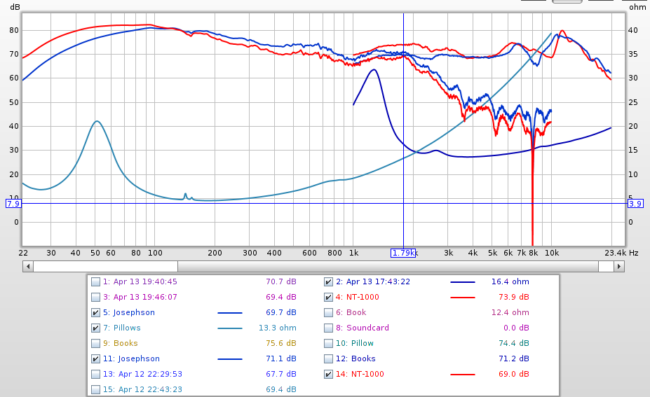

I just took some SPL measurements with REW and this is the phase response it tacked onto the driver - the impedance measurement is separate and REW had no idea they were even from the same driver. I'm not aware of anything in the measurement process that would account for the phase issue you describe - maybe the phase of the microphone used has altered things?
I don't have an SPL meter here to accurately bias my microphone measurements, so I'll have to do that by ear.

You really only need accurate SPL data. Do a nearfield and a gated impulse response or other kind of farfield measurement on the woofer. Do a farfield measurement on the tweeter. The SPL from these will need to be "processed" into a minimum phase measurement and the phase will be calculated from the SPL response. This means that you don't need to worry about what the phase looks like now.
I would get the best SPL measurements you can for each driver and then go over to PE Tech Talk for help. The first question they will probably ask you is whether you used a calibrated microphone to make the measurements, which you didn't. This means all your SPL data may be off by 1-2dB, especially For the tweeter, so the final result will be in question there but might be OK anyway.
If you can swing it, sell your existing mics and get a calibrated measurement mic. For $90 you can have one:
