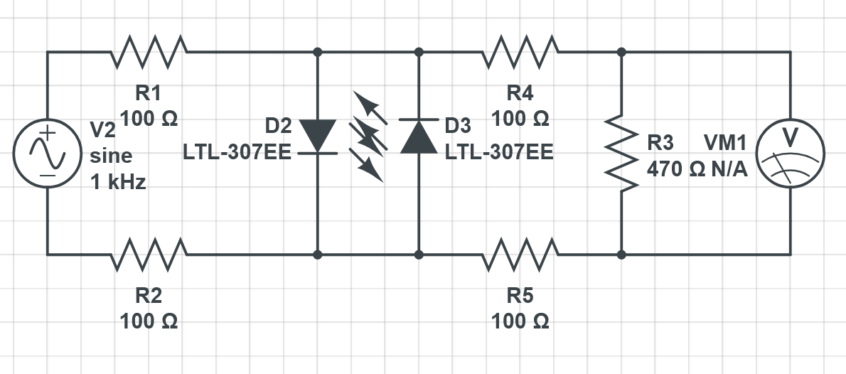

You need to measure the gain of the amp.
Calculate the max rms voltage you want +/- 60volts for 500w/8ohm
divide by the gain ( lets say 40) so you need to limit your input voltage to 60/40 = 1.5 volt rms 2.1 peak.

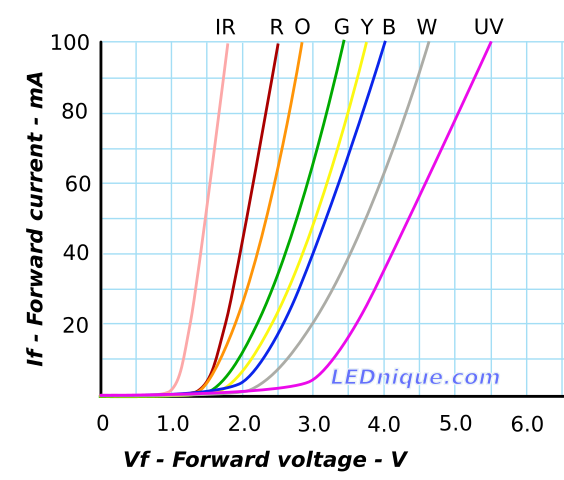

So use two anti-parallel green LEDs and use a 200 series resistor (2x100 if symmetric).

We also need the input sensitivity and impedance of the amp. Then we can propose some sort of soft clipper that will operate at the right signal level. mvs0's circuit above will work but introduce a lot of distortion even at levels well below the start of clipping. An active circuit will work much better.
I have carefully measured the circuit, it has low distortion 3db before peak clipping level, I will check if I find back my measurements. Peak power , one or two channels , impedance does not matter as this amp will never reach anywhere it's max spec.
Even in simulation, which is always overoptimistic, I get a lot of distortion with this type of arrangement... Can you show the schematic of your circuit? The power spec conditions do matter to establish or at least ballpark the actual output power of the amplifier. Unless the clipper is buffered, the input impedance is required to adjust properly the voltage divider of which the clipper is part.

the schematic:Even in simulation, which is always overoptimistic, I get a lot of distortion with this type of arrangement... Can you show the schematic of your circuit? The power spec conditions do matter to establish or at least ballpark the actual output power of the amplifier. Unless the clipper is buffered, the input impedance is required to adjust properly the voltage divider of which the clipper is part.
The circuit is driven from the XLR out of a Marantz AV10 (75 ohm output impedance?)
Output is going to the XLR in of a Quad Artera Mono amp. (10k input impedance)

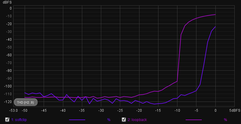

the measurements:the schematic:
I will see if I can do the measurements again today..
Done with the (ancient) E-MU 0404, XLR in/out
Note: the soft clipper has an insertion loss of 8dB, the input of the E-MU clipped at -10dB in the loopback measurement.
This is to illustrate that a passive soft clipper with LED's can have low distortion.
