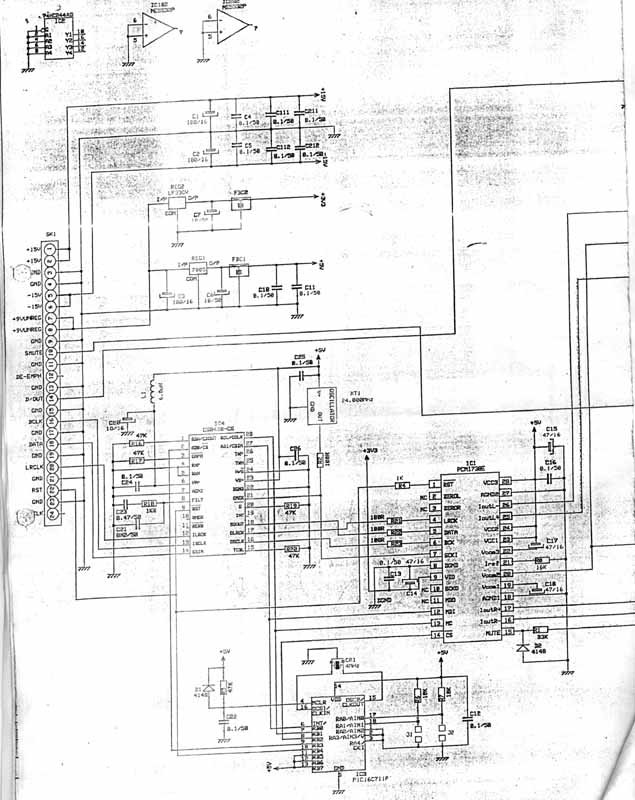

This 24MHz and CS8420 stuff just did not make sense to me. So I looked around. The A3CD is based on the MF X-Ray and uses the PCM1716 dac. Master clock is 16.9MHz. GT has a suggestion on his site for sending the master clock back to the transport.
Ok,
I was confused as well!!! For this reason (and the fact I had only partial circuit diagram - a bad photocopy) I decided to introduce separate low noise +5V power supplies for each oscillator with my favourite combination for local-close-to-the-oscillator decoupling: 0.1uF/50V NX + ferrite bead(s). One supply for 24 and the other for 16.9MHz. Search for: musical-fidelity-a3.24 mods . The end result was very good!
I will scan what circuit diagram I have at home and post on this thread. Maybe someone could figure out what's going on and make things clearer.
I'm at work (HA!) at the moment, will scan and post in 10 or so hours.
Extreme_Boky
Extreme_Boky

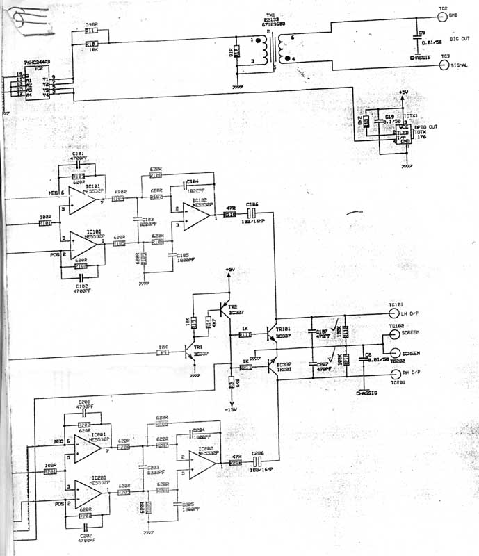

I modified A3.24 upsampling CD player, but have circuit diagram for DAC as well. I'll check again both diagrams but they looked the same - DAC has discrete buffer as the second LPF stage (capable of spitting out 5 or 6 AMPS with a proper power supply!!), where CD player has IC's.

I can e-mail both diagrams to people who'd like to have a look. They are:
1. A3.24 DAC
2. A3 CD Player
The copies are very bad, but might give some hints to questions in this topic. The units are different not only in analog section, but in digital as well.
I have scanned A3 CD player circuit diagram and will try to post them here as well.
