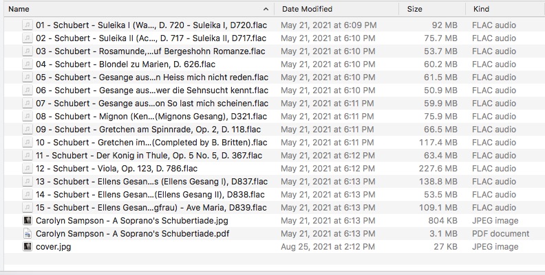

I downloaded four FLAC music albums from Presto Music. They arrived as zip files, and would not unzip, they got stuck in the .zip/.cpz loop. After some Internet searching, I found references to a free program called Unarchiver. This program did unzip the files, on both computers. However, on the iMac, the cover artwork was not displayed for the individual songs, but on the MacBook Pro it was.
I transferred the unzipped files from the MacBook Pro to the iMac, but the cover artwork was still not displayed for the individual songs. This seems to be a problem with V10.13 on the iMac, but I do not know where to start looking.

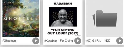

But if you unzip compressed files that include cover art files then the Melco (with updated firmware) should have no issue is it? As I understood only both Macs have issues with cover art but if you don't use iTunes what software do you use to play back music with the cover art?! Or do you mean the Finder? You could be clearer describing when/how with what action you don't see the cover art!
If they are not included you can download 500 x 500 cover art files and add them in the album folder. Videolan Media Player will have no issue even on old unupdated Macs I guess as it works even on MacOS 10.7.x. This one: Downloads - VideoLAN

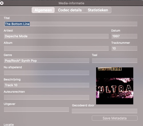

4. some media players offer a feature in the menu to download cover art themselves. Does the Melco have such a feature that can be enabled ?

1. The cover art files (with .jpg extensions) are not named “cover.jpeg” they have long names, in one case, “Carolyn Sampson – A Soprano’s Schubertiade.jpg”, and is fairly large for a .jpg at 804KB. I opened that file in Preview, on the iMac, changed the name to “cover.jpg” and the size to 640x480 (27KB), that did not help.
2. Yes, all the individual FLAC music files are listed in a Finder window. They can be played using Audacity on either the iMac or MacBook Pro. Strangely, using iTunes, they will play on the iMac, but not on the MacBook Pro, I almost never use iTunes, so I may not have the correct settings.

I never bothered to change/edit metadata. I copy missing 500 x 500 pixel cover art to the folders and things work.
BTW I just checked and SongKong does exactly what you want. It can find missing cover art files automatically. Solved!

I debated if it is worthwhile to add the following information to the discussion because this may just be a rabbit hole I am going down, but here goes:
I dug around in the Trash Bin on the iMac and found an original file with the .cpcz extension. I put it on the desktop. I changed the extension to .zip. I used the Archive utility to unzip it. A progress window opened, when the process ended, a second progress window automatically opened, and when that ended, a folder appeared on the desktop with the expanded individual songs. But the artwork was not displayed.
I tried the same experiment on the MacBook Pro. I got the same double progress windows, but ended up with just another .zip file.
I reached out to Melco a number of days ago, asking about this “tagging” problem. They responded the next day, but I just found it in a junk e-mail folder. They provided the following information:
Twonky does not support the use of PDF files as cover art images so if your album folder only has a PDF file then it would not be picked up as "cover art".
Also you should ensure that each folder contains a JPEG image file of the album cover art, and that that file is called "folder.jpg" (or that the files themselves are tagged with the cover art for the album) then the UPnP server should be able to give you cover art as you would expect.
So, on the Melco, I changed the name of the Carolyn Sampson .jpg file to “folder.jpg.” The Melco then creates a folder called “folder.jpg” containing that .jpg file. The artwork is still not displayed. I reduced the size of the jpg, with the same result. Since none of the other music files I have downloaded have the “folder.jpg” folder on the Melco, I assume those sources tag the individual songs to the provided cover art, and Presto does not.
One would think that if this is not just an issue with my particular hardware, then Presto would be getting a lot of complaints?

So to be clear - you are able to open/view the jpeg files (such as "Carolyn Sampson – A Soprano’s Schubertiade.jpg") from the zip archive OK? If so, these files are not corrupt, and there should be no need to resize them.I reduced the size of the jpg ...

And finally, rename each cover art jpeg file to "folder.jpg".
linuxfan, thanks for the primer, that basic information is helpful.
Yes, I can open the cover art jpg, and it displays just fine in Preview. During one of my Google searches I read that cover art should be limited to about 500 x 500 and less than 50KB, so that is why I reduced the size. I have no idea if that information was correct or not, but it did not seem unreasonable.

I have a few dozen music files that display the cover art but do NOT contain a “folder.jpg” file, but do have a jpg of the cover art as part of a pdf document. These are music albums downloaded from HDTracks, HighResAudio, and Qobuz, over a period of many years. The four albums from Presto were downloaded at various times over the past year
