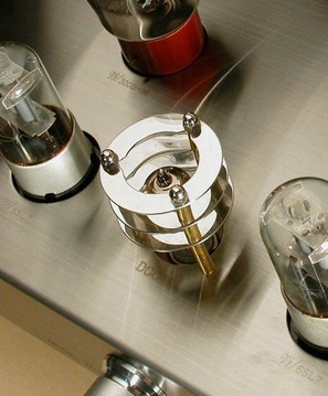

I have a Music Angel which uses a DCC90 in the input stage, driving 2A3s and 300Bs.
The little DCC90 is very prone to microphony and is set in a little cage. It is mounted on a base set in a rubber sheet and well below the level of the top plate. All this is supposed to decouple it but it isn't enough. I want to get it out to put some damping rings on it.
Does anyone have any bright ideas about how to get it out without taking the whole amp apart? The cage seems to be bolted on from below, but to get at the bolts it looks like I would have to take out the plate on which all the other bases are mounted. There seems to be plenty of opportunity for mishaps on the way. It doesn't seem to dismantle from the top.
It's one of those stupid frustrating puzzles. I want to avoid taking the amp apart because it weighs 25kg and since I've just had surgery on my back I can't move the thing from its shelf and turn it over!
(For the curious, here's a photo of another Music Angel model showing the cage)

Maybe the cage supports are bolts or threaded shafts with sections of steel tubing. This would be why trying to undo the nut is not working. You might have to look underneath the chassis to see if you can place a spanner in there to stop it turning. Can you fit something like a small screwdriver under the valve to prise it up? If you attack it with a hacksaw you will probably do some damage to the chassis (or I know I would if I tried something like that).Nardis said:

The cage is like this:
under chassis - acorn nut onto a piece of M4 threaded rod.
Rod goes through chassis and then the 3 lower sleeves are slipped on, then a ring, then the next 3 sleeves and another ring and so on. The acorn nut is last then on top. You need to grip the acorn nut inside the chassis to open it.

Thanks Woodturner-Fran.
Using your description I was able to twist the sleeve sections against the central rod and create enough friction to get two of the acorn nuts off. The third was cross threaded, and since I could not get the ECC90 out of the socket, my only choice was to hacksaw the acorn nut from the shaft.
I had intended to replace only the bottom ring but I found that the central rods are not threaded all the way only at their ends. So I can't just refit the bottom ring and use the acorn nuts to hold it firm.
I tried a temporary fix, packing the sleeve pieces with Blutack. It looks ok and I can remove the DCC90, which was what I originally intended, but it obviously needs gluing with something heat tolerant.
LESSON LEARNED: avoid designs with fancy little cages. It took half a day to fit tube damping rings!
MUSIC ANGEL OWNERS BEWARE!. There are some powerful magetic forces around these valve sockets, and I almost lost a screw into the interior. If you do dismantle the cage, use masking tape to cover any openings in the chassis.
