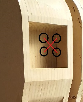

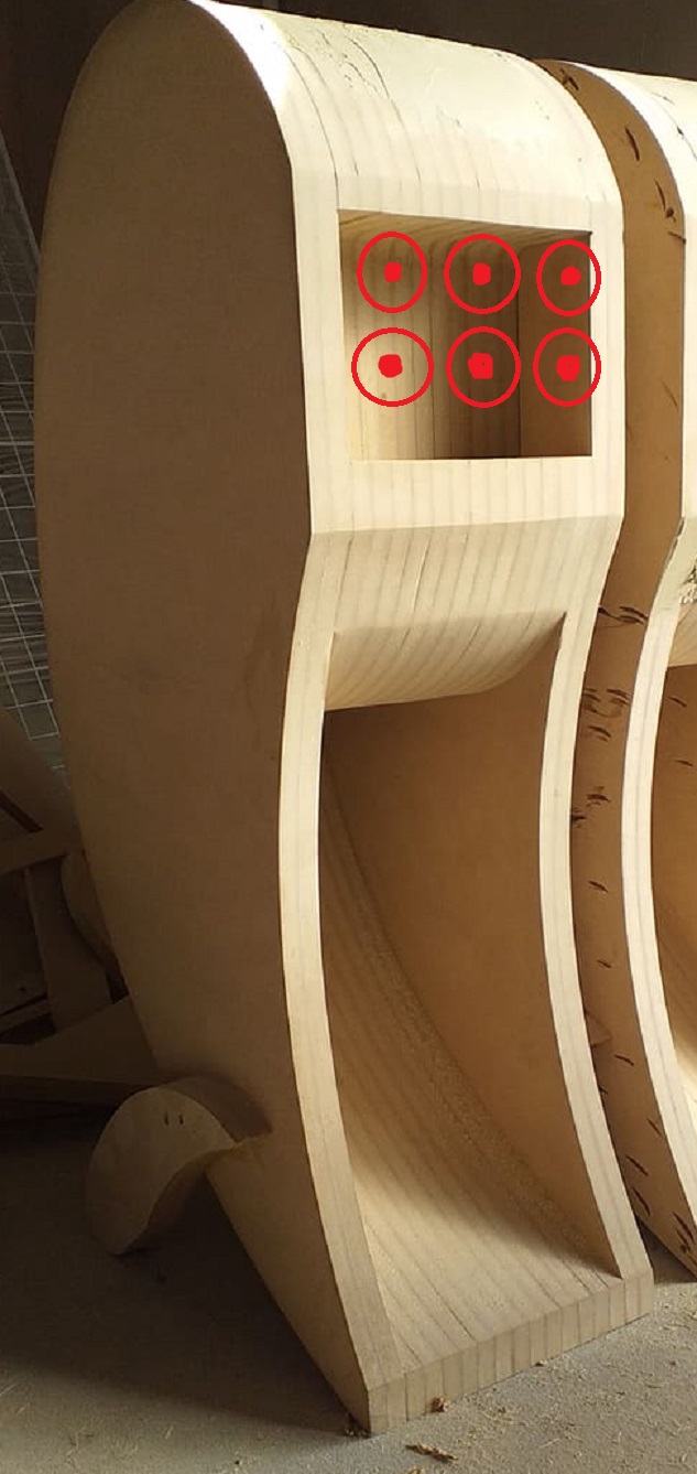

Ok , i use 4 drivers , the center of the cones could be at 4.8cms !!

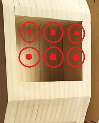

But with 3 colums of two drivers , the distances of cones will be differents between them.
Need to draw a diagonal line.
Again, I posted: "Or if 1800 Hz is the limit, then 34400/1800 = 19.11 cm or 4.78 cm."
So based on a 4.8 cm ctc spacing, you're limited to two rows of three at ~0.794 WL ctc.
GM
I believe probably in the original equation they assume a point source. At s distance L apart. However in this case I believe it is a full cone I don't think the equation is valid anymore. All the cones are moving together as if it is one big diaphragm, I don't there will be a combing effect...
It's valid TTBOMK. They're moving as one down low, but as the frequency increases they become increasingly more independent of each other with obvious combing effect above the ~1 WL point, though this is so dependent on each human's hearing acuity, room, listening distance, etc., like a MTM or line array that it's strictly a guideline.
That said, I've wondered if an average is a better way, i.e. [4.8*9.6]^0.5 = ~6.79" in which case we could just fudge a bit and use 2 rows of four [19.11/4.8 = 3.98].
