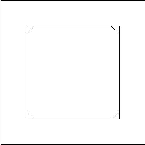

The size of the room will be approximately 10' x 10' x 10'. The room will be "empty". The subwoofers w/ built-in amps (and speakers) are to be built into the walls. Full-body sensations are ideal, so i might start experimenting with 100-200 Hz, per the results of an Audioholic experiment. Headphones will be worn, and the goal is for the subwoofer sound to remain nearly silent after headphones are in and on (which is why we focused on lower frequencies (below 65 Hz) while the sensations remain strong.
My two cents based on experience running live PA systems, and what I would try.
My crude drawing is looking down and describing the walls of the room.
As per your spec the room is 10' cubed, but with 10' high panels sealed into the room corners.
These panels with suitable grill cloth, serve as baffles and form enclosures in conjunction with the room walls.
Woofers (and mids/tweeters) could be mounted at any height desired.
In the bottom corners would put the woofers in '3 space' and achieve maximum efficiency.
Moving the woofers higher to around knee height would also be useful, and might be better.
You will also need eq, perhaps pretty drastic eq to restrict wild room modes.
Boosting down very low will cause trousers to flap.
Moving higher in bass frequencies will cause vibration in the body higher up.
100Hz through 200 Hz will excite sensations in the stomach/chest area.
Boosting 55-65 Hz will get the subjects right in the 'nads....it's pretty funny seeing how a crowd changes dance moves according to boosted frequencies, think pelvic thrust lol.
Another approach would be to mount the woofers in the corners of the ceiling (if possible).
What is the construction of this pressure cell room.....you will need to be careful about allowing buzzes and rattles.
Silicone at panel joints, and between panels/joists are your friend.
I don't know the cost of this stuff, but I have read very good reports of it used in Recording Studio applications - greengluecompany.com/benefit/how-green-glue-works
This sounds like a fun experiment, and you might be surprised how little bass power you need to achieve your goal, but more power is better of course.
