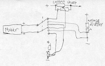

Ummm... if you use make-before-break switches it will short the different parts of your amplifier together when switching... I really think you don't want that.
Something like this image. Add more switch poles and shunts and dividers for more channels. The switch *has* to be break before make and able to stand off the voltages present in the amplifier. This could be a problem. 500VDC is much for a switch.
Only recommended for switching current, and keeping continuity.Ummm... if you use make-before-break switches it will short the different parts of your amplifier together when switching... I really think you don't want that.
The switch need not switch the full voltage. It could be divided down prior to switching.This could be a problem. 500VDC is much for a switch.

And that would only be needed on the current ranges if the current sense resistor is in the positive rail (which I guess it is). The resistors would have to have good matching though. Or use a pot there too. Or else voltage variations will cause inaccuracies in the current measurment.
For the voltage ranges you don't need any extra dividers as they are already there.
But this still isn't really what the OP wanted... Toggle buttons... Maybe using a couple of relays or analog switch IC's and drive logic 🙂

I would strongly advise against measuring the current on the +ve side of this circuit. It would mean "floating" the measuring circuitry: meter & meter power supply, up at 500 volts.
Although this is sometimes done with moving-coil meters that are designed for it, a DVM module definately is not.
Current in valve circuits is most often measured by interrupting the cathode supply. The shunt resistor can affect the performance, so is often shorted out by the switch when in "neutral".

Going back to an earlier post; Since you are using cathode bias, if you measure the cathode voltage, and calibrate the meter to display the corresponding current, it's not complex at all. It only becomes complex if you want to truely measure the current.
Using the above, you could use a 2 pole 5 way break-before-make switch and a handfull of resistors to do it all.
