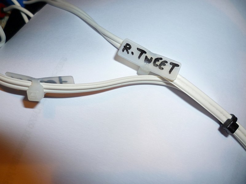

It's not just the final speaker cables that must be connected treble to treble, bass to bass etc.
Ensure all cables from source to speaker are clearly identifiable and/or impossible to connect wrongly. I'd mark each cable at both ends to ensure errors cannot occur even while making up the cables.
For me, it's very much the case; if it can be connected wrong, it will be connected wrong. YMMV.
Ain't that the truth! Last week I tore down my test gear and reassembled it on new furniture. Just doing that I got two connections wrong.
I've just spent the morning running all the cables under the floor and was careful to mark each end of each cable as I cut it to length. I had my wife double-checking as I went.
It becomes particularly mind-boggling when working on the back face of a wall plate or connector and everything is a mirror image of the front face. I've just marked the back surfaces of my wall plates so that I get them the right way up as well as L/R the right way around.
Just to provide the ultimate test, the miniDSP outputs are labelled 1 to 8, I'm using DVD-A multichannel inputs on the AVR, the AVR outputs are labelled FL, LS, LSB and so on, and the SpeakOn connectors are marked 1+, 1-, 2+, 2-, etc. My 14/2 cable has black and red conductors, while the SpeakOn cable has black, white, red, green, yellow, orange, brown, and blue. I've drawn up a table for future reference!
When everything is ready, I'll start with just the woofers connected!
I use these cable tie labels. https://cpc.farnell.com/concordia-t...-tie-25mm-natural/dp/CB18916?st=cable labels#
