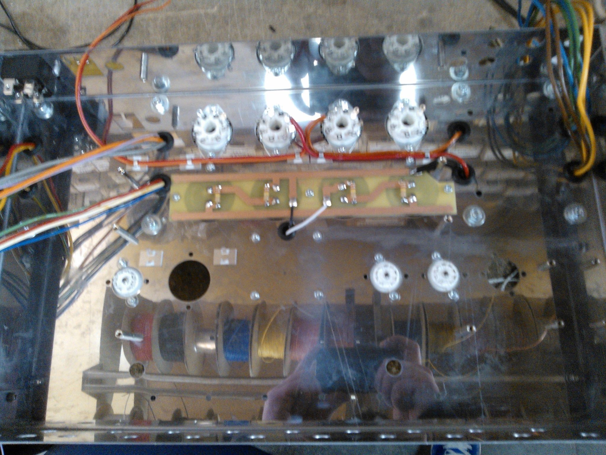

I have build one stereo amplifier which was based on 5-20. I however did two modifications to it. The EF86 was triode-connected and power supply was done with bridge rectifier instead of tube rectifier. After the rectifier I had CLC-filter (100uF/1.5H/100uF). C-filter would be sufficient, but I noticed some occasional motorboating with it and adding the 1.5H choke to the power supply solved that problem.

In replying I have the usual difficulty - one can suggest a number of small changes, each with its "claim-to-fame', until the OP is thoroughly befuddled.
Mine would be to rather replace the overrated ECC83 phase inverter with a lower-µ tube like ECC82 or rather better: 12BH7 (plus some resistor changes). Not to bore with a technical analysis, but there are distinct advantages in keeping a pentode as input tube and the ECC83 is a poor power tube driver. (I thus respecfully differ from the well-known Bayrith-adaptation.) NFB and gain can be re-computed appropriately. Any l.f. instability as Teemumm experienced temporarily, can be controlled far easier with e.g. the pentode screen bypass capacitor etc.
But as said: Choices/alternatives! The above my preference.
Further:
One can certainly build two monoblocks on one chassis. One can use a larger single power transformer to save cost. I prefer point-to-point wiring for tube amplifiers; more freedom for routing wires. It is neat to use component boards though.
Combining this with a pre-amp may require some experience to avoid interference. With a separate pre-amp it might also be more convenient to be able to place the (heavy) power amplifier 'out of the way' so to speak.
