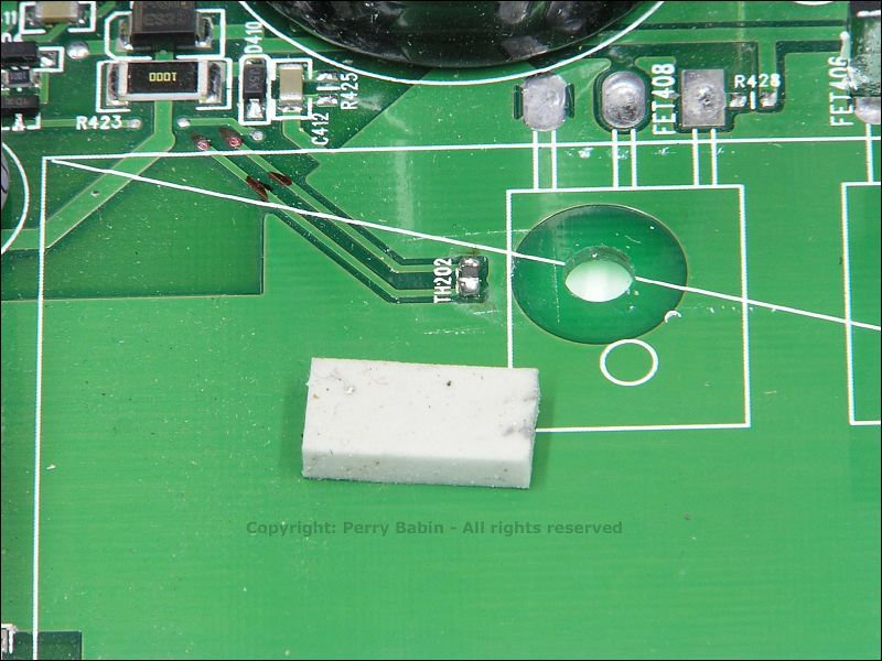

I never removed the heatsink but i did have the bars off both sides on the output end. I did notice the board flex about 1/4" away from the heatsink a few times when handling it. Is there a thermal sensor under there?
Yes. There's a soft thermal interface pad that needs to be placed between the thermistor and the heatsink. It's possible that it fell out of place when the heatsink was separated from the board. I think it's on the corner of the heatsink that's nearest the HCPL3120 opto-couplers. There are likely two diagonal traces that exit from that corner. I think that's where the thermistor is.
The attached photo shows the thermistor and the thermal pad (moved off of the thermistor so the thermistor would be visible). This is on a 7801 which should be similar to the amp you have.
Checked the thermal interface and it was okay but i moved it slightly to give it a new place to contact the sensor. Reassembled and it looks the same as before.
