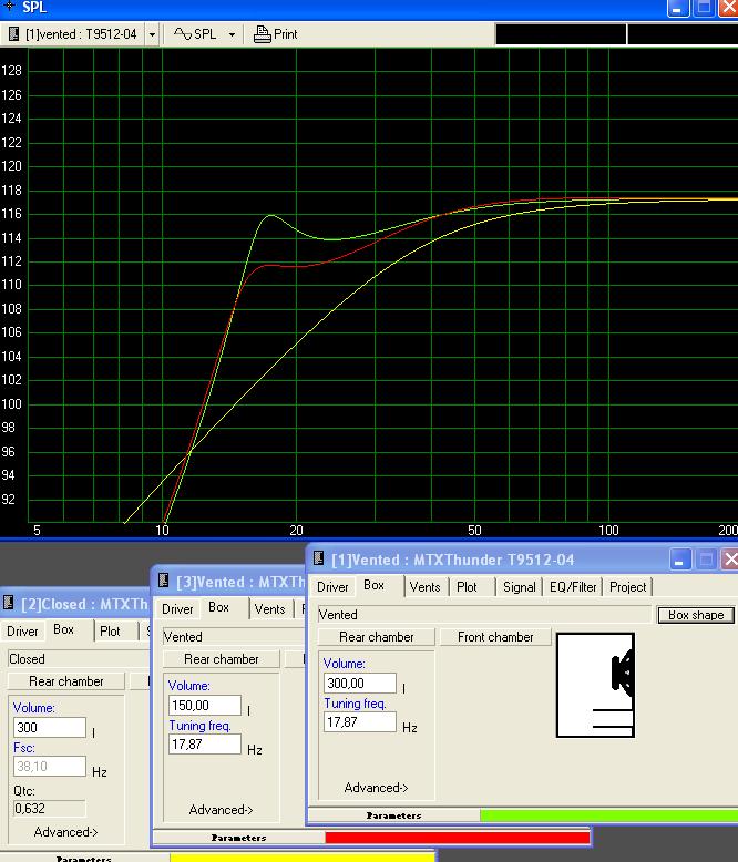

I was hoping that someone here could help me make it work.....I tried to put the info in WinISD but there were parameters missing and I didn't really know what I was doing cause I was figuring on about 4' of 24" sonosub, and I need to know how I need to set these subs up to make them perform in a home theater environment.
Hmm, well you didn't say that in your first post...
If you are using WinISD Pro then you could be right, there may not be enough info to come up with a valid design. However, there's enough to pump into WinISD Beta, and the calcs I got from the specs are:

You finally told me the woofer you plan on buying. Is this the woofer with the most excursion you can get at an acceptable price?
I'll model it in WinISD Pro, there's enough information on the link you gave me to model it.
One 24" diameter sonotube with 1.5" endcap on each end so the effective height is 45 inches long.
That means 334 liters, minus volume taken by the ports and drivers. Let say 300 liters to be sure.
Your sonotube is too big for two 12 inches drivers if you want to go vented IMHO. Let me show you the simulation.
In yellow, 2 woofers in a sealed 300 liters sonotube with 1000W RMS amplifier.
In red, 2 woofers in a vented 150 liters sonotube with 1000W RMS amplifier, tuned to 17.87 Hz.
In green, 2 woofers in a vented 300 liters sonotube with 1000W RMS amplifier, tuned to 17.87 Hz to use two common Precision Ports which are four inches diameter and 17 inches long.

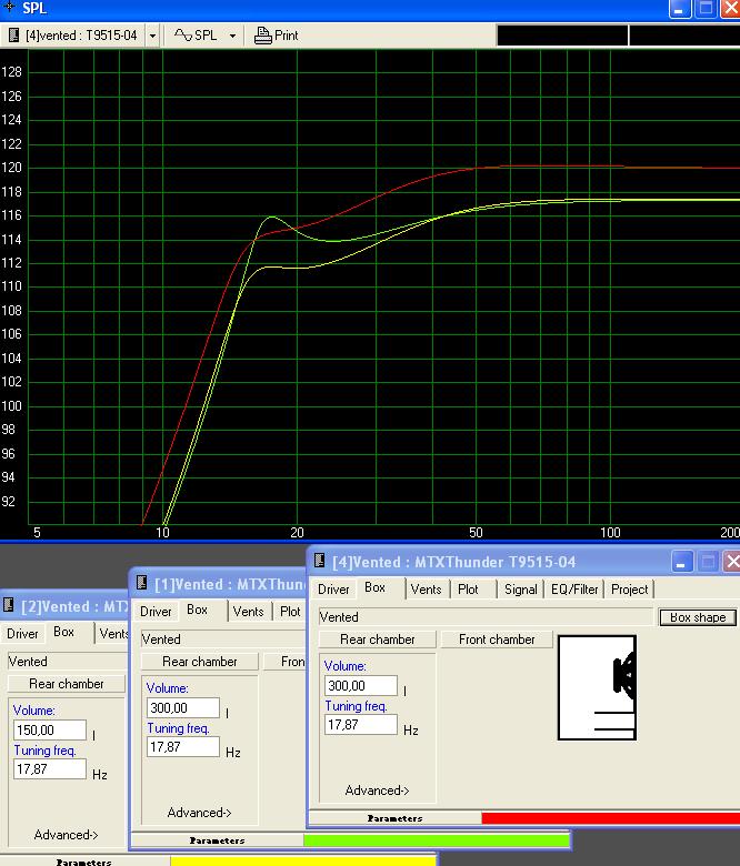

Because you can afford such a big sonotube, to use all the space, I recommend to use dual 15" like the Thunder 9500 T9515-04.
http://www.mtxaudio.com/caraudio/products/subwoofers/TechData_T9515-04.pdf
Here you can compare the SPL response curve which is way better. I used 1000W RMS, 17.87 Hz tuning and 300 liters.
In green, dual 12 inches woofers.
In red, dual 15 inches woofers.
In yellow, dual 12 inches woofers but in 150 liters to compare.
If you want to go sealed, then dual 12 inches or dual 15 inches will be great. I used 1000 Watts for fun, you can use less, or more, you can even use the full 2000 Watts RMS these woofers can take if you have a rumble filter on your amplifier.

WOW.....the curve on those 2 15" woofers looks pretty sweet. I think I have found my woofers....I'm gonna need a pretty darn big amp for these babies...any suggestions on bang for the buck? Also, what does it change that these subs are car subs and not HT subs? I know that probably a common question but I can find a satisfactory answer in my searches....thanks.
