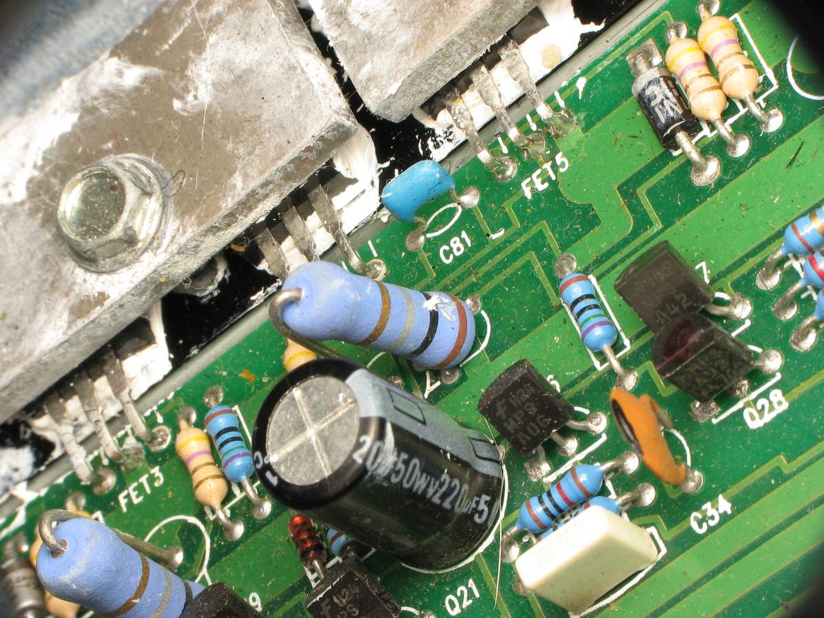

I’m looking for a pic of the resistor that sits in front of Fet 5 in the output section

Replaced power supply fets outputs and a few resistors .
Amp powers up and idles fine .
Amp is producing both rail and regulated voltages .
I get very low audio if I try to adjust the gain on the amp the test speaker just flutters like crazy back and fourth and the amp will start drawing excessive current . And the fan kicks on
Rca shield ground is intact .
Any ideas ?

No if I power the amp down and adjust the gain any and power it back up it will do the same thing make the speaker flutter and draw excessive current .
The gain has to be set all they way down in order for the amp to play audio and not make the test speaker bounce up and down

I guess I will have to fix the signal source .
I’m using a alpine head unit and from shield ground to case I get no reading

Thanks Perry for the help with this amp and going over the basics since I had no clue the shield ground inside the head unit was blown .
I fixed the broken trace and amp works perfect
