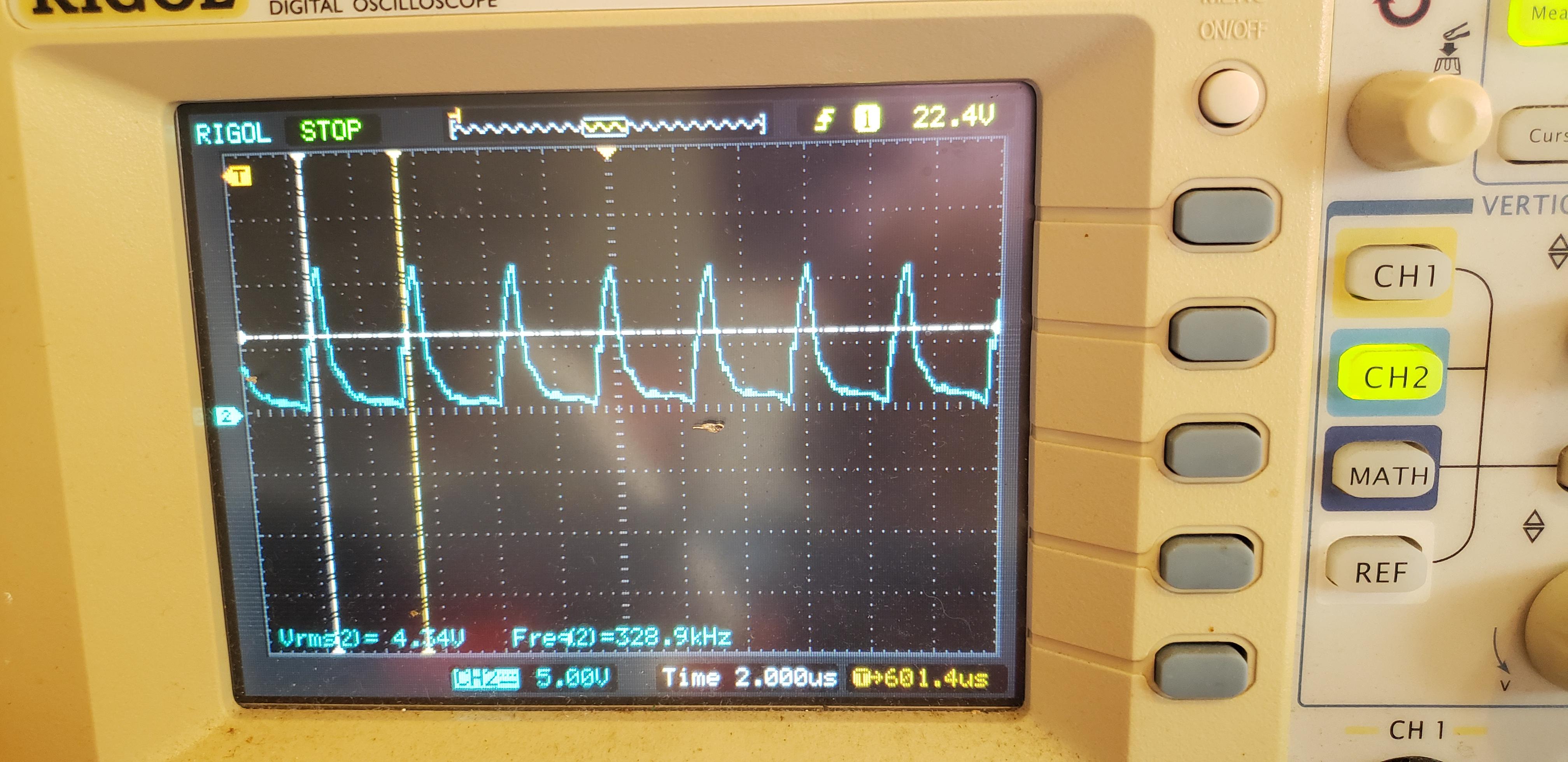

I imraneesa Member Joined 2016 2019-11-14 5:21 pm #1 2019-11-14 5:21 pm #1 Power supply gate waveform not good. Changed 3525 IC and still waveform is not good. Attaching the picture. Driver transistors are good and main rectifiers out of board. Attachments 20191114_131702.jpg 719.6 KB · Views: 64 P Perry Babin Member Joined 2003 bcae1.com 2019-11-14 5:31 pm #2 2019-11-14 5:31 pm #2 The frequency is too high. I imraneesa Member Joined 2016 2019-11-14 5:34 pm #3 2019-11-14 5:34 pm #3 Perry Babin said: The frequency is too high. Click to expand... What will cause that and how to decrease it. P Perry Babin Member Joined 2003 bcae1.com 2019-11-14 5:49 pm #4 2019-11-14 5:49 pm #4 The timing capacitor and resistor and possibly the deadtime resistor control the frequency. J jkrokenberger Member Joined 2018 2019-11-14 5:50 pm #5 2019-11-14 5:50 pm #5 Check Rt and Ct are in tolerance. I imraneesa Member Joined 2016 2019-11-14 6:02 pm #6 2019-11-14 6:02 pm #6 Yes It was the timing capacitor. Thank you. You must log in or register to reply here. Share: Facebook X (Twitter) LinkedIn Reddit Pinterest Tumblr WhatsApp Email Link
