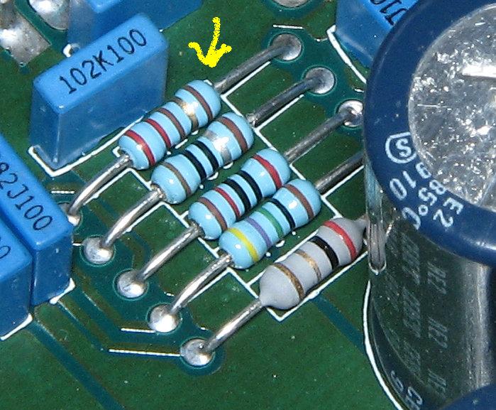

Im in the process of bringing this amp back to life. The modle i have is the 2300x Black heatsink with gold lettering.
I have a couple questions
Wondering what is a good power supply fet for this amp?? Since the fets are missing.
There is a resistor thats to burnt to tell the value wondering if anyone knows the value of R429 located in front of the rectifier.
And what transistor goes in Q220's spot since its missing

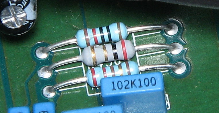

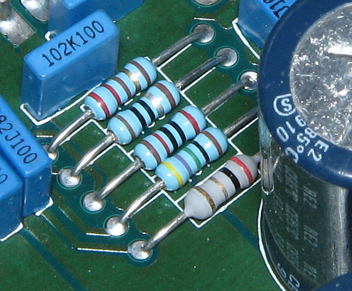

This is an image from an MTX Thunder 4320. Perhaps is close to what you are missing?
The resistor on mine is 2k ohms.
The resistor thats missing in mine is the 1 closet to the cap in the row with 4 resistors. It looks like a 22.1 ohm resistor from what i can see is this correct?
