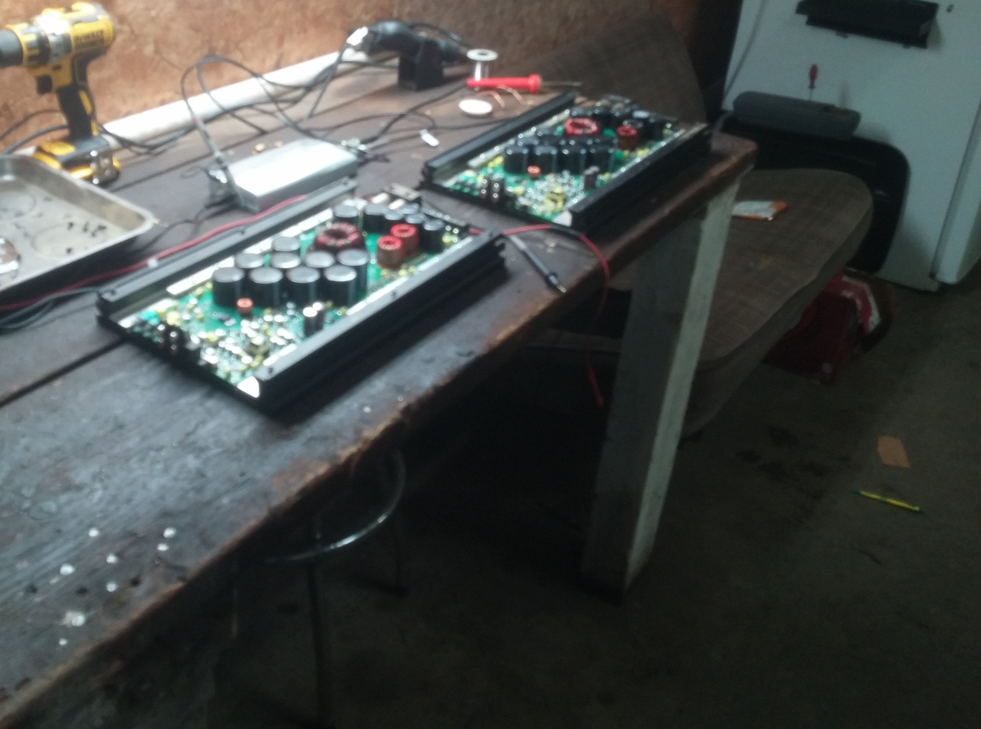

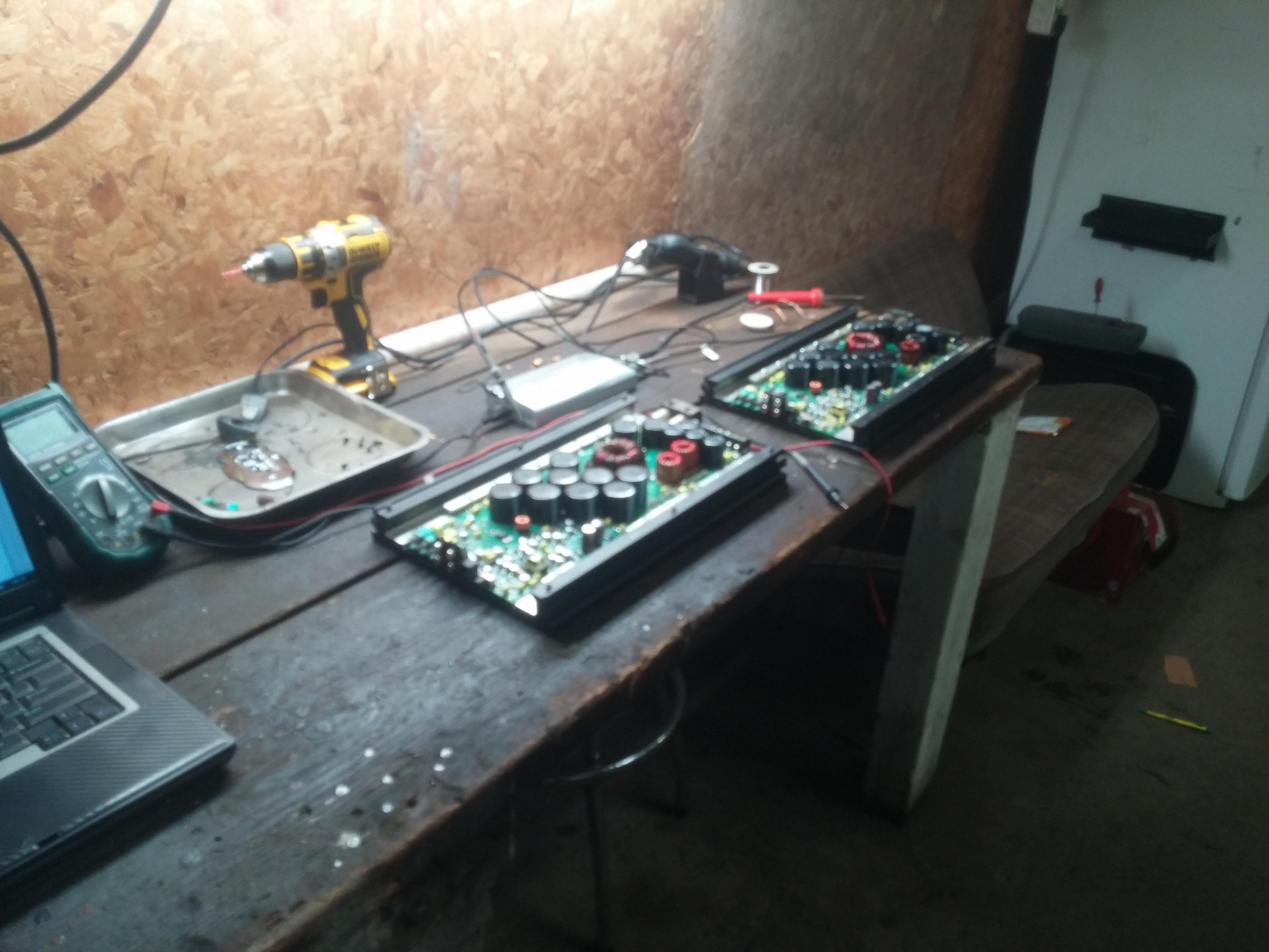

New to the site. Found this place while doing a little research on class D amp repair. Starting a project now with 2 MTX 1501D amps. I have 4 of these monsters but only 1 working right. Its been a few years but I did fix a couple of 502 thunder amps, back in my school days, about this era. Looks to be very similar at first glance.
Looks to be a few guys around here that have quite a bit of knowledge on my model so i thought id join, document my project a bit and hopefully contribute something useful for someone else, and maybe get a couple pointers to help along the way.
The first amp has a capacitor and transistor, (Q263) burned out. Powers up.
The 2nd amp has a transformer burnt, and D326 is burnt. No other apparent signs of damage. Does not power up. That one I was just running test tones to adjust balance with its twin when it went. It was running a 63Hz sine @ 40Vp-p with a 4 Ohm load for about 2-3 min. when it let go.

It's best not to have parallel repairs in a single thread. Let's use this thread for the one with Q263 blown. Start a new thread for the one with the burned output filter inductor.
What do you need to know about the one with Q263 burned?
OK lets focus on amp #1.

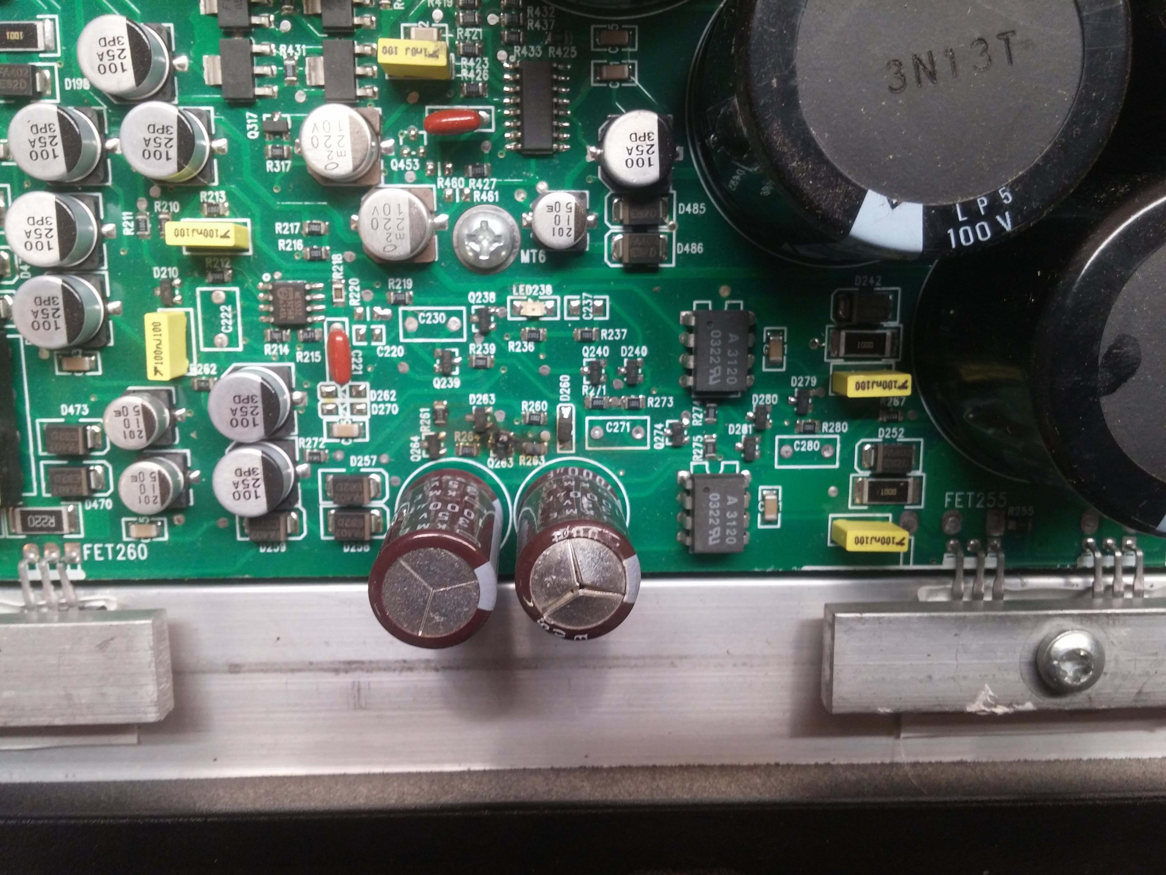

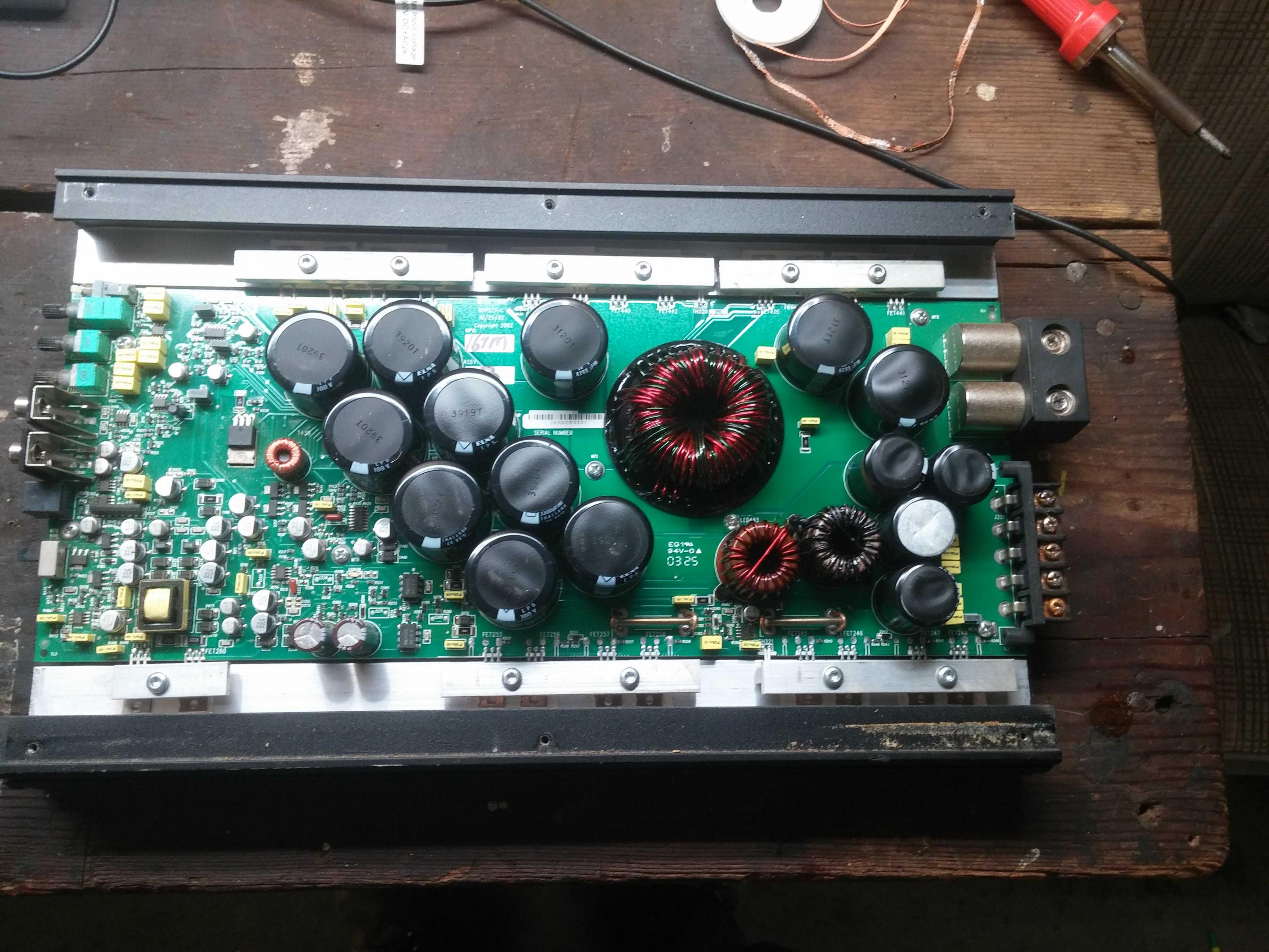

I replaced Q263, R263, D260, and the 35V 1000uF towards the right.

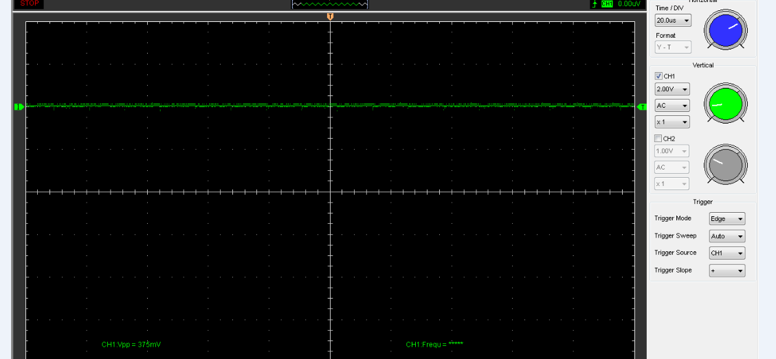

Re-clamped and powered up. Output on the O-Scope tied to output had a few small voltage spikes and returned to near zero, after a couple of seconds LED238 lite up, the power supply whine quieted down and then the 1000uF capacitor blew again. The 2 ICs marked 3120 (Opto couplers?) seemed cool yet along with all the FETs.
Upon another visual inspection there seems to be no other damage.
What is there to know about this area of the amp. Do you know the function of that capacitor?

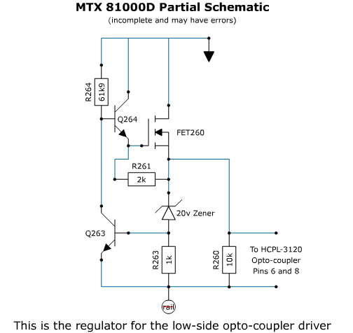

The area around Q263 and FET260 near the small transformer are the regulator for the opto-coupler near the edge of the board. If the cap is failing, check FET260.
If the voltage on the capacitor (C250?) was high enough to cause it to fail, the opto-coupler has likely been damaged.
Until you get everything (that you know to be defective) working, I'd suggest jumping the capacitor shown in the attached photo. It will disable the output stage.
If you have a high-voltage capacitor (value not important, 0.1uF or greater, 100v or greater), install it in place of the failing capacitor until you get the regulator repaired.

Checked out FET260. The gate and drain leads were very weak and broke when I used solder wick on it. Very low resistance from source to drain, but 28 ohm from source or drain to gate. Cant seem to trigger it off. I installed different FET, 50V capacitor, and different opto coupler.
Upon power up LED238 did not power on, Q263 blew again and there is right at 74VDC across the power supply on U250/ Optocoupler.
It looks like U250 directly drives FET255-258. These FETs must operate off the "rail voltage" provided by the large toroid transformer and the 8 75339 FETs
Not sure where to go from here. Wonder what that little transformer is there for.

Attached is a schematic for the regulator. All components have to be intact/within tolerance or the regulator will not work.

Replaced Q264, Q263, D263, D260. Everything seems to check out with the DMM in that area now.
Not sure what D263 does but I had 85 ohm across R264 until i replaced it. Now it measures ~60K Ohm. My working amp reads ~78K Ohm. Maybe on to something here?
I removed FET260 all together. Now i have 50VDC on the opto-coupler power supply. Its a head scratcher yet.

The safest place to measure the rail voltage is at the rectifiers.
In the regulator circuit, the voltage on the gate of the FET is pulled up until the Zener begins to conduct. When the Zener conducts, it turns Q263 on which turns Q264 off and that limits the voltage on the source leg of the FET from going any higher.

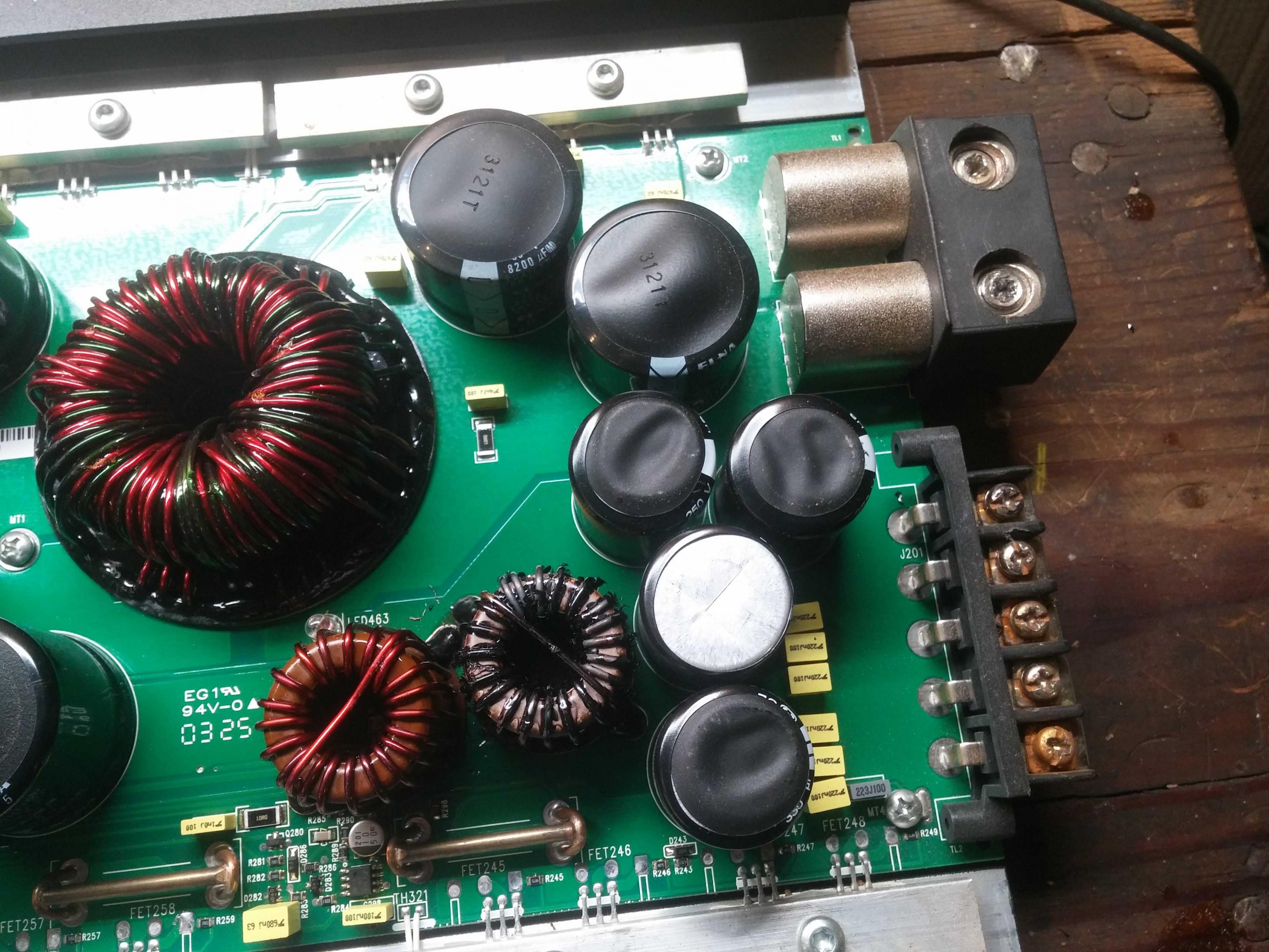

My second amp blew the FET just below D326 and R328. You have any info or know what its function is on that circuit? Looks like it took D326 with it again. I think that its a Zener. Ill have to power up my other unit again and see whats going on there. Its soldered to the PCB for a head sink so my head gun is going to have a workout on that one.

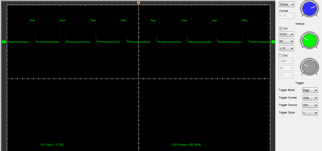

It looks like U201 is supposed to send a modulated square wave to the optocouplers but there is nothing on this amp?
When I first put it back on the bench there was a nice square wave coming into the optocouper set. I was double checking DC power to the couplers when it made a pop sound on the speaker I had connected. LEDs went out due to current surge. I am certain it did not have a slip of the probe? It still has 20VDC on U250, but U240 is running ~17.5VDC now and was right at 20VDC before it popped.

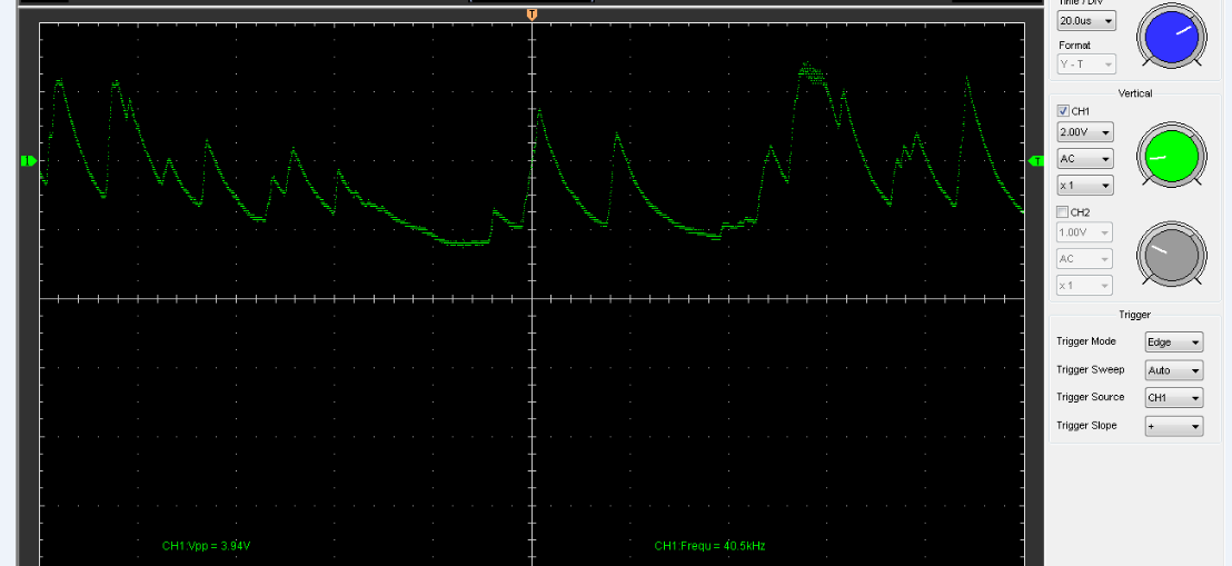

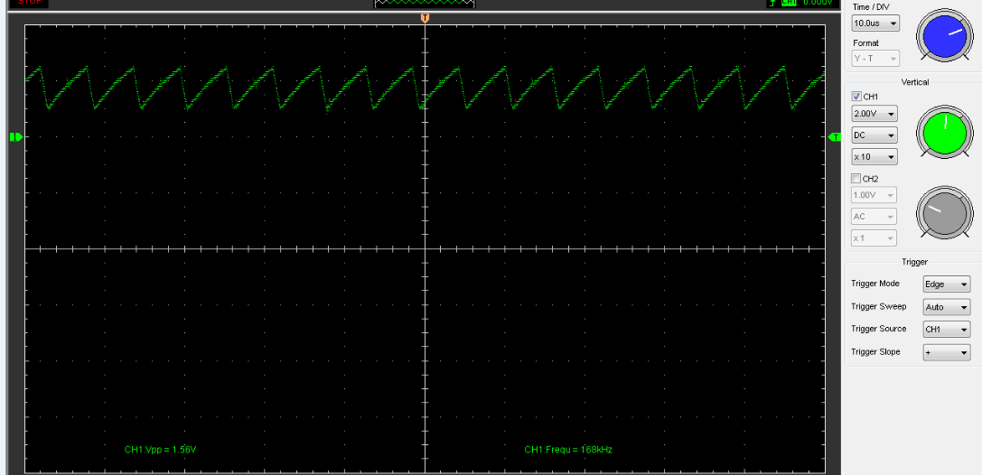

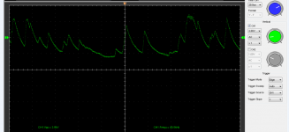

I checked out U450 and FET260 again. Attached screenshots from O-scope.
There is 78VDC across the output terminals now. LED238 stays lit as long as there is no load on the output. Output FETs do not seem to be warming up at all at idle.
