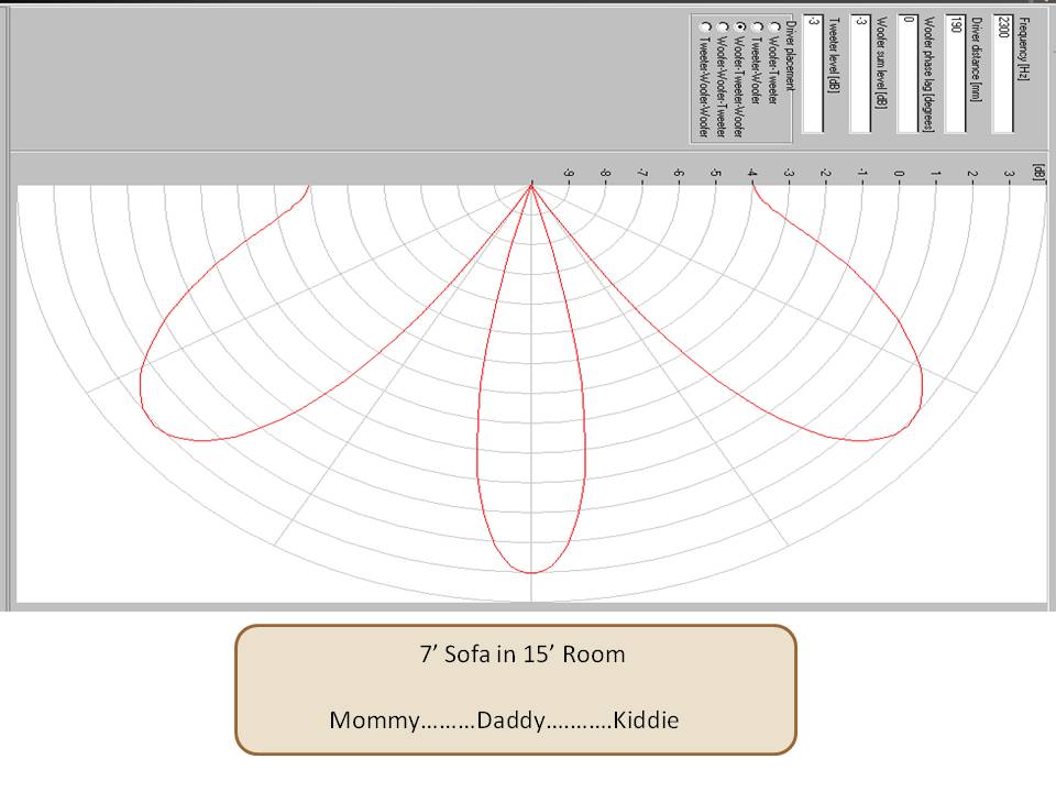

What you should do is to lay the MTM horizontal with the ribbon arrayed vertical between the two mids. Space the drivers as close as you can get them. Thus you have greatly reduced the spacing between the two mids while reducing the spacing between the mids and tweeter. Cross over at 2300 Hz or lower if you can with likely a 4th order acoustical crossover.

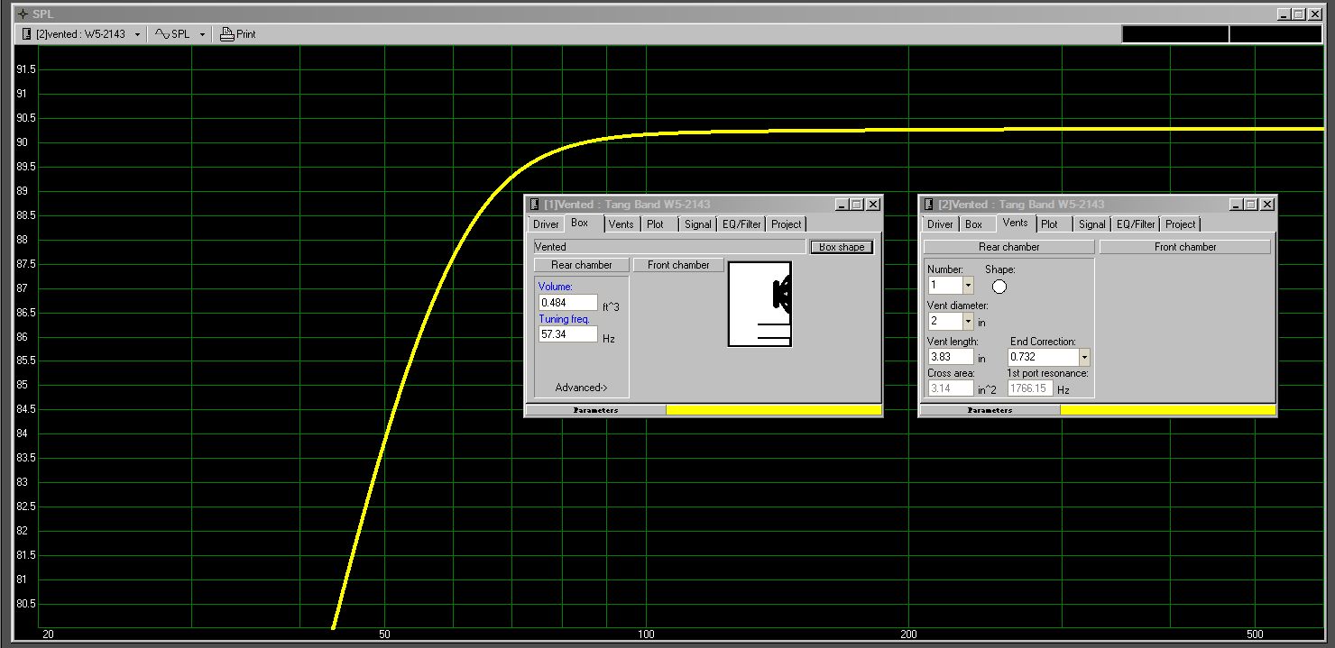

At 90db/W, the 5" Tang Band W5-2143 is a $52 full range worth your review for a 2,300Hz crossover frequency to a ribbon tweeter. W5-2143 has an underhung motor, very low Le, and a phase plug for some high frequency smoothing help. Mms =6g using Bamboo fiber and paper cone with santoprene surround. Good reviews.
Part of the G3 face plate can overlap the W5 frame to meet the 12" height restriction.
F3= 57Hz in a 0.5cuft ported box. One 2" diameter port, 3.8" long

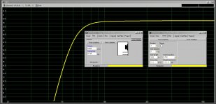

A 2-minute Xdir horizontal_MTM sim of the W8+G3+W8 crudely illustrates the horizontal comb filtering which can change the soundstage and SPL for listeners over modestly spaced seated positions.
