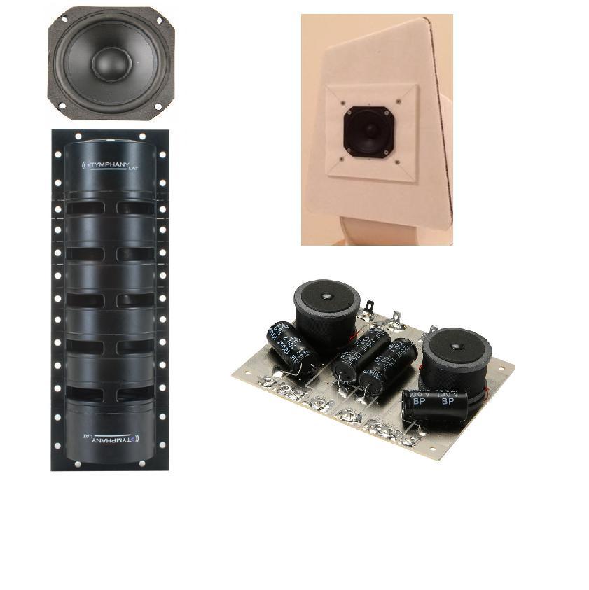

Hey Anyone,
This thread is for an easy, inexpensive open baffle design. That has NO scientific mathematical model. I want to assemble it from some parts I already have and one I need to buy. It is an open baffle mini speaker. The woofer is a Tymphany LAT 250 bass driver. The upper frequencies will be handled by a Vifa TC9FD 3 1/2" full range driver. The Vifa will be mounted on a trapezoidal baffle like the one pictured. (Just because it looks cool.) The crossover will be a Parts Express subwoofer crossover. Its an 8 ohm crossover at 150hz. (I would probably upgrade the caps in the crossover.) The LAT has two 4 ohm voice coils on either end of the assembly. I intend to run the LAT voice coils in series out of phase with each other. One pushes the other pulls. OR pad the woofer to match the low efficiency of the full range and raise its impedance.
Any thoughts?

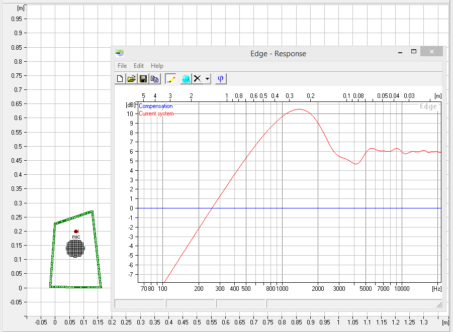

Cool looking or not, this speaker design (as stated) has a serious flaw. Because of the response from the open baffle, the higher frequencies will be something like 6+dB louder than the upper bass with a peak around 1kHz and then a roll off below that at 6dB/oct. This assumes that the driver has infinite low extension, so any droop from the driver itself needs to be added on top of the baffle response.
Adding the woofer below 150 Hz won't really make up for the response hole that you will have between 200Hz and 800Hz (about 3 octaves). Unless you can cut the peak at 1kHz and correct for the drooping response of the OB you will not get very accurate sound from this speaker. This can certainly be done, but you will need more circuitry than the crossover that you mentioned.
I simulated the response you will get if the TC9 is mounted in the baffle shape you pictured and attached it for reference.

There is a relationship between the baffle response and the largest dimension (width/height) of an open baffle that controls where the "peak" in the response is located and where the response starts to fall off (below the peak). Larger baffles move the peak lower and smaller ones move it higher. When smaller drivers are put on larger baffles the first peak can become a series of two or more peaks (with troughs in between) that have decreasing amplitude as the frequency increases. You can read more about this topic here. A related phenomenon happens for closed/ported boxes and is called the "baffle step".
Basically, there isn't much that can be done about this - it's due to the physics of the open baffle front and rear wave interacting with each other. You have to work with what you get and plan the crossover, and use other drivers in the system, to get a flat response. This is why open baffle systems often use more drivers that you can get away with using a closed box or even a TL type system. As a result, the crossover is also more complicated.

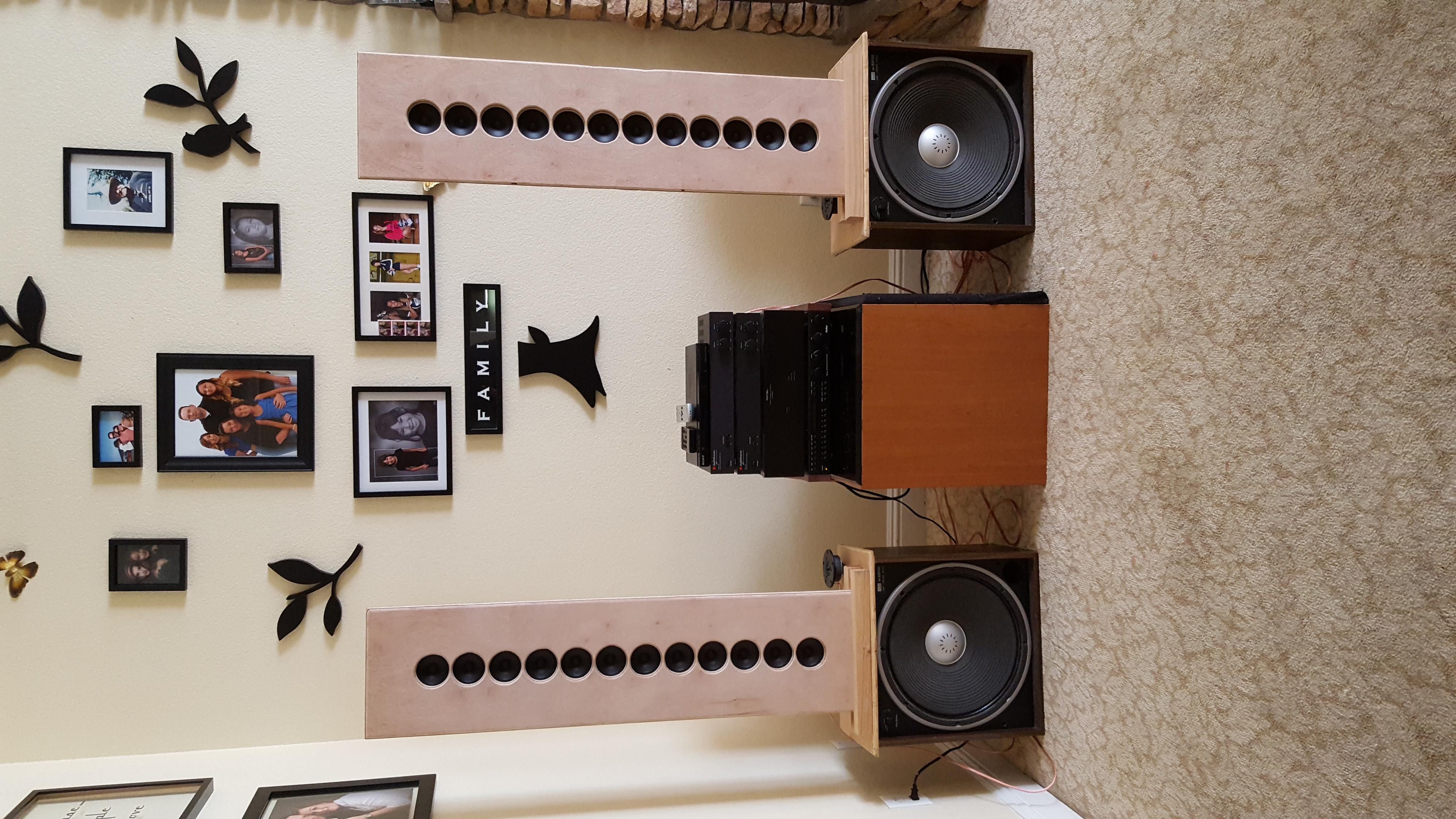

On the topic of the TC9 on open baffle, what about 2 or more per side on open baffle to offset the dipole loss and baffle step? Or in a 1.5 arrangement? They're cheap enough that multiples could easily be used...
It's working pretty well for me even without any dsp. I perceive extension down to about 150hz. I'm using a rear firing vifa xt25 to fill out the top octave. Some dsp will elevate the results substantially I believe. This was only an experiment to see if was worth the effort to build 25 per side. I'm gonna need the dsp before I make that decision though.
